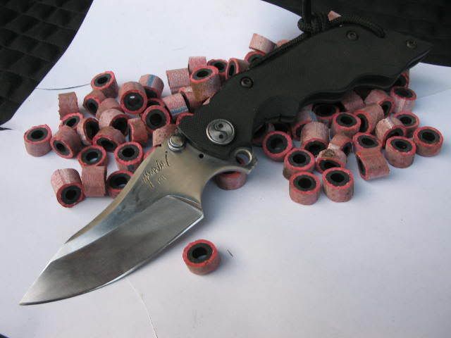

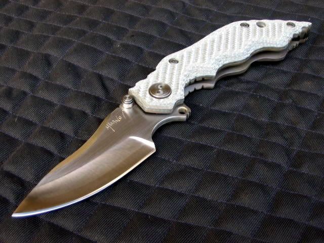

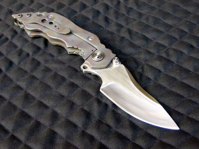

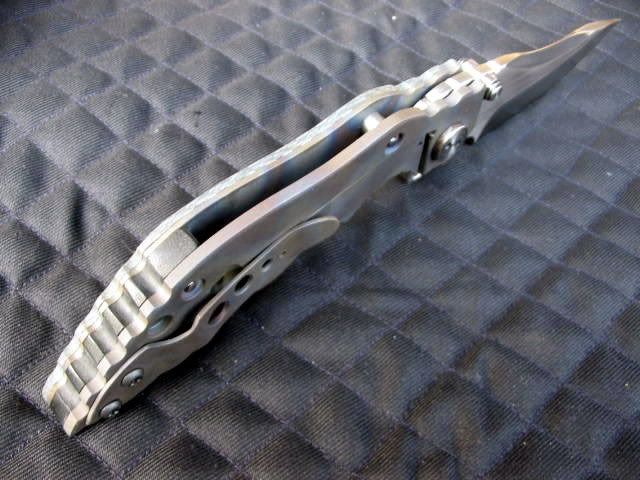

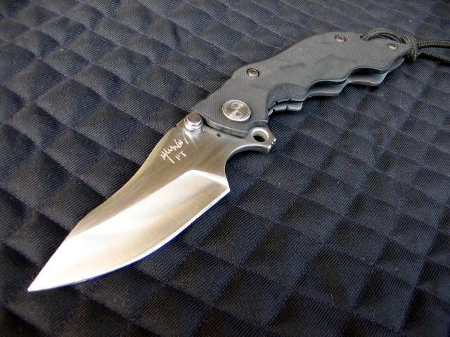

Today I have time to test my knives, HARD1. the spec of this knife is :
Blade steel - ZDP-189/ATS-34 laminated steel, 4 mm. thickness. 64 Rc. hardness.
Heat treatment - Double temper&Sub- Zero quenched
Blade length - 4" ( tip to flipper ),hand rubbed satin finished 1 3/16" widest
Handle - Black G10, 5" length and widest 1 1/2"
Lock system - 6AL 4V titanium flame lock 1/8" thickness and Thumber stop
Flame and clip - 6AL 4V titanium
Pivot screw - Hardened 440C
Thumb stud - Hardened SUH 3, this steel is valve steel in diesel engine

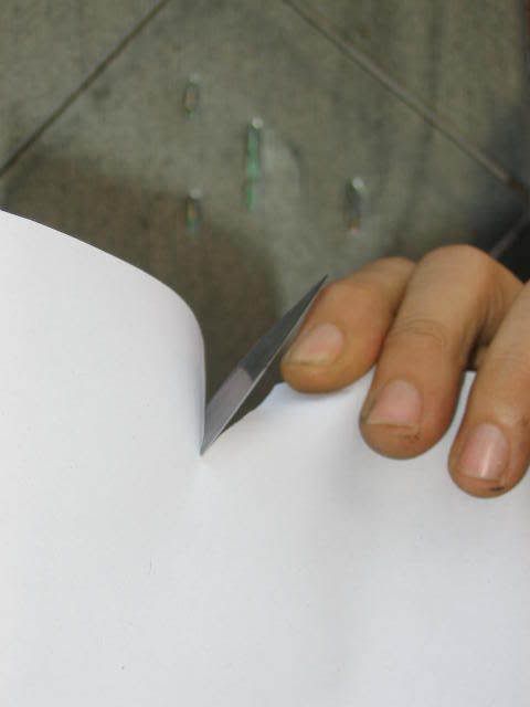

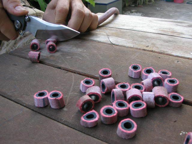

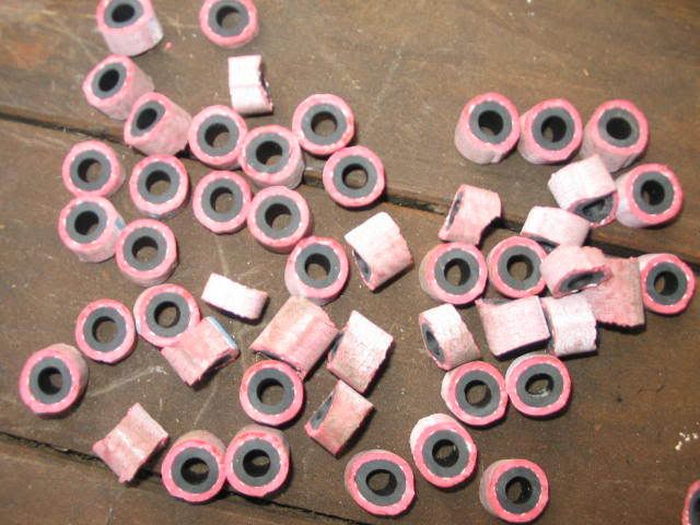

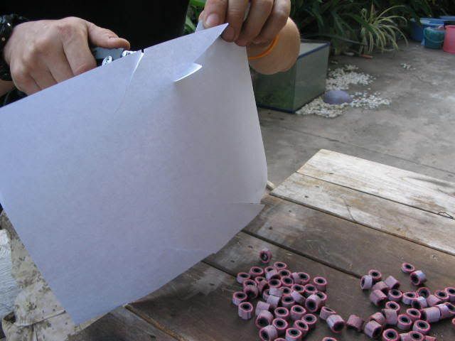

1. I cut the paper to insist it's scary sharp!

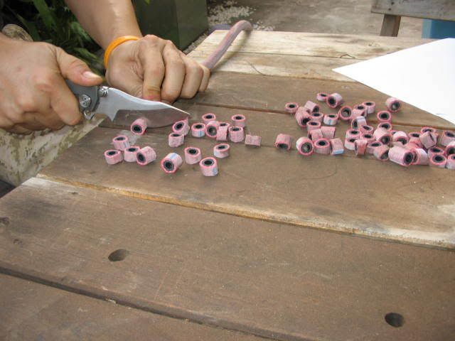

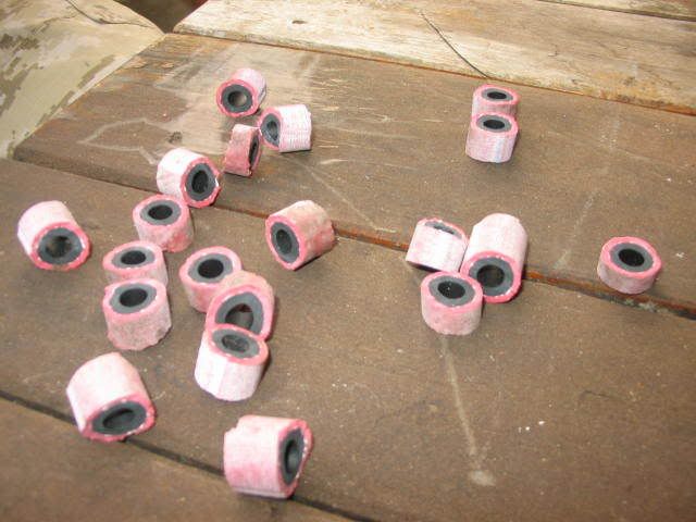

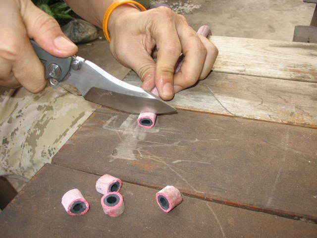

2.Gas force rubber tube cutting. I cut to 20 cuts.
3. I cut the paper again.
4. Go to cut the rubber to 50 cuts.
5. Cut the paper again.
