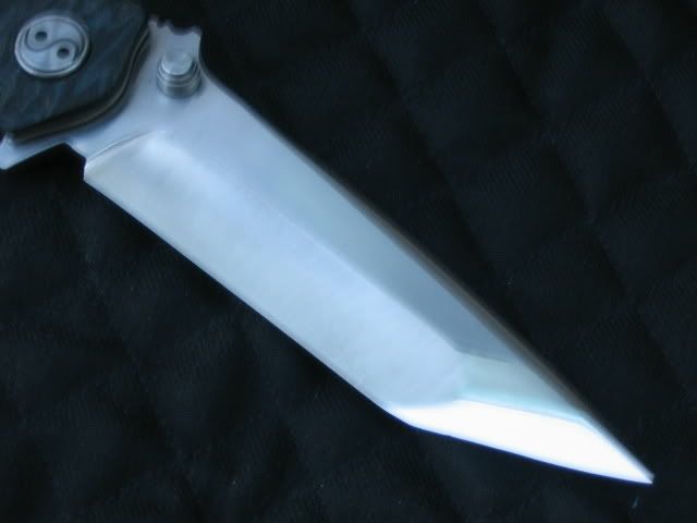

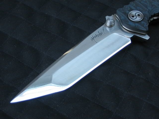

Hi all,
Just finished in last week, the spec is;
Blade length - 4 " (Satin finished ) and 1/8" thickness.
Opened length - 9 "
Blade steel - ATS-34, 61 Rc.
Grinding - Complex grind, hollow on belly and chisel edge, convex and zero edge on tip.
Handle mat. - Textured black/blue G10
Locking system - Liner and very solid
Liner&Spacer - Sand blast 6Al 4V titanium
Pivot - Hardened 440c in Ying-Yang style.
Washer - Teflon ( Smooth opened )
Thumbstud - SUH3 Dual thumbstud
Clip - Heattreated 6AL 4V titanium
Thanks for looking and comments.
