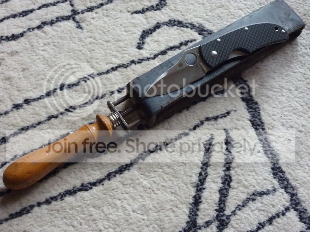

I have been thinking of getting a strop for a while. This would be a good excuse. Would a full 8" double sided paddle strop be best or could I get away with a 6" single sided hand strop? The portability of the smaller one is attractive.
I got a 6" bought on a garage sale. (It's very old one... which has been cut by the previous owner who did not use it propely...)
It's not really a paddle. there is a loop of leather and a long screw for the tension and a wood handle.
I even strop my machette with it (OK just for fun and in this case the strop goes to the blade and not the blade goes to the paddle...)...;)
It's even only 5 inches of leather...
