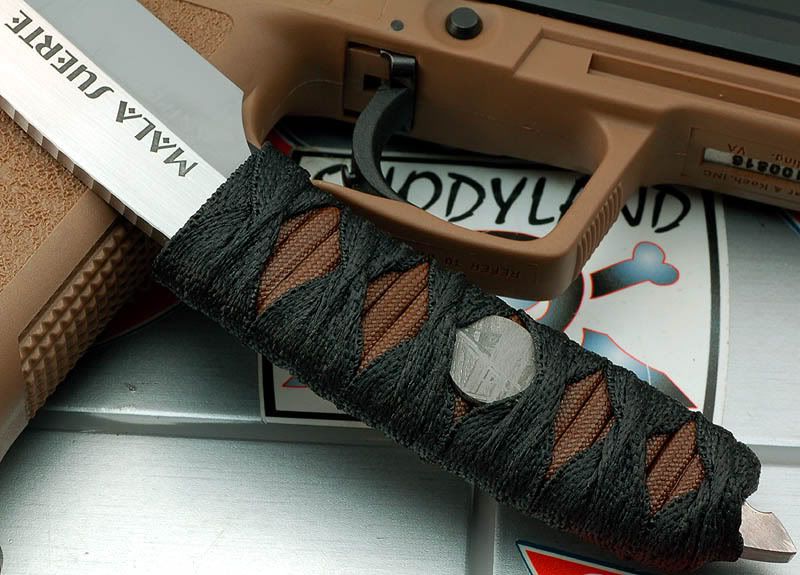

Hey Guys,
Here are a few more I finished up yesterday.
Thanks for looking!

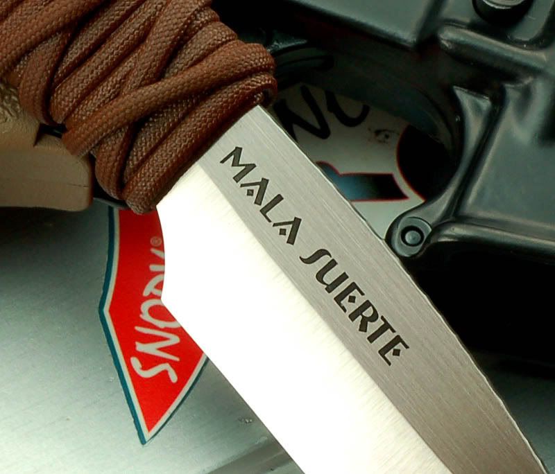

Here are a few Zero Grinds.
Here are a few more pictures.

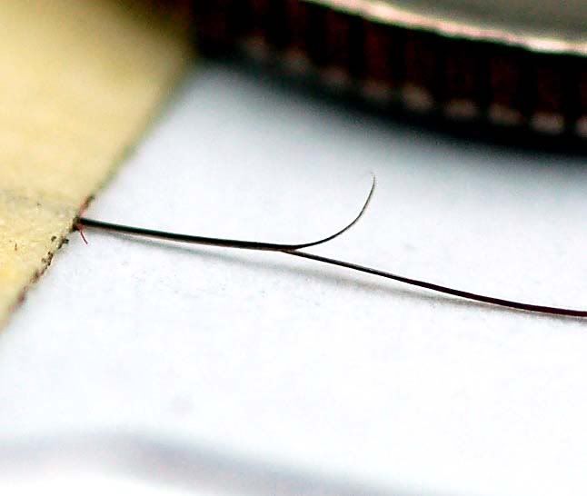

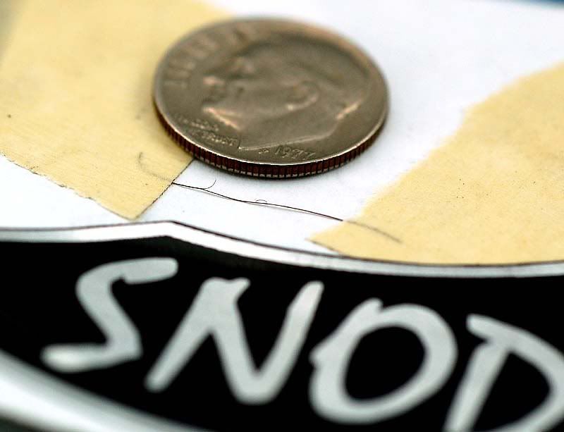

I was to able to split a hair lengthwise with one of their new knives and let them view the results under magnification.
