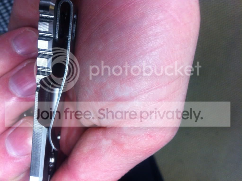

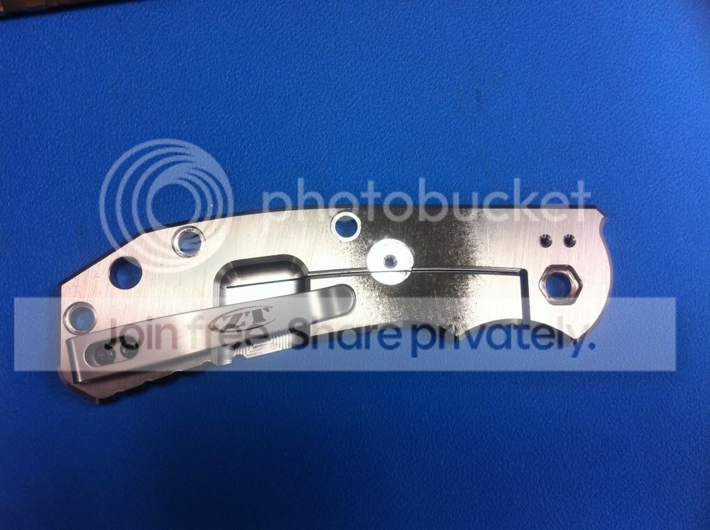

So more like this?
You get this to buckle...dang not sure what could cause this under folder usage. My opinion is the 0560 should be classified with a 03XX.
Thomas, is that a new variant or an earlier, abandoned design? The deep-carry clip and laser-cut lock bar would suggest it's an upcoming model. Looks real good. I like the finish, too. Would love to see that make it to production.

Oh,it looked like the 0550 because it has the same round lanyard hole.The current 0560 has a oval lanyard hole.
It could be the scale before 3d machining?
