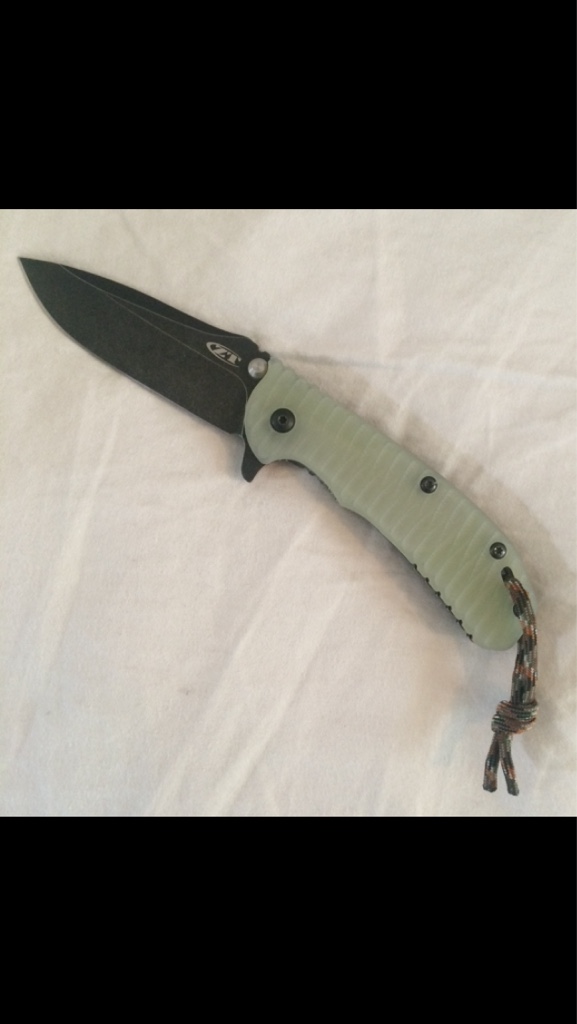

So I had bought a ZT 0350 and just didn't really like it much. Just too big for me. I really wanted to go with ZT, so I did some research and came up with the 0566. I received it in the mail today and I must say... This knife just feels great in the hand. Its a really good size and its thin. I ended up going with the blackwash G-10 version... was gonna go Carbon Fiber, but I knew I would probably be swapping scales before long, so I thought I'd save a little bit of money and just go with the G-10.

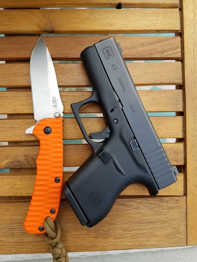

I have the 0566 and I put the orange Allen Putman scales on mine. Looks awesome. I would leave the spring in and give it a chance to work it's self in. It will get smoother. The key to the assisted flipper is to press from the base of the flipper, if that makes since. If you put your finger right on the tip of the flipper, it is much more difficult.

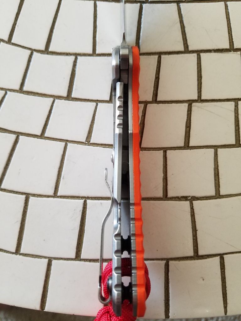

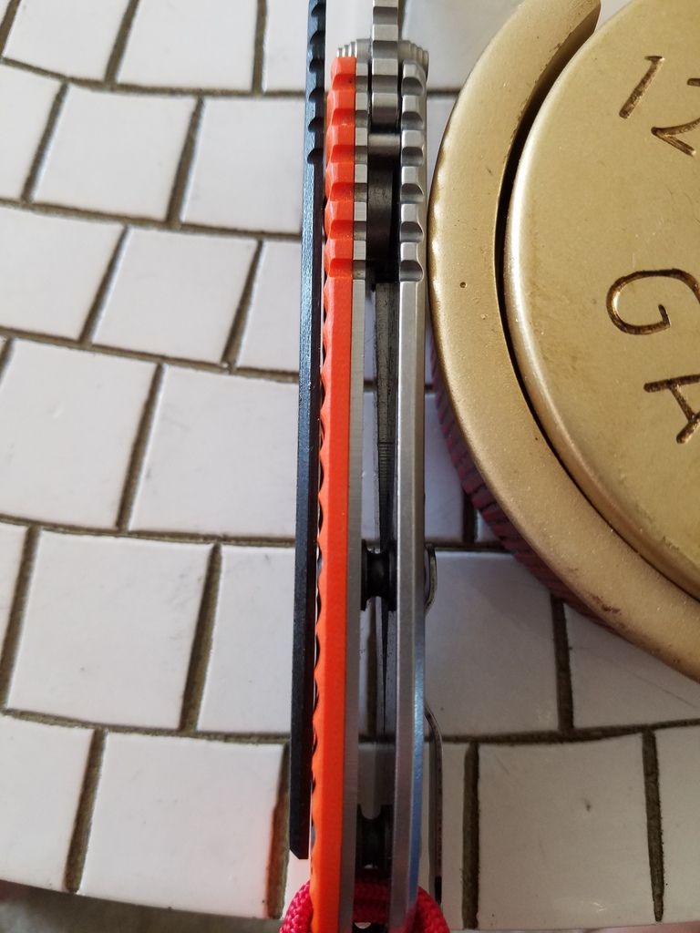

Unitethe7-The Putman scales are really no thicker than the G10 that comes on them. Nothing to worry about there:thumbup:
I just took these pics for you. I hope it's helpful.

The Putman scale is not much thicker, if any over the stock G10.
