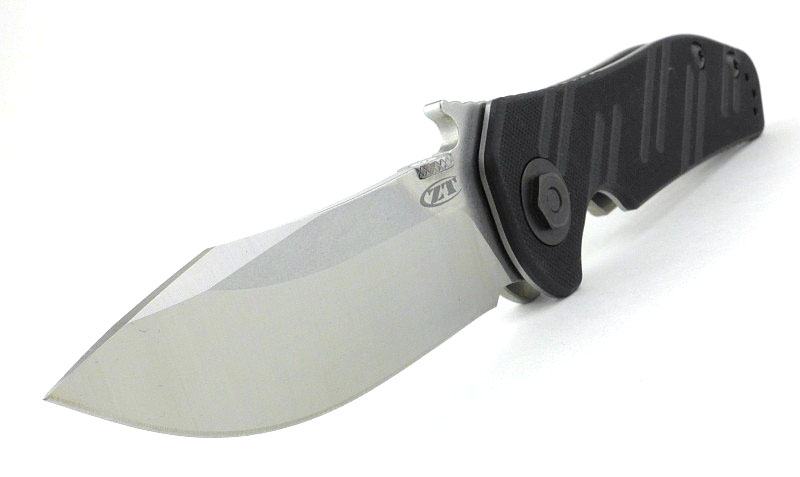

The ZT (Zero Tolerance) 0630 is a collaboration between ZT and Ernest Emerson, and naturally features the patented Emerson "wave shaped feature" that makes it one of the fastest deploying folding knives in the world.
With a strong upswept S35VN tactical blade the 0630 is powerfully over-built for hard-use.

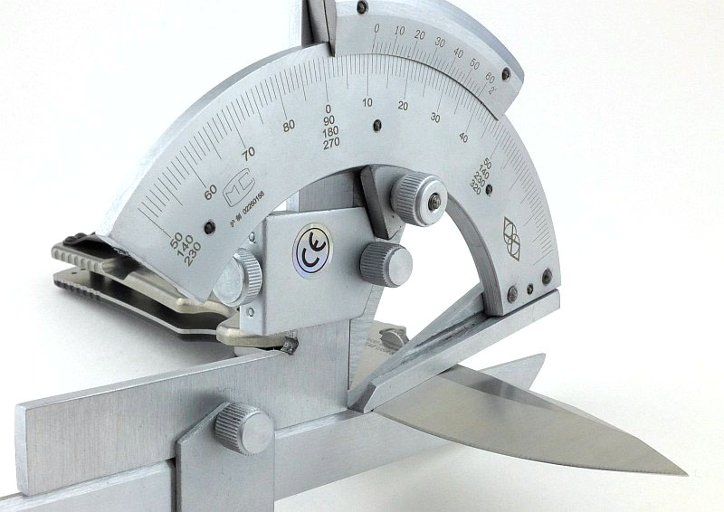

Most knife specifications have a basic description of the blade geometry, but in this section I will be taking a more detailed look at geometry and balance.
Using a set of gauges and precision measuring equipment including a Vernier protractor, callipers, fixed radius gauges and the unique Arc Master adjustable radius gauge (the one that looks like a crossbow).
These measurements have been tabulated and are presented along with a few reference blades (8" Chef's Knife, 5.5" Santoku and the popular Fällkniven F1).
Key aspects such as the primary bevel angle, grind type, blade depth, blade thickness, length, weight are detailed, along with balance information.
The 'Balance relative to the front of the handle' tells you if the knife will feel front heavy, or if the weight is in your hand (a positive value means the weight is forward of the front of the handle). The 'Balance relative to the centre of the handle' indicates how close to a 'neutral balance' the knife has in the hand.
In the case of full convex grinds the approximate centre of the grind is used for the primary bevel angle estimate.

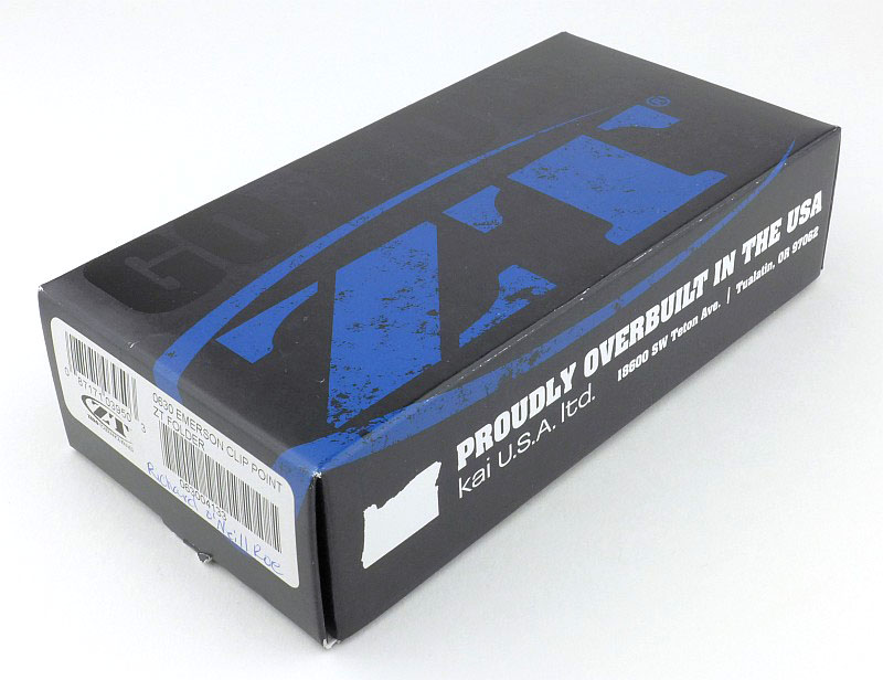

The 0630 comes in a cardboard box.

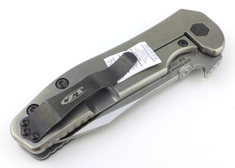

Tucked under the pocket clip is a silica gel packet.

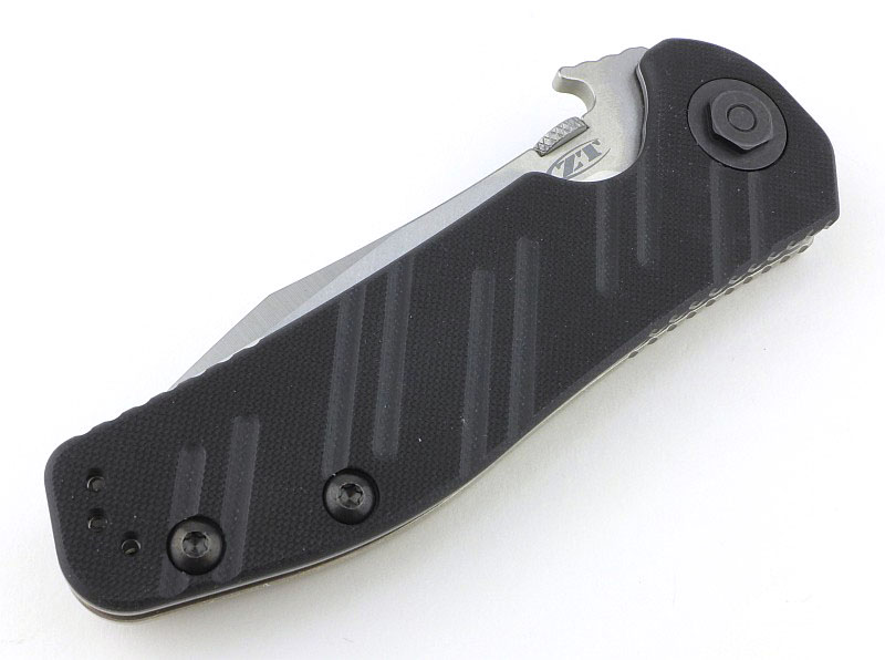

On the other handle is a peeled G-10 scale with milled grip grooves.

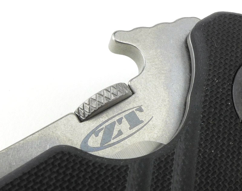

Rather than a stud, the 0630 has a thumb-disc for manual opening of the blade.

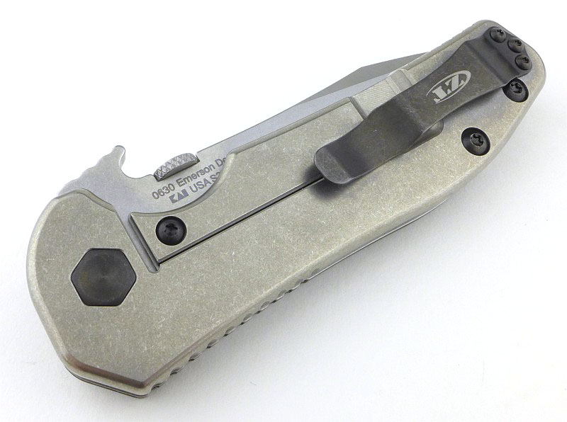

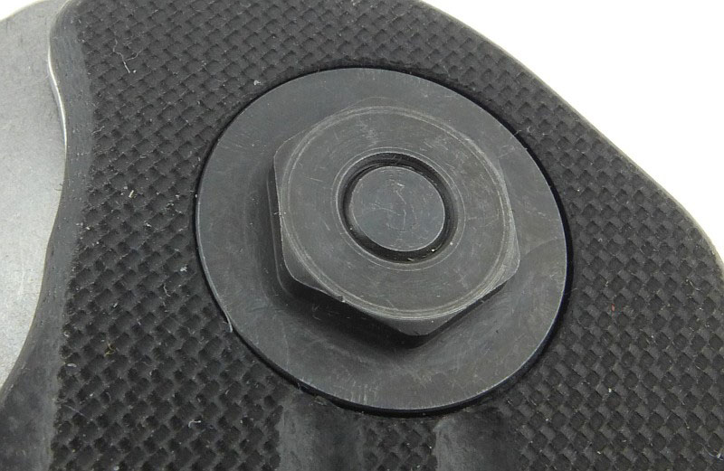

Matching the heavy no-nonsense design of this knife, there is a substantial pivot nut which can be adjusted with a standard spanner; no special tools required).
By default, the pocket clip is fitted to the framelock side of the knife which suits a right-handed owner. However the 0630 comes drilled and tapped for the pocket clip to be moved to the G-10 side for a left-handed owner.
The titanium framelock has a pleasing stonewashed finish.
At the base of the lock-bar cutout is a rounded corner to reduce stresses.
All round the Titanium slab, the corners are nicely radiused ensuring there are no sharp edges to cut into your hand.
With its wide design, the pocket clip has a strong grip. This is important when used on the Titanium side as the smooth titanium does not grab the pocket fabric as much as the G-10 side.

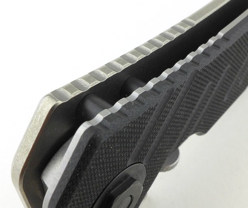

Key areas of the handle have jimping to help with grip.

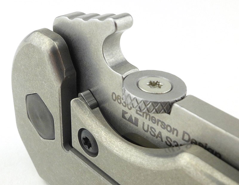

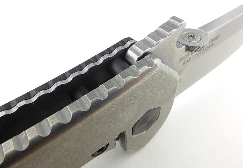

Further jimping in the thumb ramp area of the grip. This actually extends up onto the 'wave' as we will see.
There is jimping on the top of the 'wave' which is a natural extension of the jimping on the frame.
With the blade open, you can now see that flow of the jimping from handle to wave.
