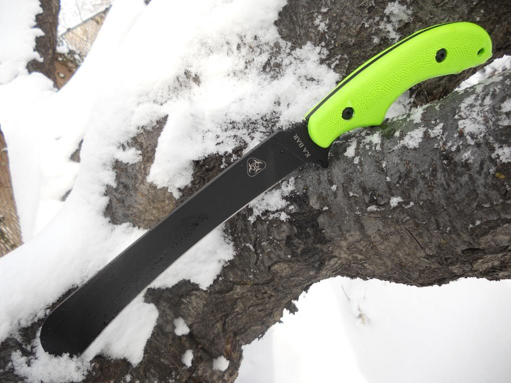

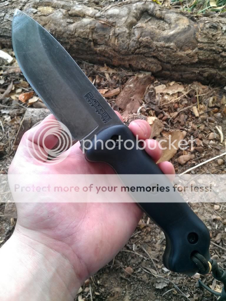

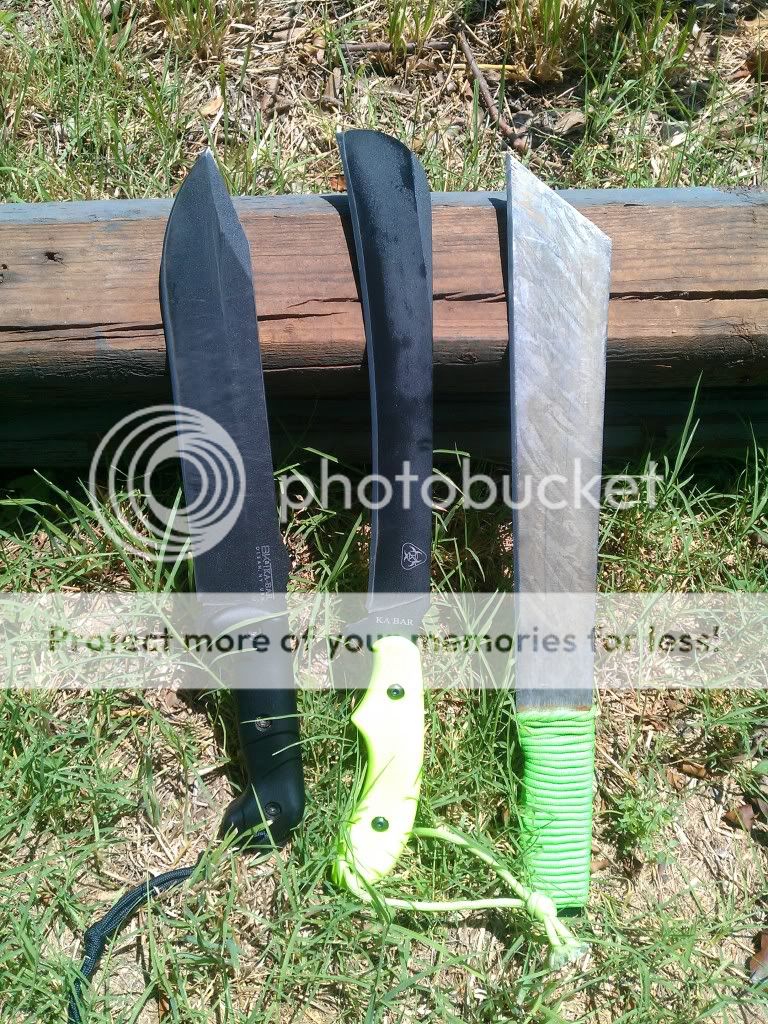

Well... Sort of a chop off... more of short little chopping comparison between some blades. The ZK Pestilence is SK5, The BK9, and a Short light Pack Machete of my creation just for the heck of it.
Here are the competitors....

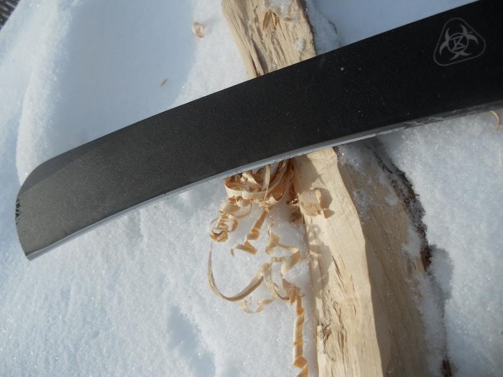

This was also an experiment with a new edge I just put on the ZK. It came with a very obtuse V grind that was not conducive to chopping and slicing. It was more blunt force trauma than anything. So I spent a little time last night on the stones and put a thin convex on the whole shabang. Leaving a little more meat around the sweet spot for stability.

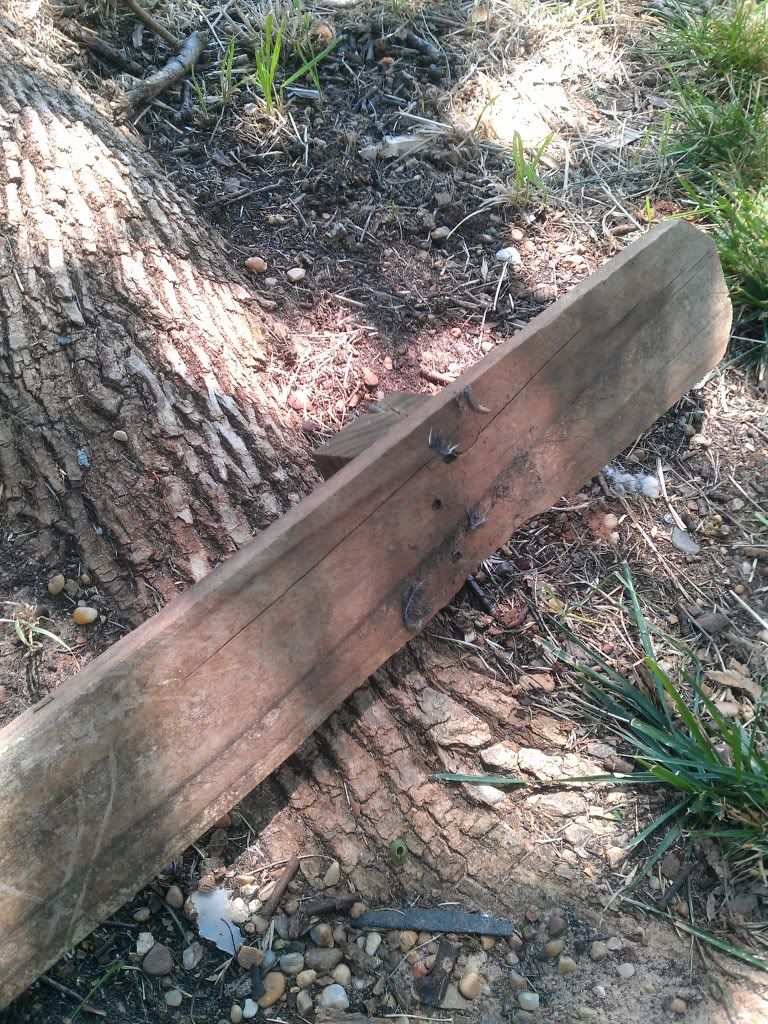

Here is the chopping material... an old fence picket that needs to go away... Figured it would be hard/concise enough to serve as a good comparison.

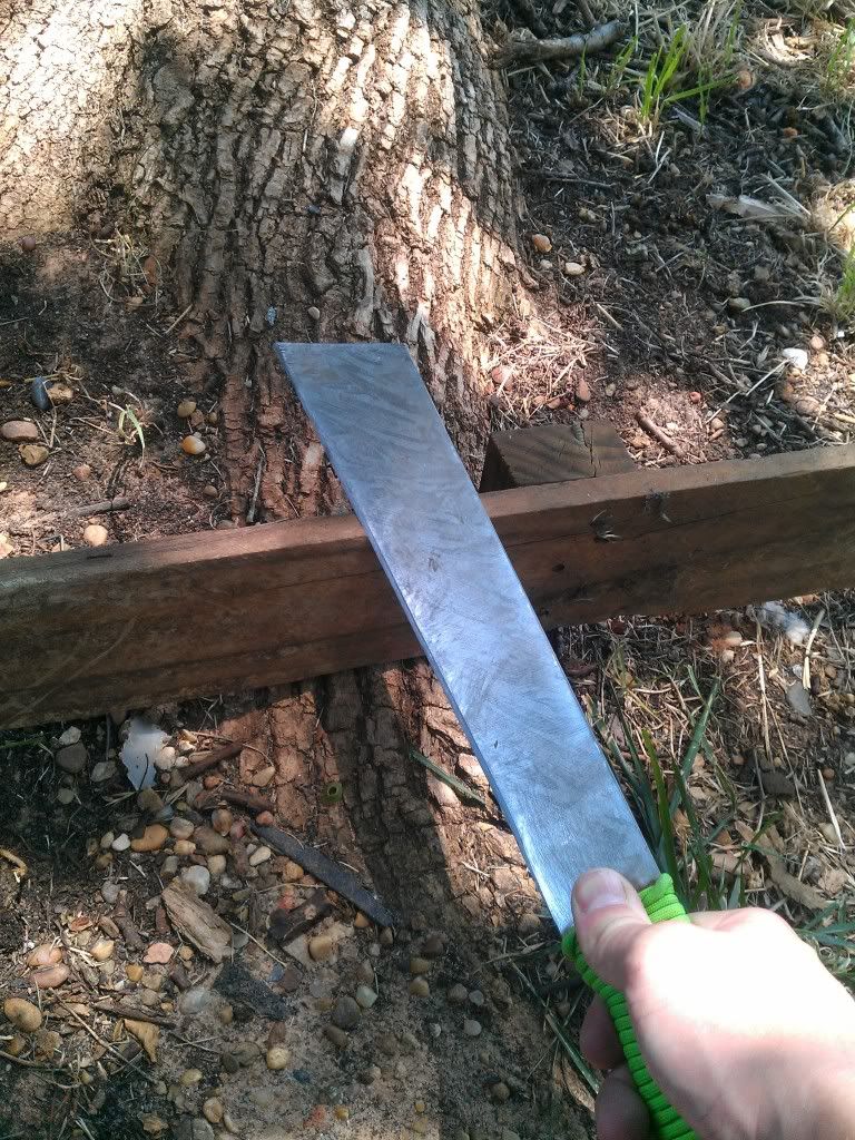

Chops will be done while on the knees in a short hammer grip. Pretty much testing the blades, not testing how hard I can swing it. Also a limit of 20 swings per blade.

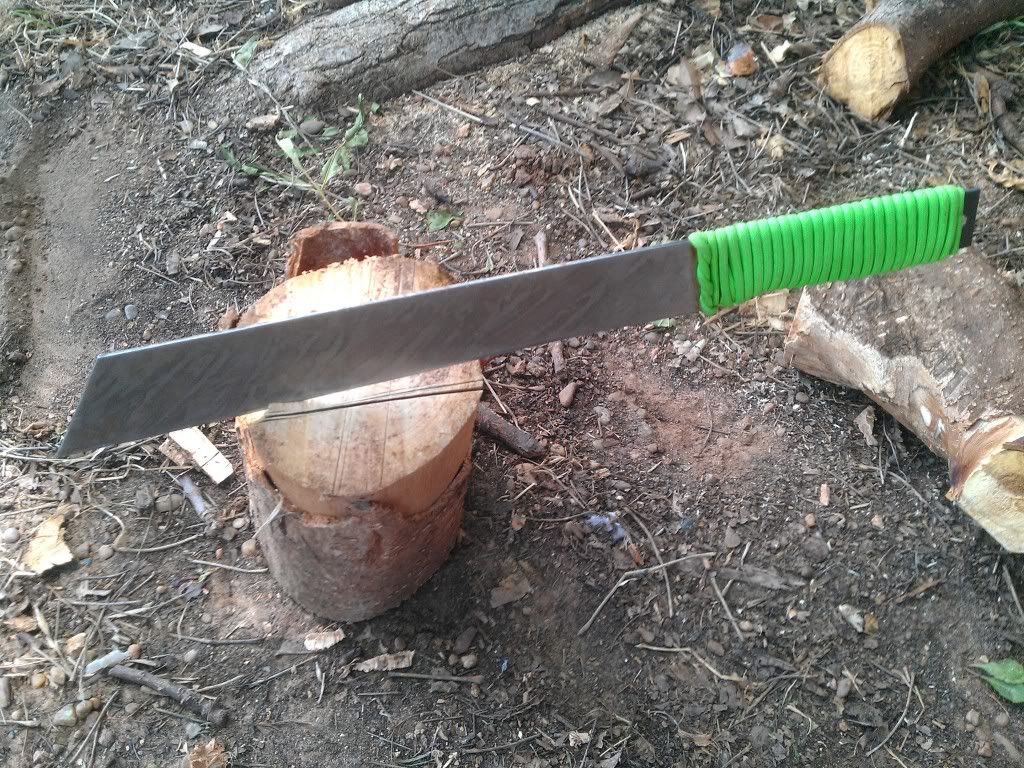

First up the light machete as a control if you will.
Twenty wacks... not very good. The edge is what I would call green wood sharp, or machete sharp.
Ok ZK's Turn... Heres to hoping the edge mod works well...

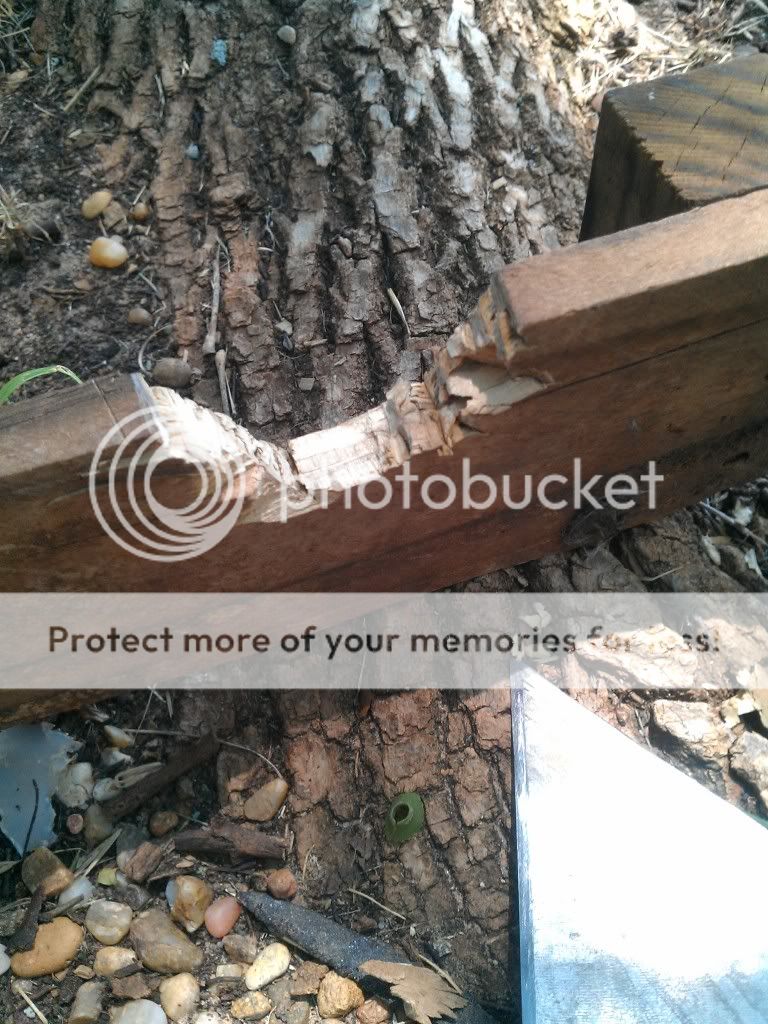

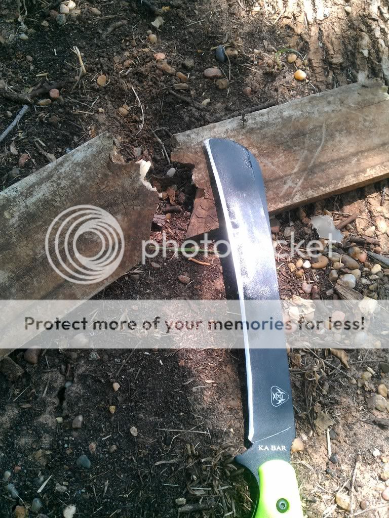

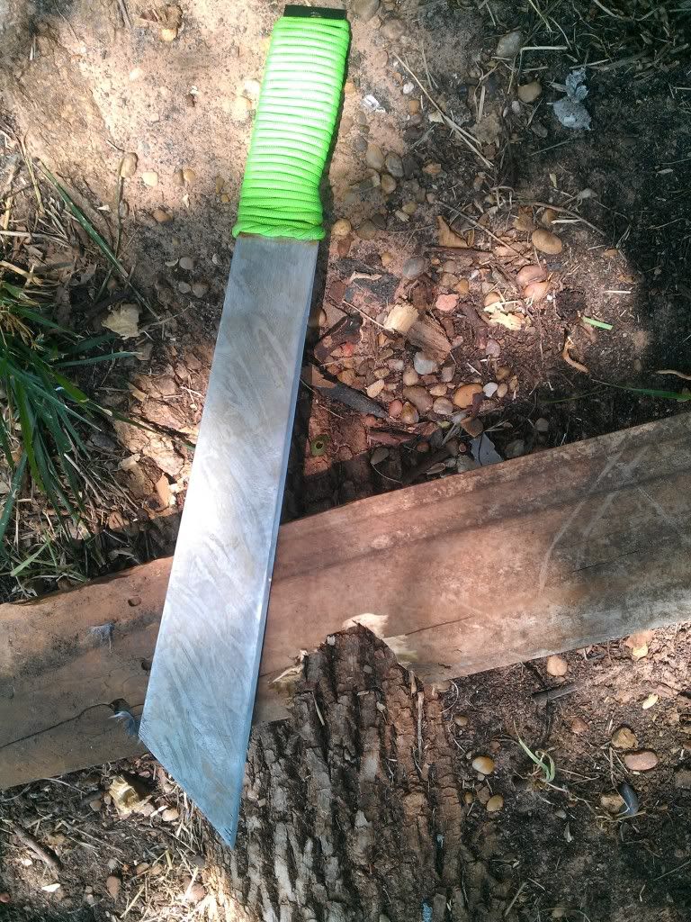

Ok 2 hacks in and the board broke... maybe this medium was not a good choice... o well NO TURNING BACK...
Second trys a charm... 20 wacks precisely... all the way through... The edge worked perfectly cannot be happier with how it turned out...

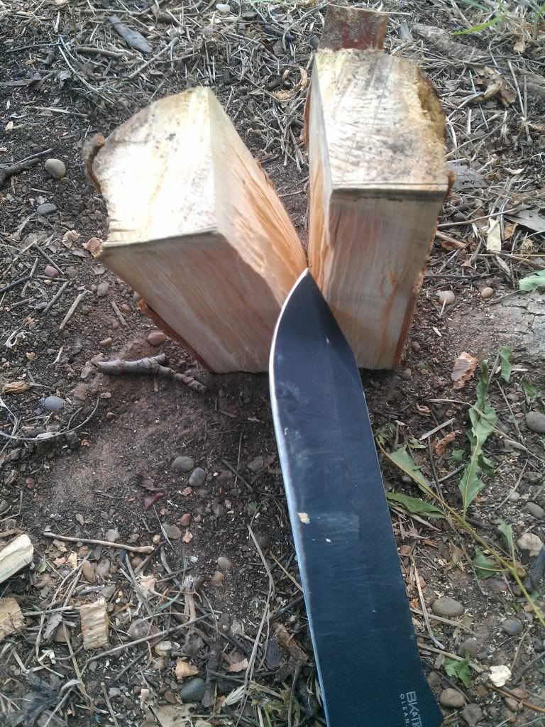

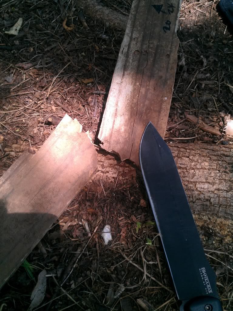

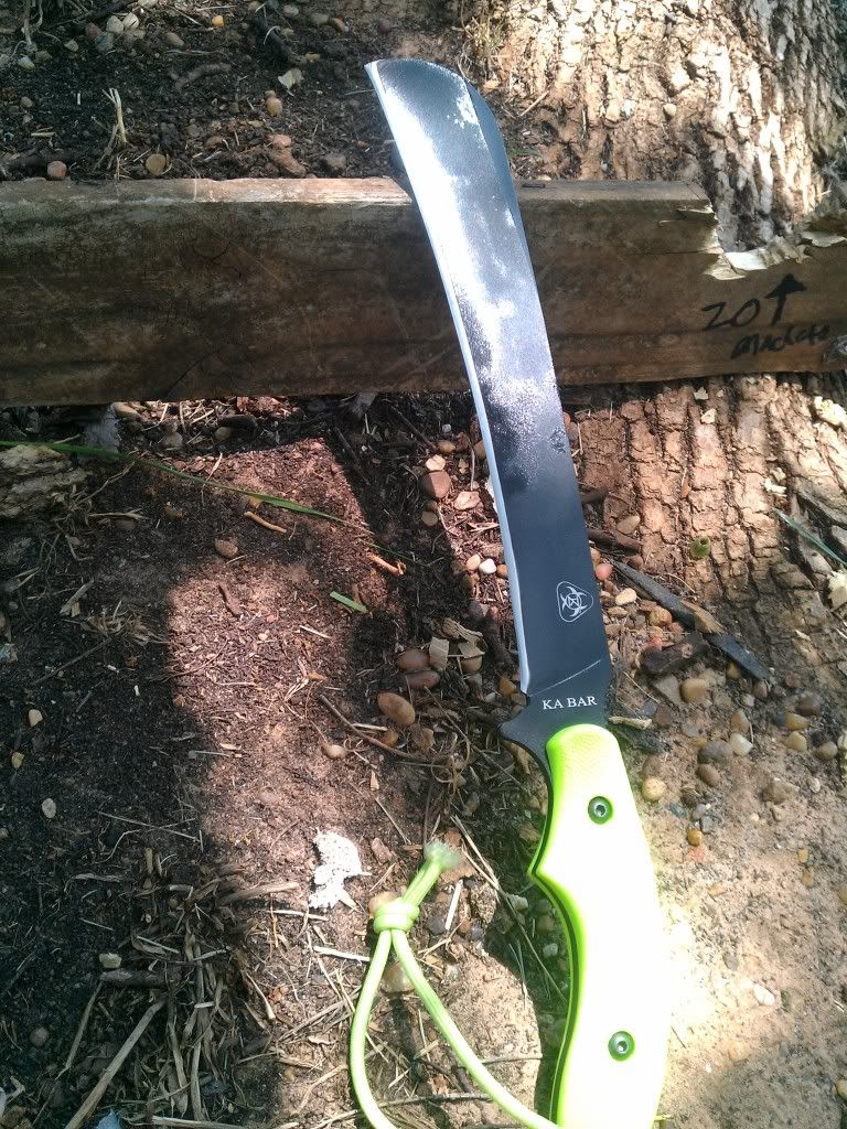

Next up Mr. BK9...

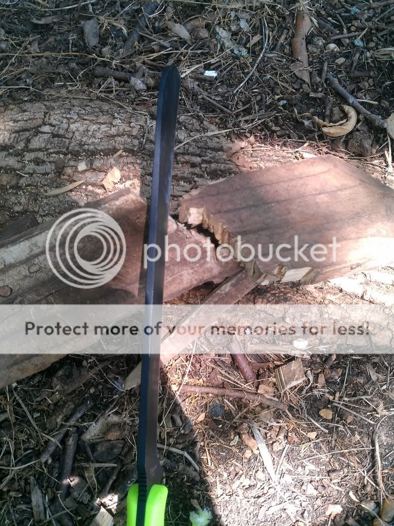

2 wacks and a broken board.... still... no regrets...

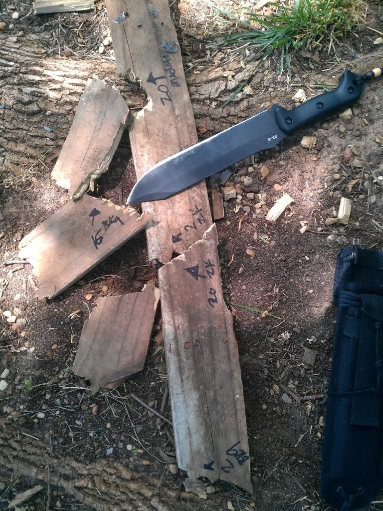

BK9 in 16 wacks... Awesome... here is the overall...

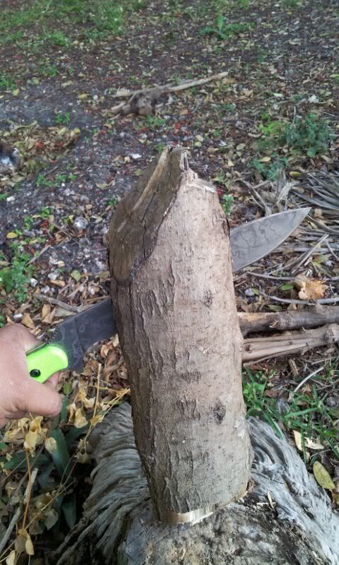

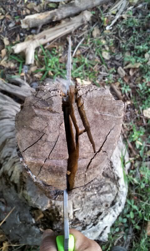

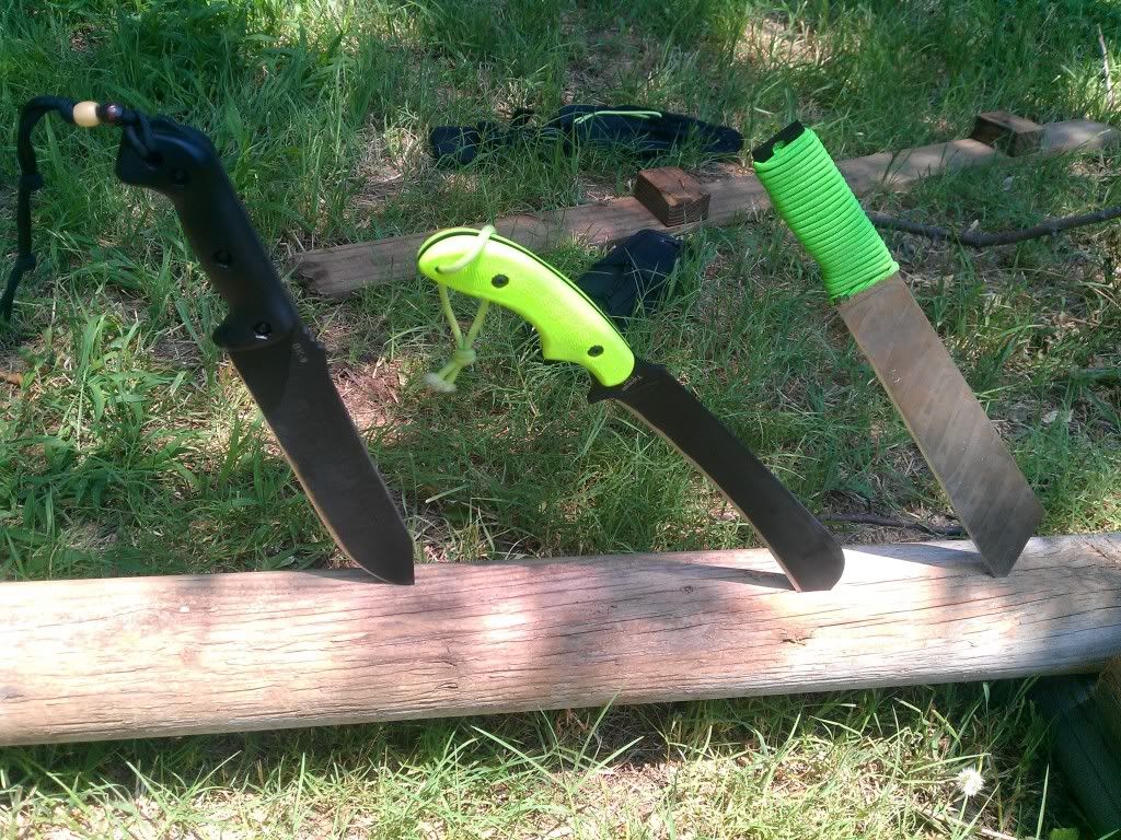

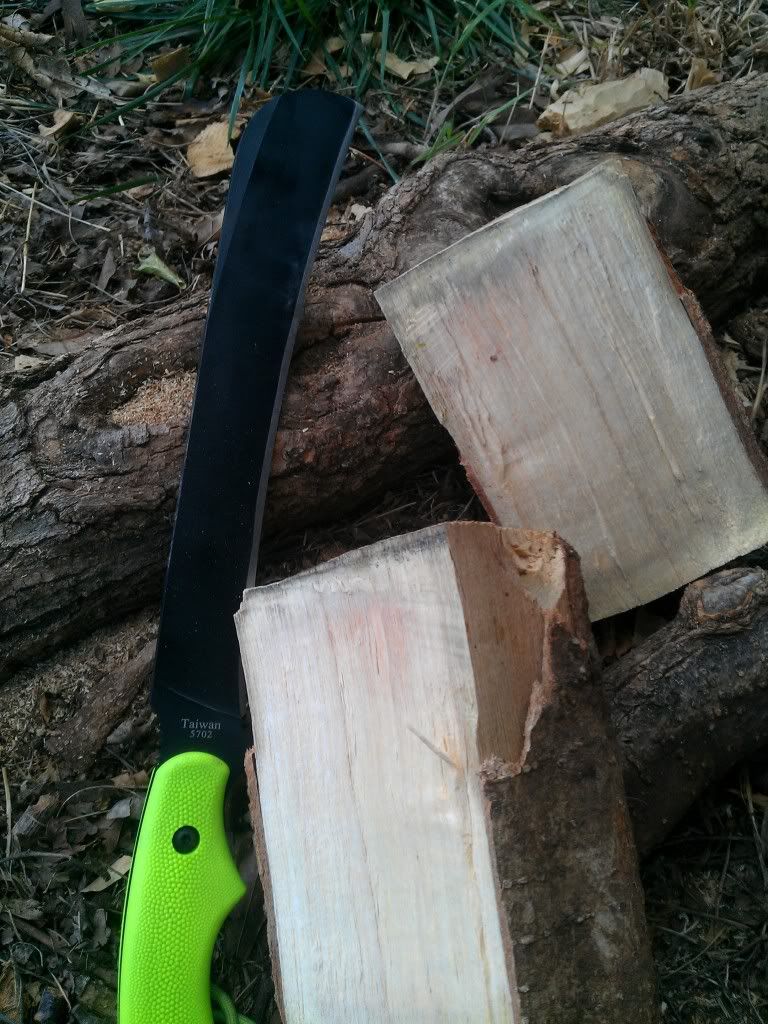

Next up a little knife clubbing... Only had one large piece of wood to use... but it was tough and really dry... First up the machete... WOULD NOT GO THROUGH... The thing is just too thin.. it just twisted and got solidly stuck about 2 inches in... not really surprised honestly...

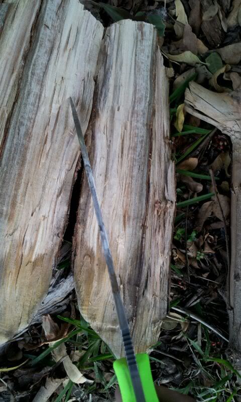

The ZK came up next and did just fine. The SK5 steel is pretty darn springy... You can deflect it by hand, it always snaps right back though.
BK9 like a champ as always...

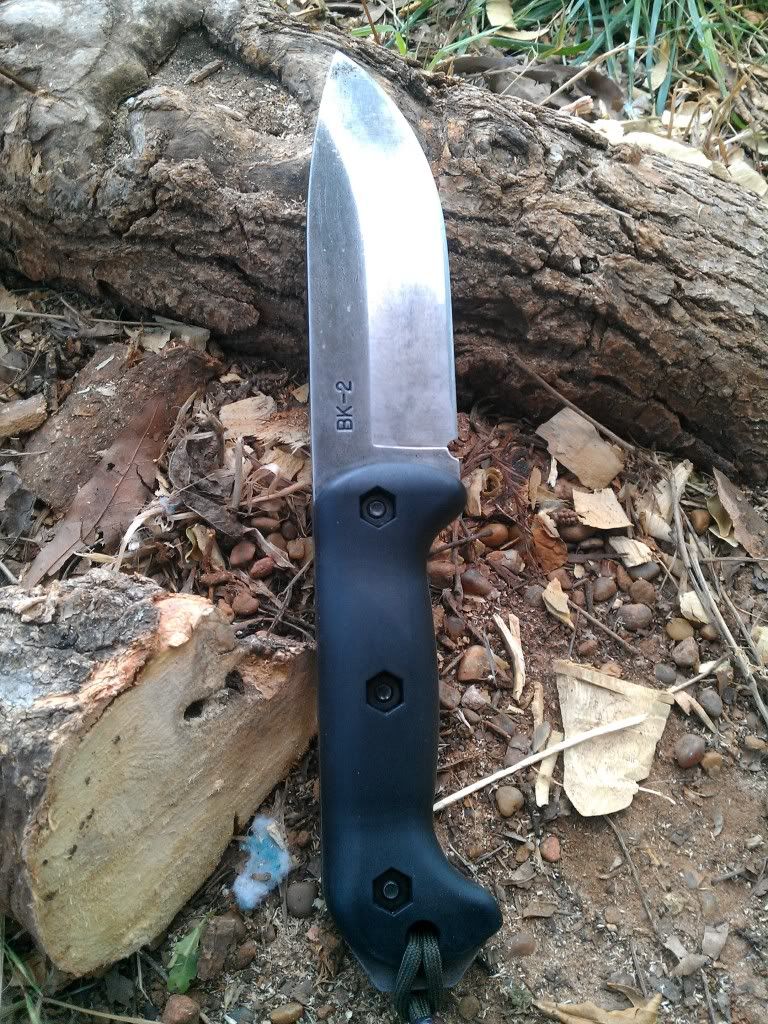

Decided to bring in the BK2 as a comparison... out of all the blades it did the best... literally popped it open in about 2 solid hits.
Overall The BK9 still reigns supreme. I brought out the ZK because originally I was unimpressed with the edge, but after a little work it is a much better knife... Like I said this was not really a competition, but more of just a fun time out... Enjoy.

I was a little worried the first time I noticed how easy it is to bend the ZK's but after doing a little research on SK5 I found it is close, if not a spring steel. So its supposed to be pretty tough stuff when HT'd properly... So for the chopper like what I have its perfect... Edge retention isnt all that special... but for a hacker and slasher, its perfect.

It does do shavings pretty well.
