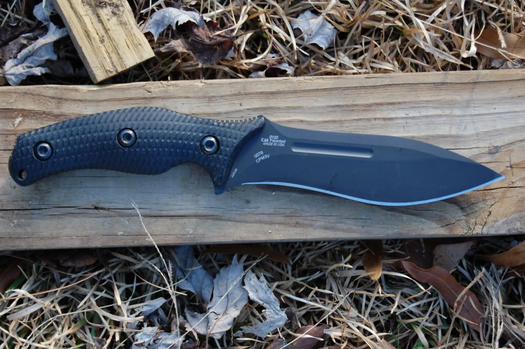

The ZT0100 is a sweet looking Knife that when I opened it reminded me of a fixed blade "Spec Bump" The overall quality of the knife and sheath is top notch save for the blade grind, which I will explain later.
Blade-

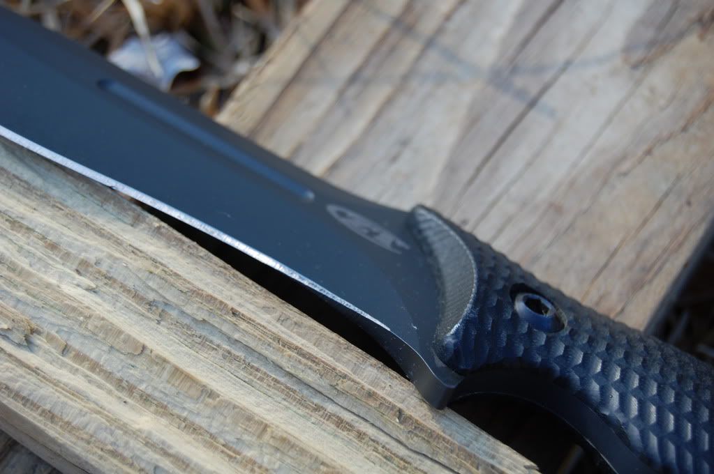

The blade is an awesome recurve/bumpy grind made of CPM3V. I have never used this steel before so I was eager to test her. The blade Has a DLC coating, which Kershaw's is nice and should hold up well over time. There is also a blood grove on both sides which gives it a killer look. The blade shape itself is pretty cool and usefull. It has a good sharp tip, but still seems strong as there is no swedge that runs to the tip, thank god. The grind of the blade is a very slack. Both sides are ground, but the two do not meet to make an edge untill about the very left edge of the ZT logo. I hope the pics show it. Which takes away about an inch or a little more from the cutting edge. This was very disappointing in a $200 plus knife from KAI and this knife should have never left the factory like this.

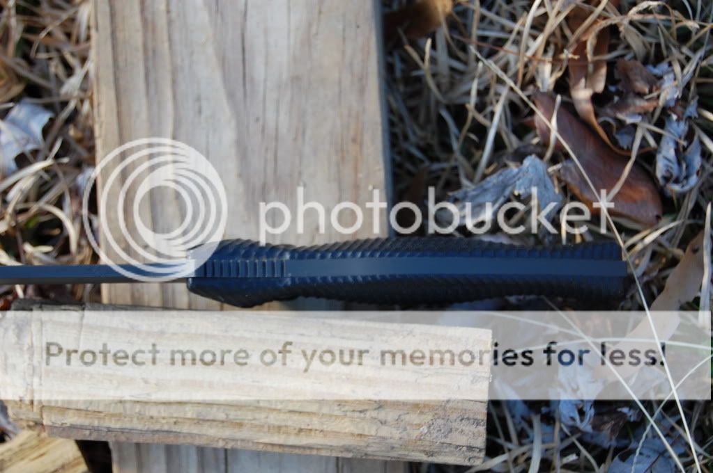

The handle is the winner here and feels great. If you have ever held a spec bump you will know what I mean. This is thicker then that and with the palm swell feels better. The jimping is better then most, but the groves could be a little bigger so it grabs more meat of your thumb. The blade tang sticks out just a little from the handle so you can drive in into something without breaking the G10 scales. The G10 scales are textured and very nice and give good grip. After some use I did find some hotspots, but it wasn't too bad. Another nice thing about the handle is that you can take the scales off for a good cleaning. I really like that feature.

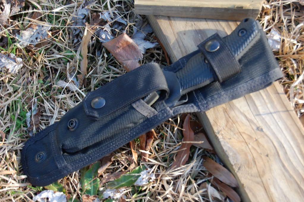

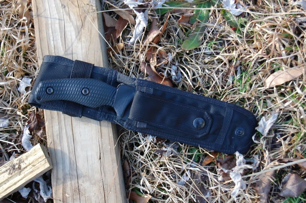

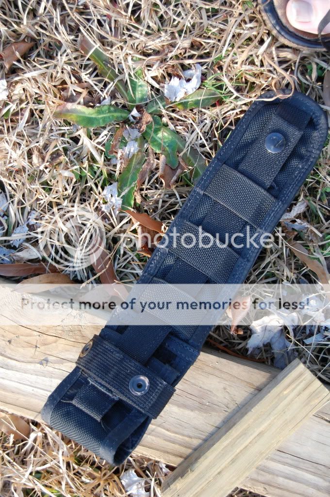

The sheath is sweet. Awesome retention with the Kydex insert. When I carried the knife I buttoned the top strap around the back of the sheath (using the secondary button they provide) which was nice. The Kydex holds it firm enough to where I didn't need the secondary strap. Towards the bottom of the sheath there is a screw. I assume this is so you can take the Kydex insert out and flip it around for left hand carry. I should have tested this, but I didn't. Sorry. that screw will let you take it out and flip it for left side carry On the front of the sheath there is a fairly large size pocket that you can use to put stuff in, like a field sharpener, compass or other supplies. That pouch also has two buttons so that it can expand. I even put my ZT0301 in there and it snapped closed perfectly. Like I said awesome sheath.

The grind on your knife does look funny. You could give Kershaw/ZT a call and see what they have to say (503) 682-1966.

Thanks for the review, I have a spec bump and its one of my favorite knives as far as ergonomics and how sweet it fits in my hand. I have eyed this knife for a while and hearing that it fits like the spec bump makes it very appealing. The only thing I dont like is how far the grind (or lack there of) is on that knife It should be much farther down than that and I tend to use that part of the blade alot. Maybe its just that one?

Yeah Kershaw would fix that right up if you sent it in--just needs a grind there.

Ugh, that's not good. My Offset had the same problem, so I took an angle grinder to it and adjusted the primary grind. Can't really do that with a coating though.
If that were my knife I'd grind a choil in where the blade isn't sharpened so you can choke up on the actual edge for detail cutting.

I bought one of these a couple of days ago. I was thinking about selling it, but I might just hang on to it. After reading this review, I checked out the grind on my 0100 and it looks just like the pic you posted. I guess I will contact Kershaw and see about getting it fixed. Anyone else have this problem with the 0100 and get it fixed?
The grind on my 0100 is just about identical to the pictures you posted, other than that the knife is great.
I contacted Kershaw about the grind on the 0100. I was told that they are done this way by design. It seems like it wastes about an inch of the potential cutting edge.

So does that mean they won't fix it? Seems like Kershaw really screwed up on that. That looses at a minimum an inch, I think it's more than that. The person you talked to might not have understood what you were talking about. Maybe that Thomas guy here can say weather they will fix it or not.
That's really bizarre... I've never had a Kershaw with a messed up grind before, let alone one that was dull 'by design' :eek:...
I contacted the same person I have worked with before on a warranty issue. She said she talked to her manager about it. I sent a picture and referenced this thread. Here is exactly what I got back. I hope it is ok to post this here.
"I have talked to my manager on the ZT0100.blade. It seems this material is very thick towards the base of the blade for durability. This location is actually where the sharpening process also begins. What you are describing is the way the knife has been designed, if you look it up on the internet it will show you the same pattern as your picture. Each and every knife is also hand sharpened on a stone, so no two sides or two knives will ever be the same."
I contacted Kershaw again. She said that even though my knife was not defective(I guess it falls within tolerances), that I could send it in and they would try to some more blade on there. As usual, Kershaw's CS is awesome. They have always been over the top helpful. I guess I will send it in and see what they can do. I will keep you guys posted.
