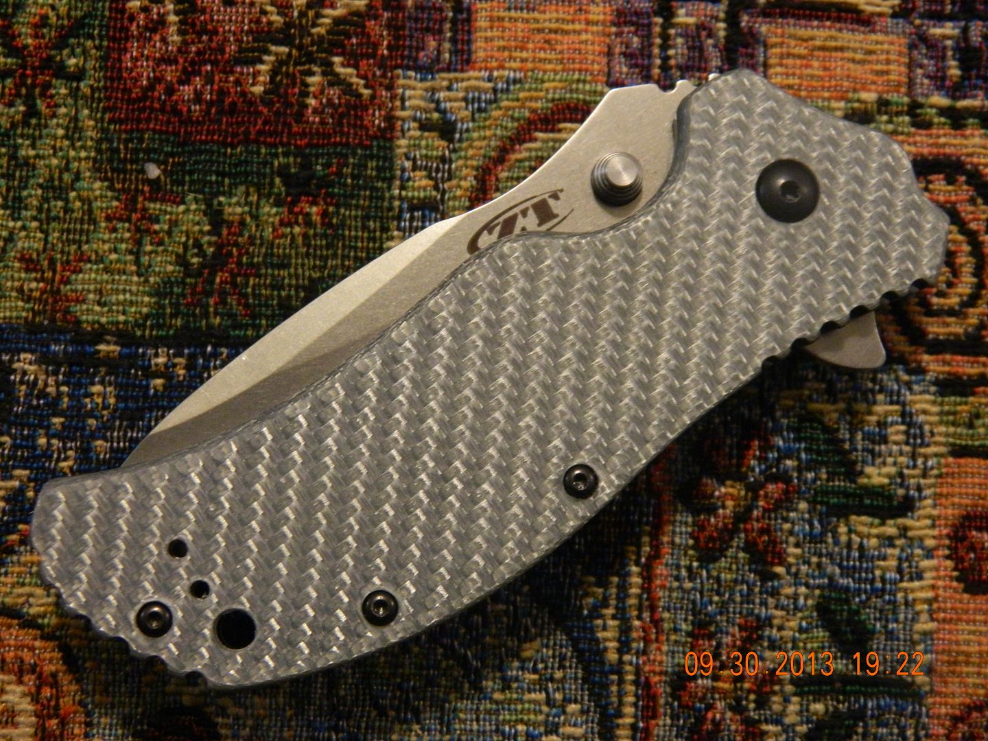

Keyman,
Im in need of a set of scales for my 350 and your pic
has me curious.
can you post a side proflie of the 350 please.
