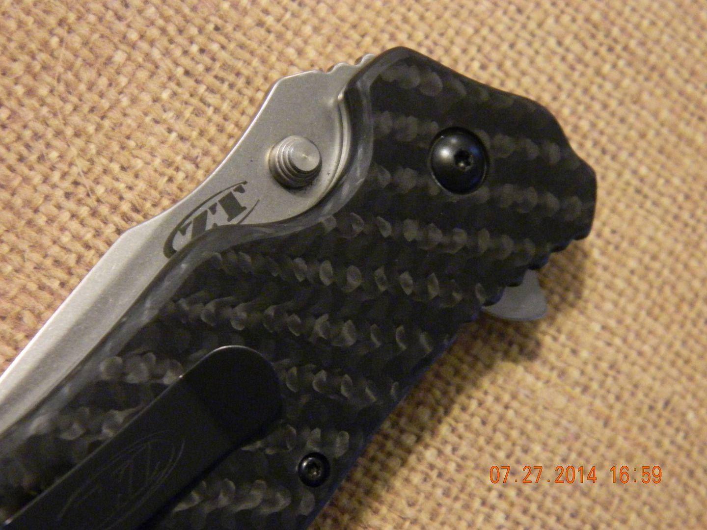

ZT 0350 M390/CF (blade of the 0350M390 and frame of the 0350SWCF):

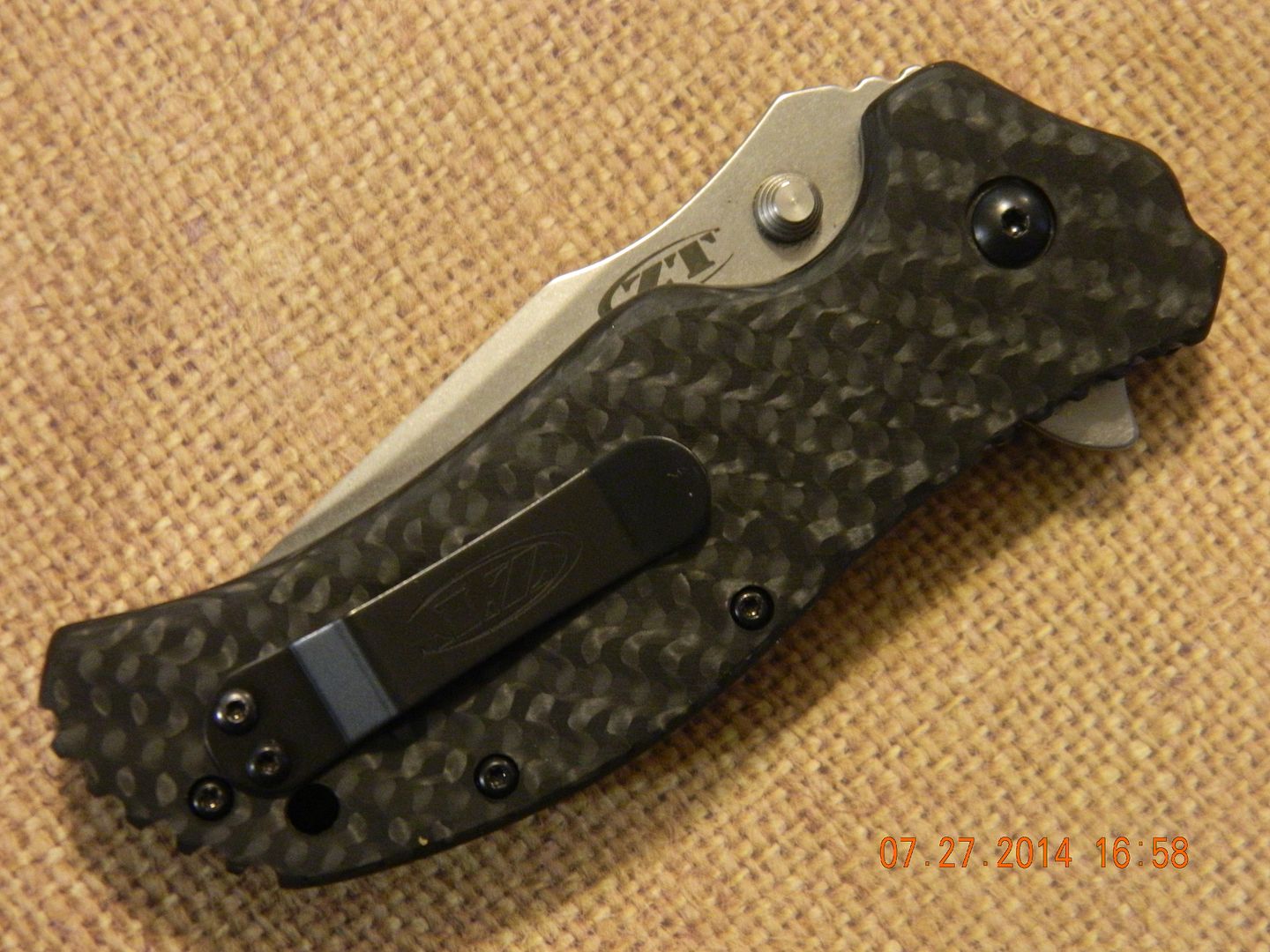

Here's my personal 0350.
I opted for a little thicker scale with more contouring/rounding to the grip.

Nice Keyman. Those are CF scales that you made? Do they have the hollow portion so that the AO continues to function?
Yes Sir!
They certainly do.

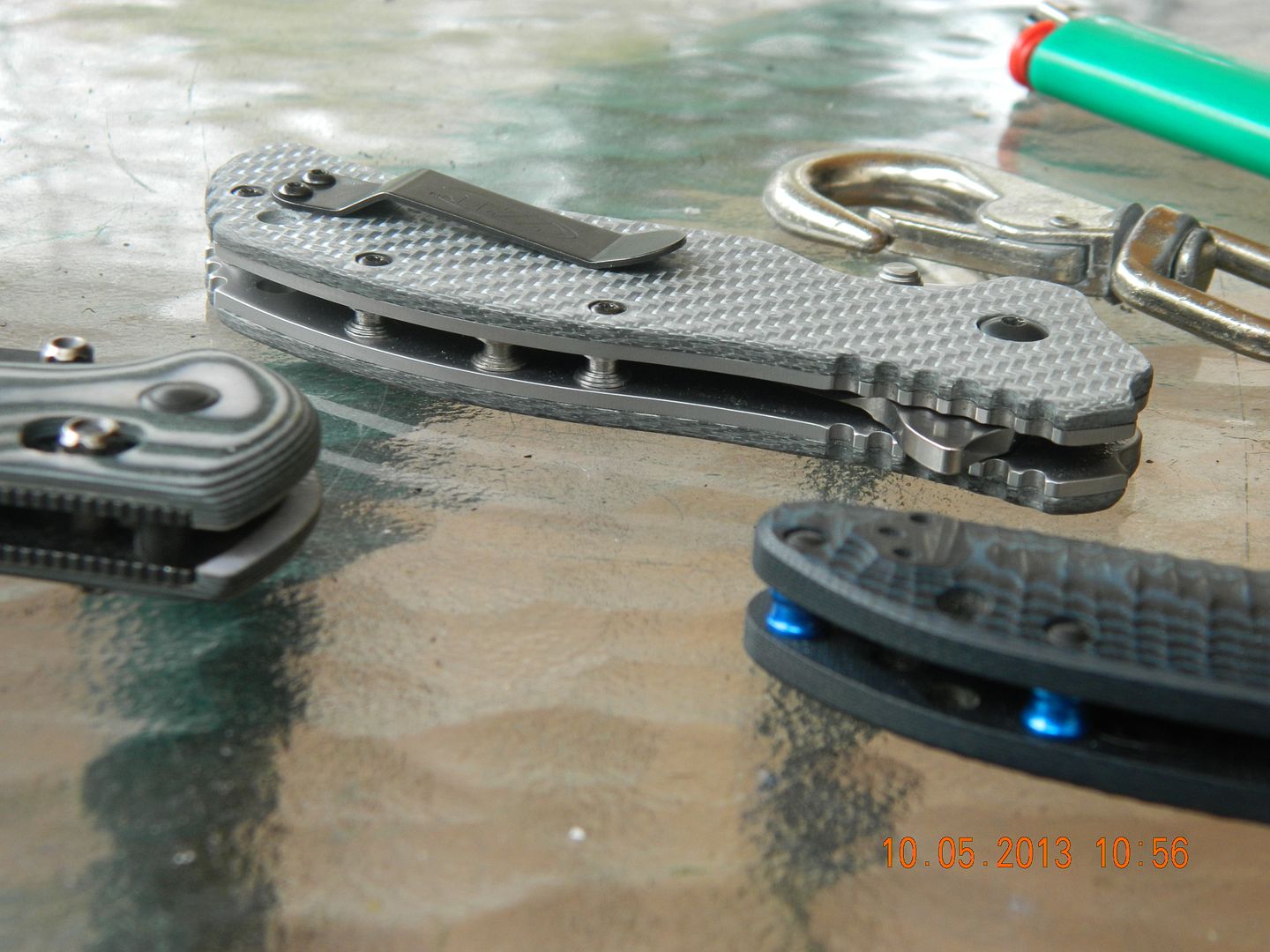

However, I switched over to standoffs with mine.
Those CF 0350s all look really nice.
Keyman - where can I get some of those stand-offs, do you sell them?
I got them from knifekits.
On my custom scales there is a screw coming into the standoffs from both sides.
So, these would need to be threaded or tapped.
If you intend to use these standoffs with the factory scales; they will need to be bored out.
So, the screws can pass all the way through them.
