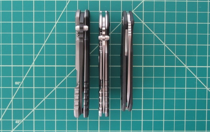

The 0566 and 0770 are both noticeably slimmer than the 0550/0551. The 0770CF is the thinnest and lightest in the ZT line-up. It is still a ZT though, so you can rest assured that the strength and toughness are there. The 0566 has a good weight to it, and it feels very solid in hand, despite being slimmer than, say, the 0550. The ZT site has the 0566 listed as half an ounce lighter than the 0550. The 0550 is just a tank of a knife. It has a nice, thick titanium slab on the locking side and a corresponding thick G10 scale and full steel liner on the other side. The 0550 even makes a different sound when it locks open.
Thickness of the 0566, 0550, and 0560:
Not bulky but much heavier than the 0770. The tan Elmax Blur with blackwashed blade looks awesome from BladeHQ.
