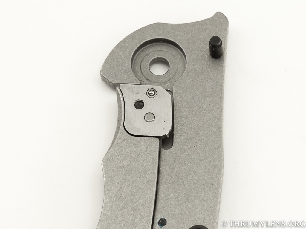

I just noticed something interesting between the 0562 and 0562cf .The steel lockbar insert has different sizes that actually makes contact with the blade tang.
None of the lockbar inserts on My ZT 0562cf M390, 0562cf 20cv, and 0562 Elmax look like yours. They all have the same width as the lockbar.
Seems not to be a big deal. Kinda like the H on Hinderer logo closer to the pin on one vs the other. I dont think it matters much.:)
