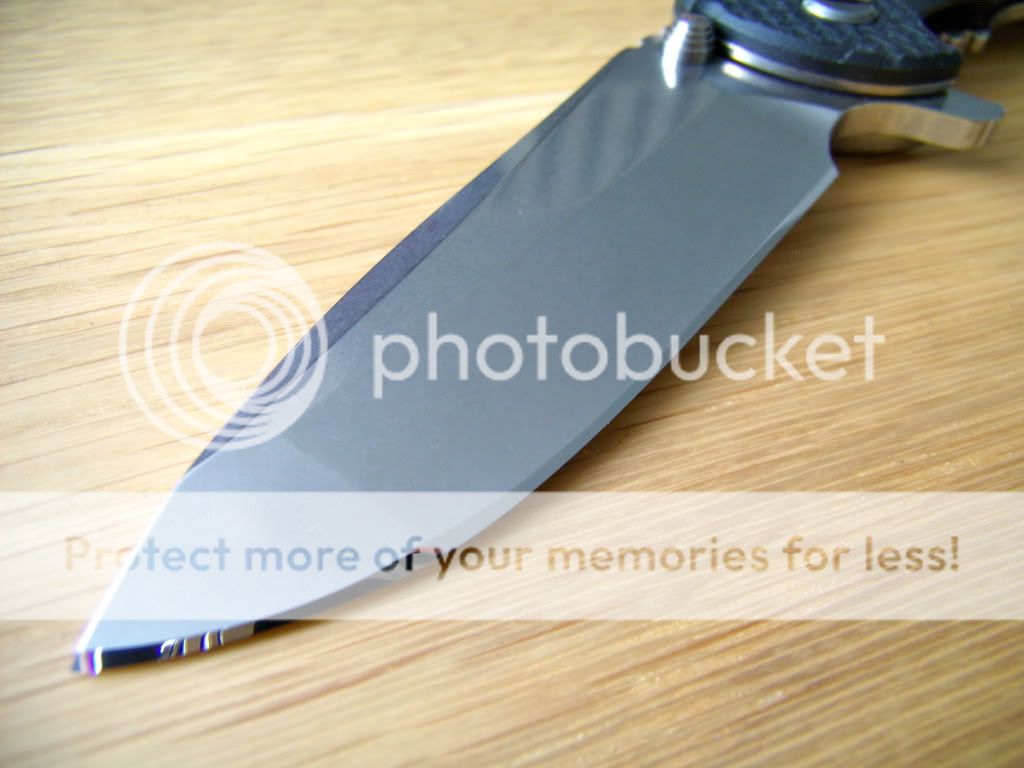

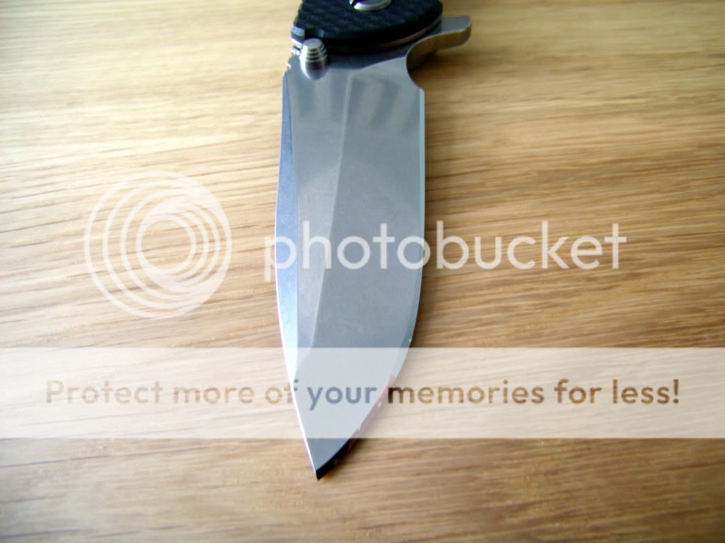

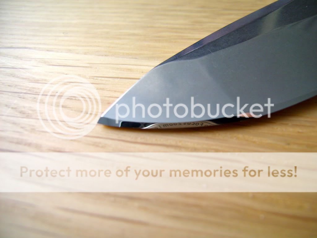

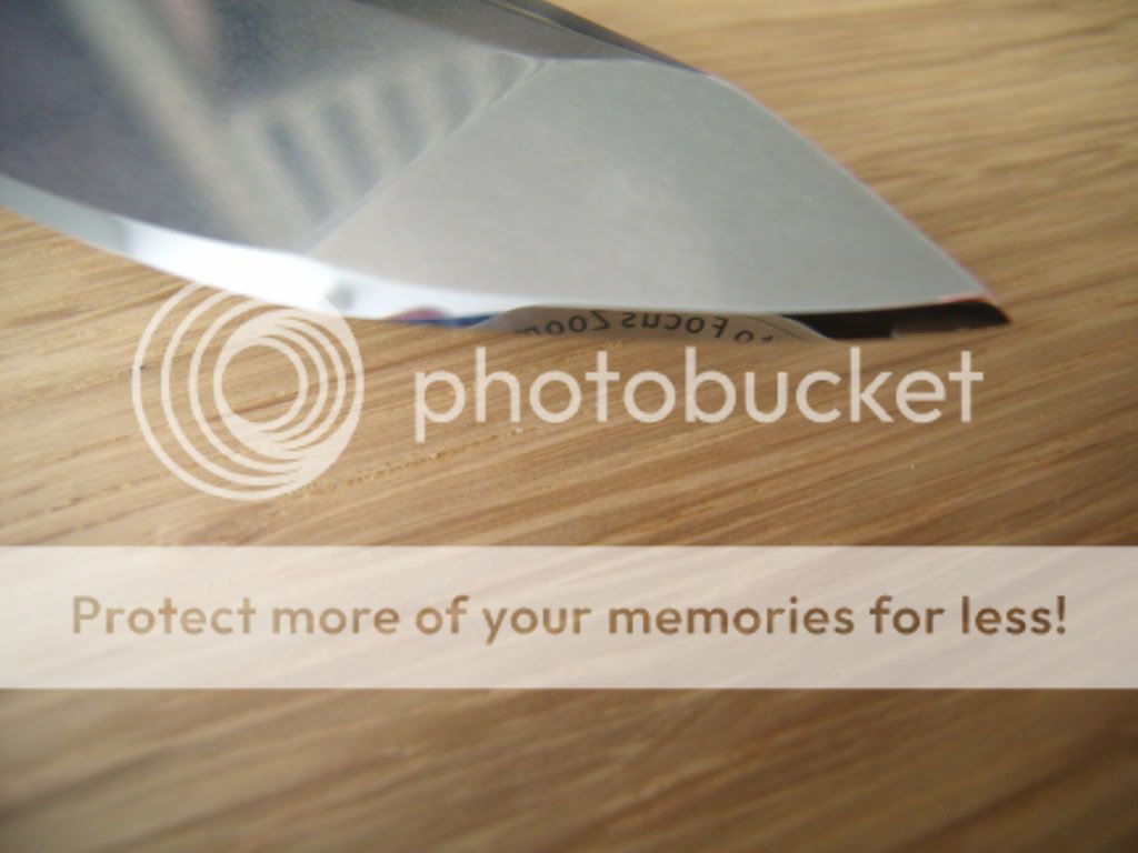

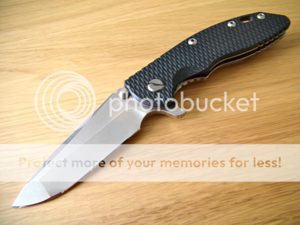

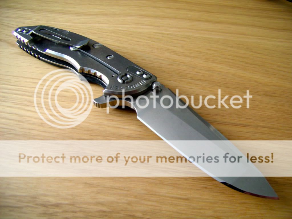

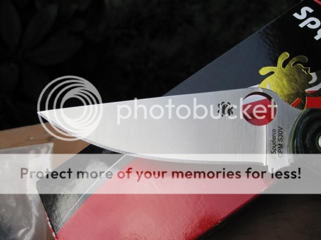

Did this Hinderer XM-18 from a Dutch forum member a few years ago on my Wicked Edge.
The request was to find a good balance between usefulness & esthetics; if possible to create a new edge that would cut well (with an edge angle fitting a strong tactical folder like the XM) while at the same time keeping the bevel width within limits.
The edge was first reprofiled to an even 35 degrees inclusive with diamond stones 200, 400 & 600, and then refined with SiC wet & dry paper 800, 1000, 1500 and 2000 taped to the diamond stones.
The resulting edge was then somewhat polished with 6 micron diamond paste (a tiny dab of paste on the back of wet & dry paper which was then taped to the 600 grit stones)
I stick with the factory angles mostly, taking an edge too low usually ends up with some sort of deformation or chipping.
Honestly, a simple 17° per side would work. 20° is more obtuse generally recommended for edge retention, while 15° is low enough to get really sharp while not being a chip fest. I sharpen everything to around a 17° convex and all my knives get really sharp and hold their edges well enough.
Kwackster, you already have a good back angle edge on that knife but you could reduce it to 15 degrees per side. Great looking edge.
I sharpen a back bevel of 15 degrees per side, primary bevel of 17 degrees per side. That is two different bevels. Yours is about what my primary bevel is. My back bevel is about three degrees sharper per side, 30 degrees inclusive. The edge holds up nicely and cuts like a dream.
Gatorflash1, i know what you mean, and 30 degrees inclusive (or a combination of 30 degrees backbevel and 35 degrees primary bevel) would have made for a better cutting knife.
Problem would have been that it would also have widened the bevel noticeably, something the owner absolutely did not want.
