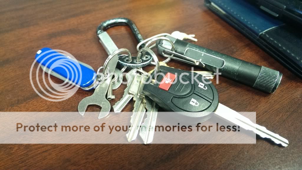

Overall a really awesome knife. :thumbup: I carry a 3/8" dremel wrench attached to my keys; makes pivot adjustments easy peasy!
