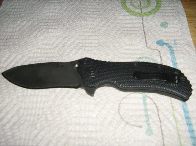

Hi,
I figured someone here would be able to answer this, can I remove the pivot to clean and lube the knife without taking the entire knife apart? Thanks in advance for your answer.

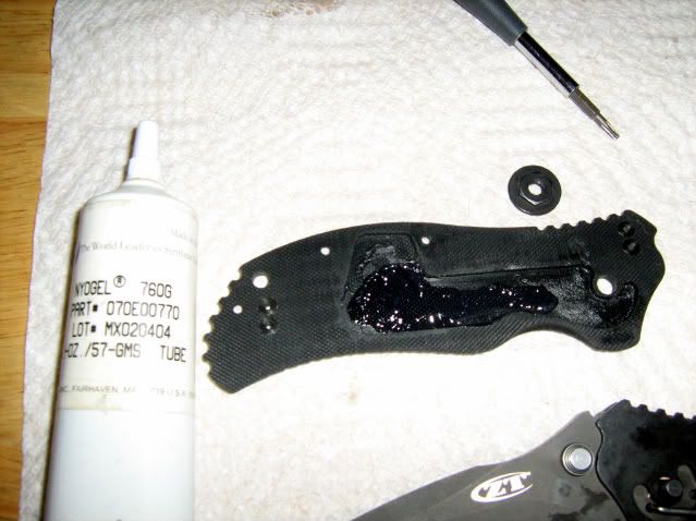

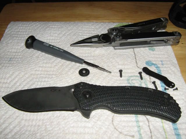

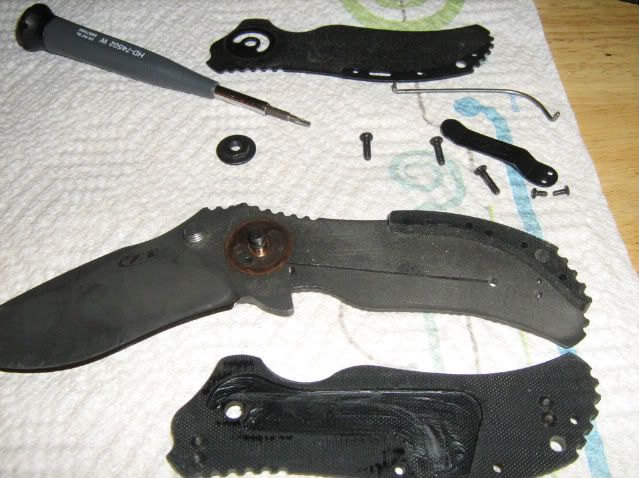

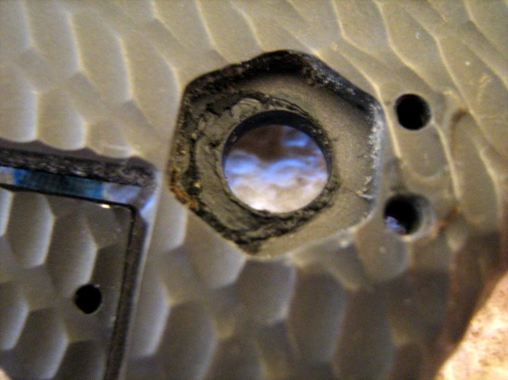

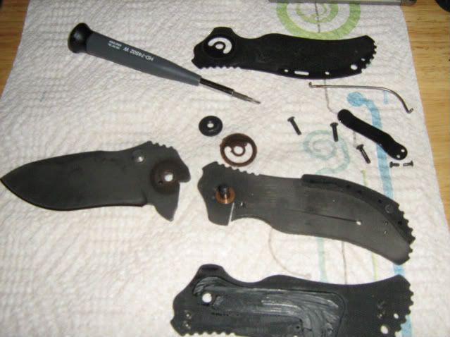

There's no replacement for the cleaning and lube you get from disassembling a knife. The 300 series is not difficult to take apart either. When you do you'll notice a cavity milled into the G10 side where the torsion bar is housed. If you put a layer of grease in the cavity it'll cure the oh so annoying rattle from a AO Kershaw.

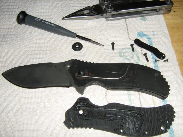

Open the knife before disassembly, the Torsion bar needs to be unloaded unless you want to lose it.
It would be harder to do that than just taking it apart.

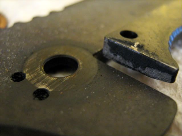

The dirt gets everywhere.

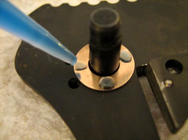

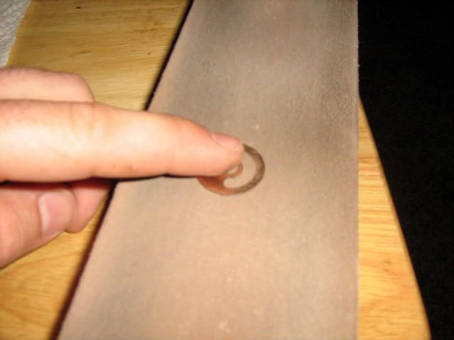

Make sure you clean the washers too.
Add a wee bit of oil.
Add some grease.
Then put it all back together.
