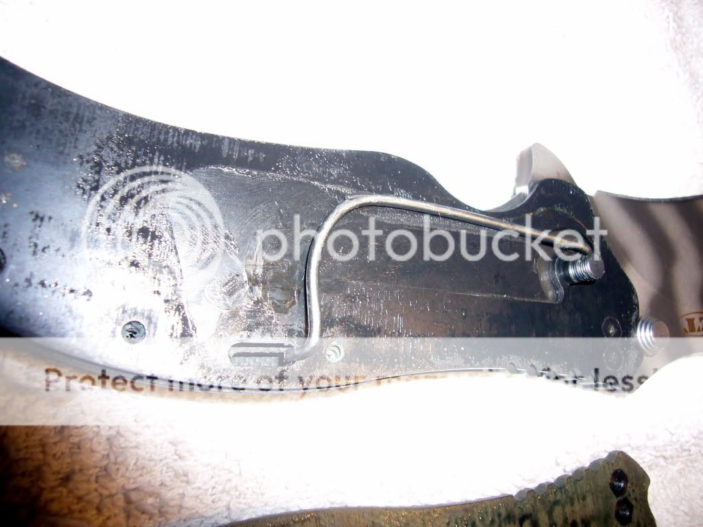

Hey, this thread is a couple days old now but I didn't wanna start a new thread blabbing about my knife and I thought it would fit in perfectly here with all the good talk about Kershaw...
The background is I have been scouring the internetz for some time now looking for a second hand ZT0301 and I found one for dirt cheap. With a catch! Bad torsion bar...

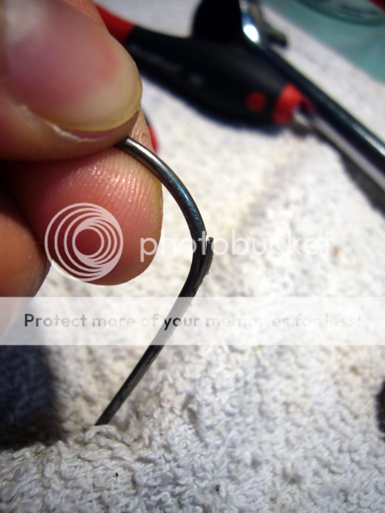

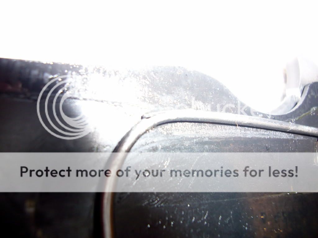

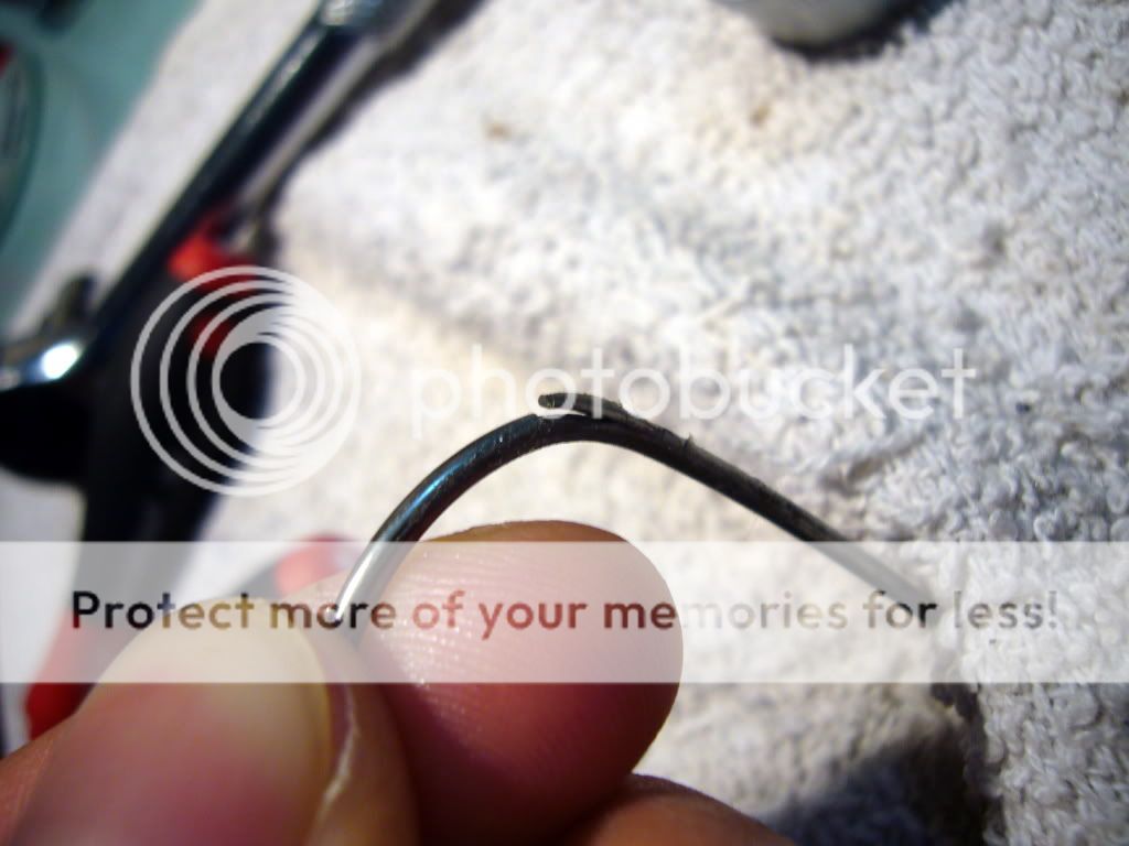

I just took it apart today and it looked nasty! I got the fracture well, but you can't really see the twist at the bottom unless you scrutinize the first picture. Personally I think it looks like a broken leg with a twisted ankle.
It's stamp says Mar 08. Every other part of the knife is in perfect condition. Now, I have no idea how the previous owner got it to happen and I'll add that I have a Blur that I've opened somewhere short of a hundred thousand times with a perfect torsion bar. But what I do know is that a quick email over to Kershaw's customer service and I've already got a free replacement on the way, that they said I'll have in a week, and they even made sure to include some tips on reassembly. In the meantime I've been using it as a non A/O blade and it's awesome that way. It's so easy to flick that thing out, that fat blade just hates staying in. I'd rather have the option to go A/O than not. In summation... Kershaw is awesome. :thumbup::thumbup::thumbup:
