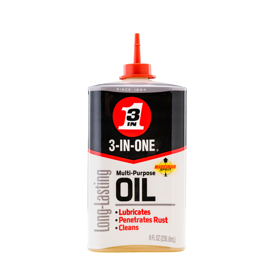

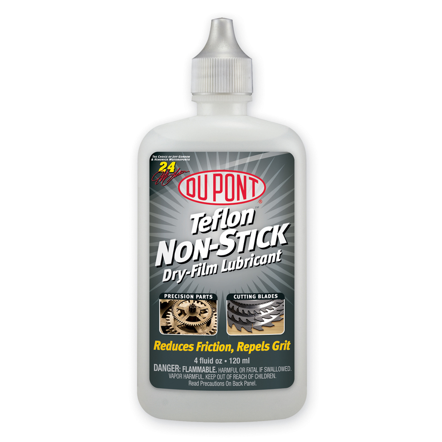

A pin head drop of 3-in-1 oil wouldn't hurt. If you're worried about oil/gunk build-up, then you can also use some Dupont drying teflon lubricant. It goes on as a liquid and dries leaving a thin layer of teflon. NO metal is rust "proof". All metals rust just at different rates which are affected by metal treatments. Even gold can oxidize or tarnish, it just takes a very very long time. You can make a metal rust "resistant" like stainless steeel but not rust proof. Oil stops rust because it creates a thin layer between the metal and the air and/or moisture which can accelerate rusting or oxidation.
I use both, each on certain knives I EDC. I use the oil on my 0561 since I don't EDC it as often as my other blades.

Aren't they dust-sealed ball bearings? 3 in 1 oil did have some wax in it - it protects, but gets gummy with dust over time. Did they change it's formulation?

Not sure about any formula change, but I prefer to use the drying teflon lubricant on my EDCs I carry the most often since the pocket lint and junk does gum up the action after a while.

Yeah 3-in-1 oil can get gummy and eventually even harden over time. I had to clean a bunch of 3-in-1 oil lubed guns once that had been stored for 6+ months. The 3-in-1 oil was almost like a shellac, it locked up the foregrip on the pump shotgun, couldn't cycle it at all. Eventually i got it loosened up with a toothbrush and lighter fluid.
