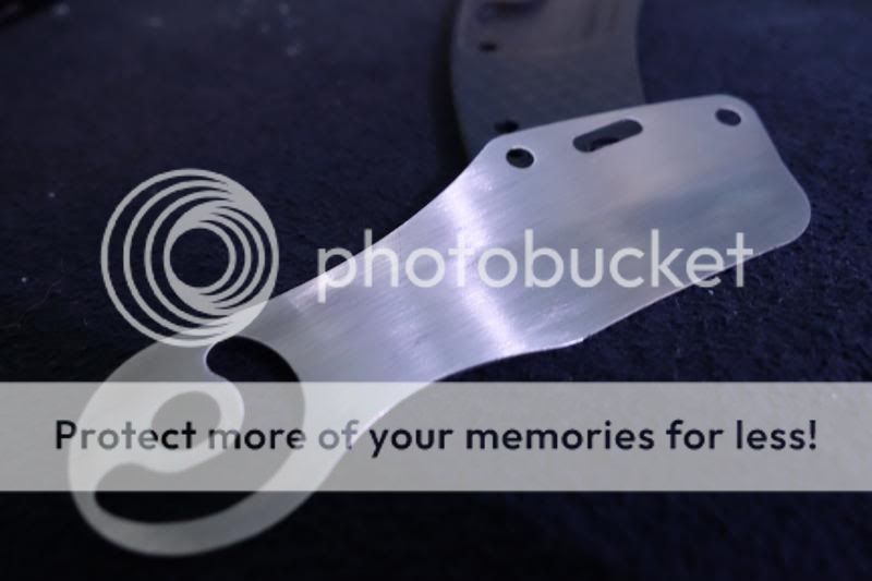

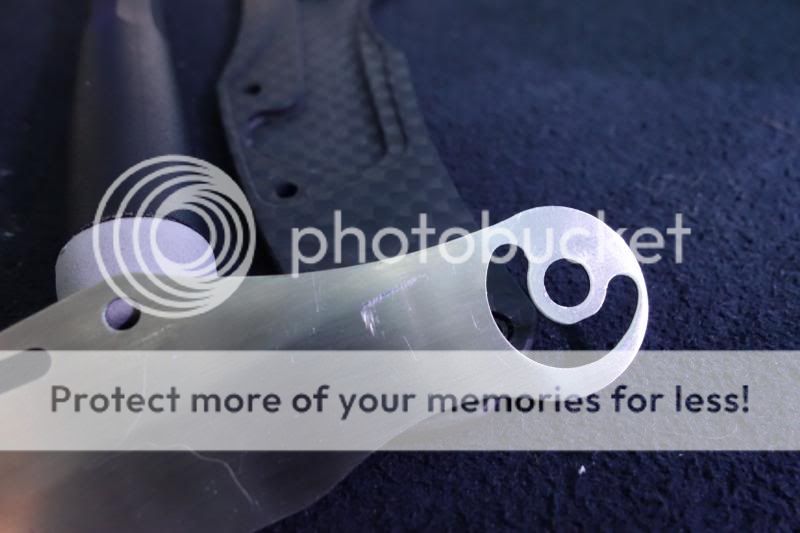

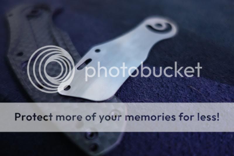

Noticed something worrying while de-assisting my new ZT0770. I don't think this liner is supposed to be bent like this. It bulges outward towards the blade and the flipper rubs on it. The crease makes it very difficult to reassemble. The handles won't lay flat and the small washer doesn't seat against the blade evenly. I cannot believe this part was used by the assembler when the knife was in production. This is my first new ZT in a while. I absolutely love the knife, but I'm not impressed with the build quality. The blade is off center and the de-assisted flipping action is terrible. It wasn't noticeable when it was assisted but now it is painfully bad. With the pivot tightened sufficiently so there is no blade play the knife needs 2 hands to open. I'm sure ZT will make it right, but this is unacceptable for such an expensive knife.
...just needed to vent.
Mine is like that. I'm pretty sure it's supposed to be that way. But I did have to send my 0770CF in to ZT because the flipper was actually rubbing against the inside of that liner when it was being closed. The blade wasn't closing straight for some reason. Hopefully they'll send it back to me fixed. But that bent liner is fine. All the videos on youtube have it as well.

Send it back for a refund, or replacement. If that isn't an option, contact KAI and have them look at it. They will surely address all of your concerns. As far as critique on the internal workings on them, unless you know how it is supposed to be, it might not be worth it to get too far ahead of yourself in that department.
Yes, the "bend" supposed to be there. However, mine has no scratches on it like yours....

Mine is bent also and it is quite thin, but it doesn't support the pivot in any way, so just think of it as an additional washer that just happens to extend out and cover the torsion bar (that's really its only function is to keep the torsion bar from falling out of the knife). The design of it being assisted only makes the scales thin in one area and mine doesn't appear to have too much flex (not compared to say, the Skyline which has similar thin G10 supporting one side). IMO, that's just something you deal with in a thin linerless CF or G10 scale on a lightweight linerlock folder.
I used to hate that part of the design on any frame-lock / liner-lock folder without a liner on the non-lock-bar side because I equated flex with weakness or failure, but that's not the case and on a lightweight folder like the 0770CF, it reall makes a difference in weight.

I have de assisted my 3 blurs, 0350, and 0770 and every liner looks just like the one you posted. Its bnt like that so the torsion bar can move. I would not woody about it at all. But your milage may vary.
