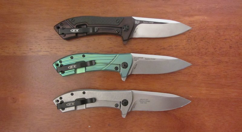

I have an 0801 in Elmax, M390, and S110V. The one that gets the most use is the Elmax one (mainly because it's in green). With somewhat regular maintenance (quick touch-up on the Sharpmaker periodically), the edge retention is effectively the same for my uses. If you are cutting a lot of very abrasive items regularly or like to use your knives until they are dull before re-sharpening, then you would get more benefit from the S110V or M390 ones.
