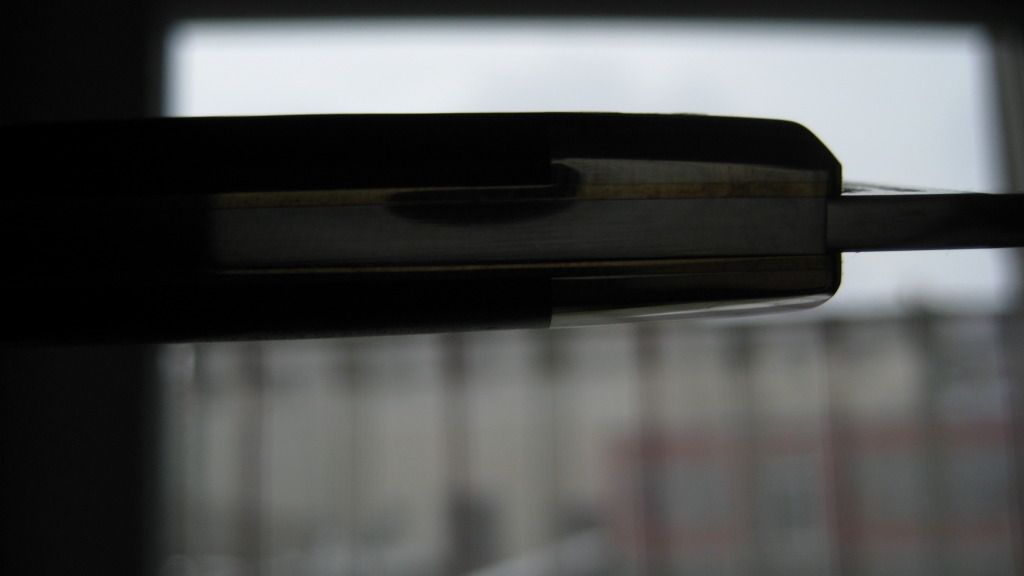

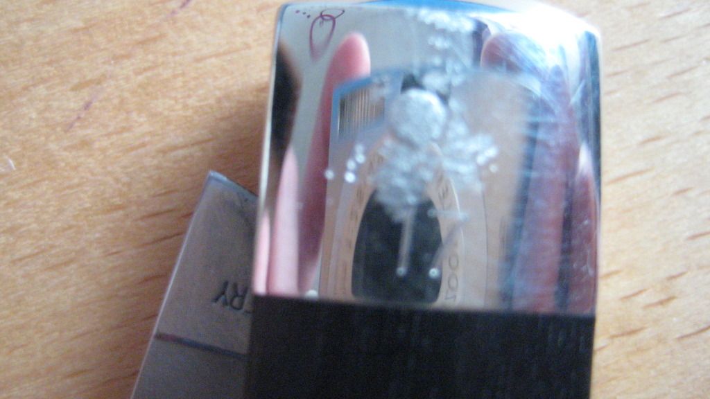

Lockbacks are really a different beast. Really have a locking bar, not so much a backspring. If you don't shim them when tightening then you have to push the blade completely open and closed. If you do shim, then there will periodically be a little discernible movement (by design, but not usually noticeable). GEC's other true backspring knives can close up like a steel door, because the tight backsprings can overcome the extra resistance of a watertight fit. Having said all that, it would be great if every knife had perfect action and no cosmetic issues. If it is worth the extra money to have a perfect model, you might just pay the dealer and extra 25% next time to really look it over hard with your particular expectations in-hand (humor).
Couple things to note. 1) GEC probably does not have any of those in stock and cannot take it apart economically; thus my guess is that they will probably have your dealer issue a refund or replace with another model. 2) Edited to allow for continued plausible deniability -- but import/export of any wood, stag, horn, shell needs to be investigated beforehand.
