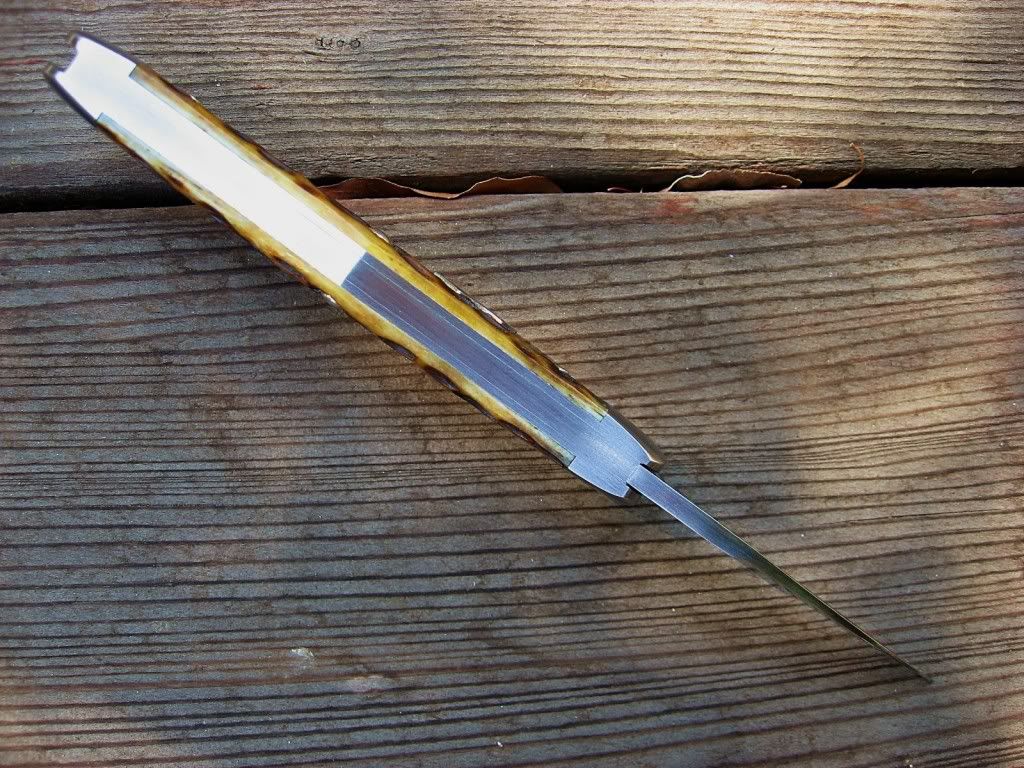

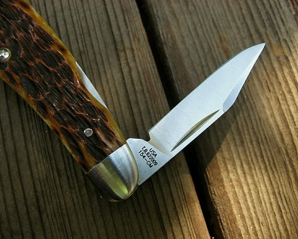

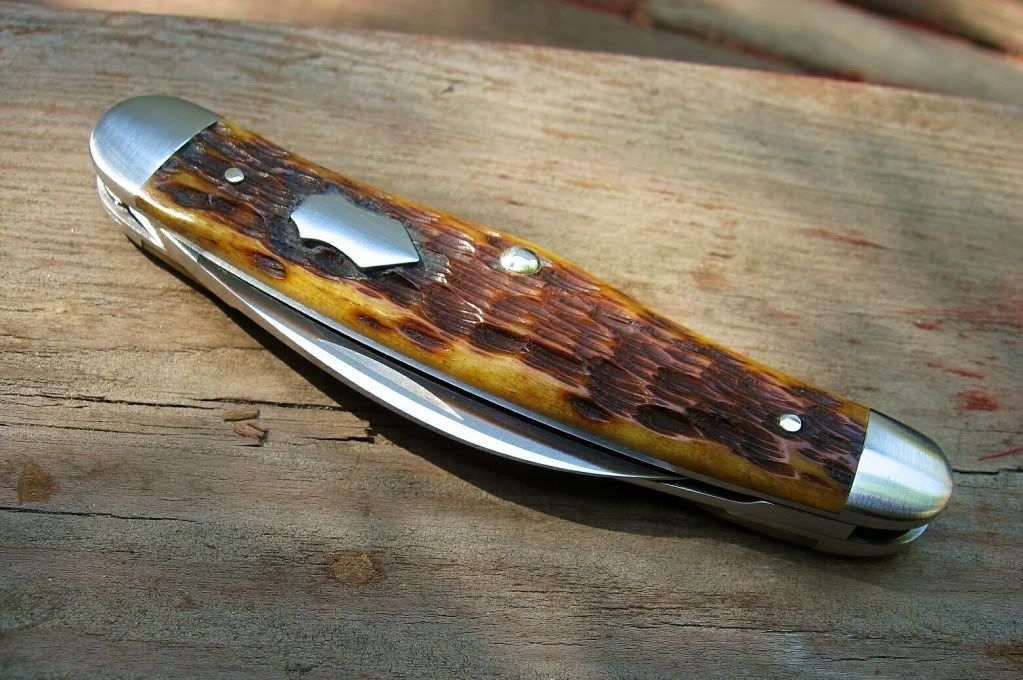

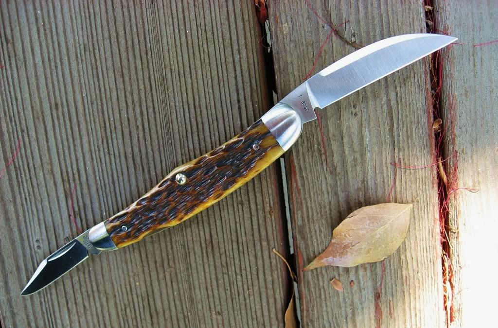

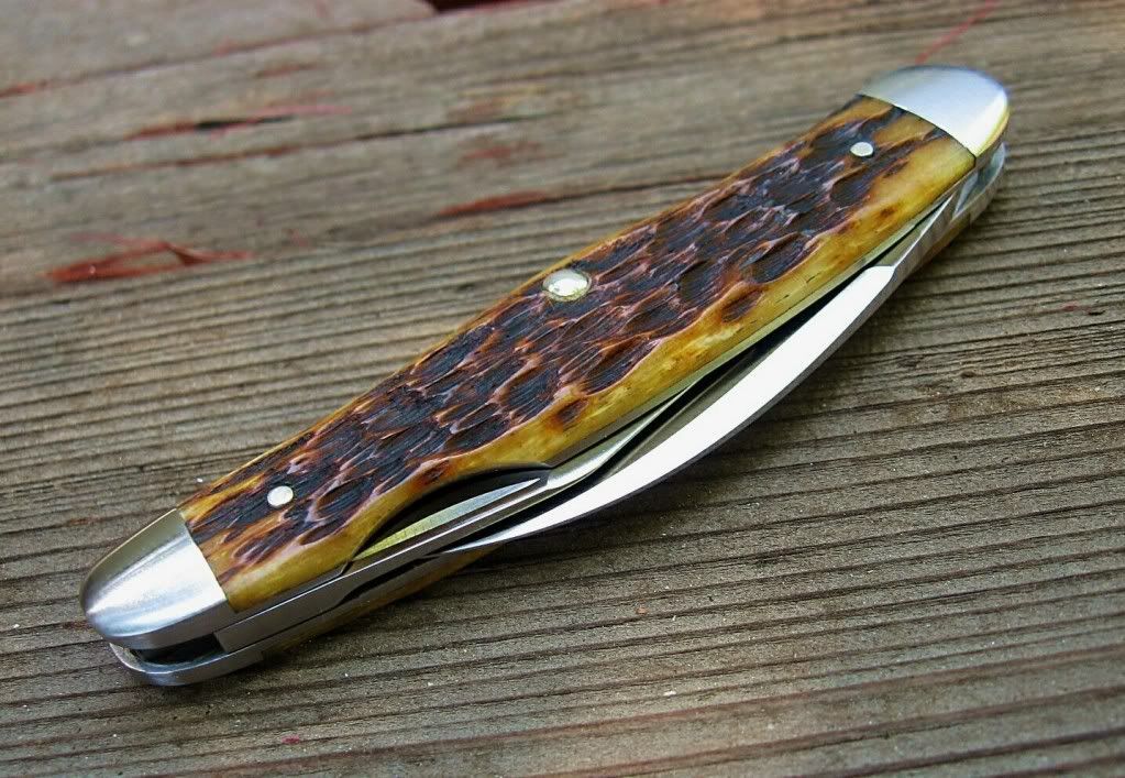

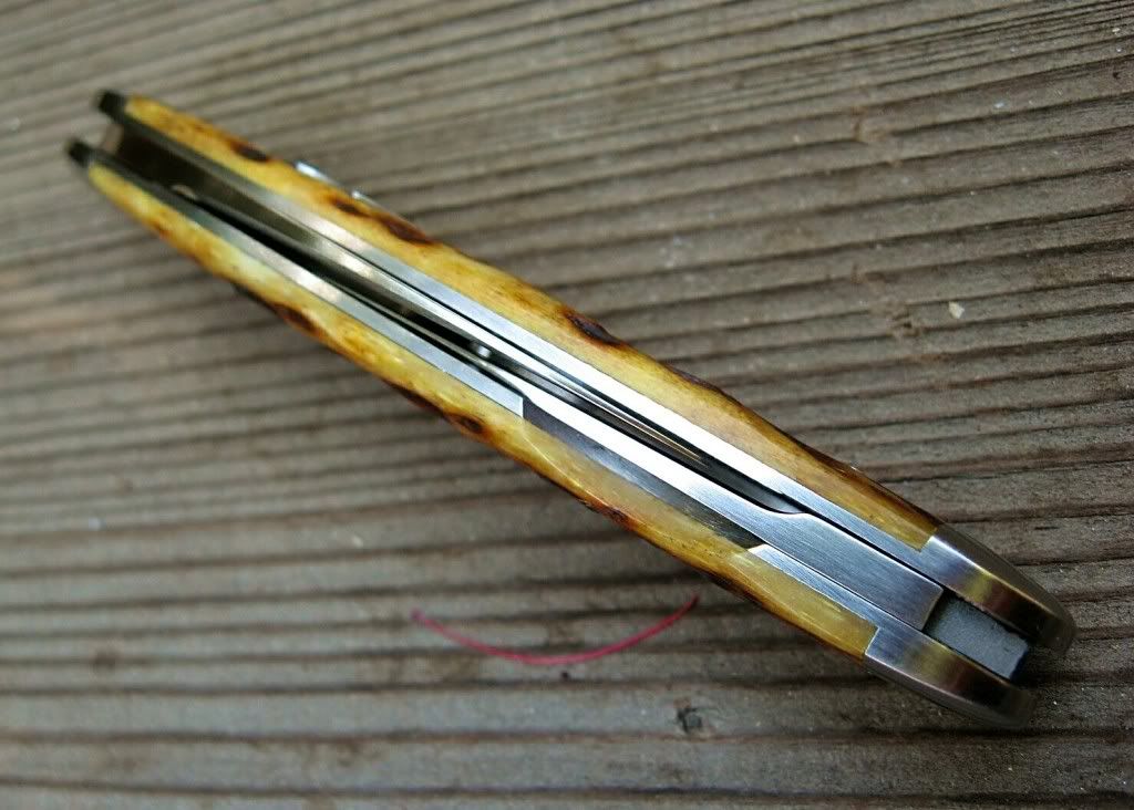

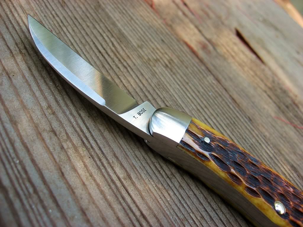

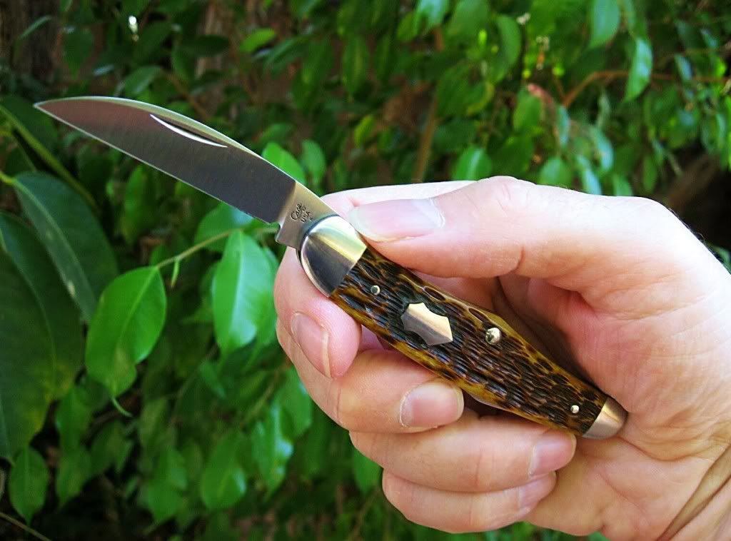

Tony and Case did a wonderful job on this pattern. The slim 3.75" long, 0.4" thick handle has great ergos and makes a comfortable EDC with a handy blade selection that's reminiscent of a half-whittler. There are nicely milled liners at both ends, a flush spring in all positions, sunken joints, half-stops on both blades and remarkably good F&F inside and out with no gaps anywhere.
The blades share a single spring and nest neatly within the tight confines of the handle with absolutely no rubbing with one another or the thick stainless liners, which is no small accomplishment. They're both about a 6 on the pull scale and have a solid snap, smooth action and no play.

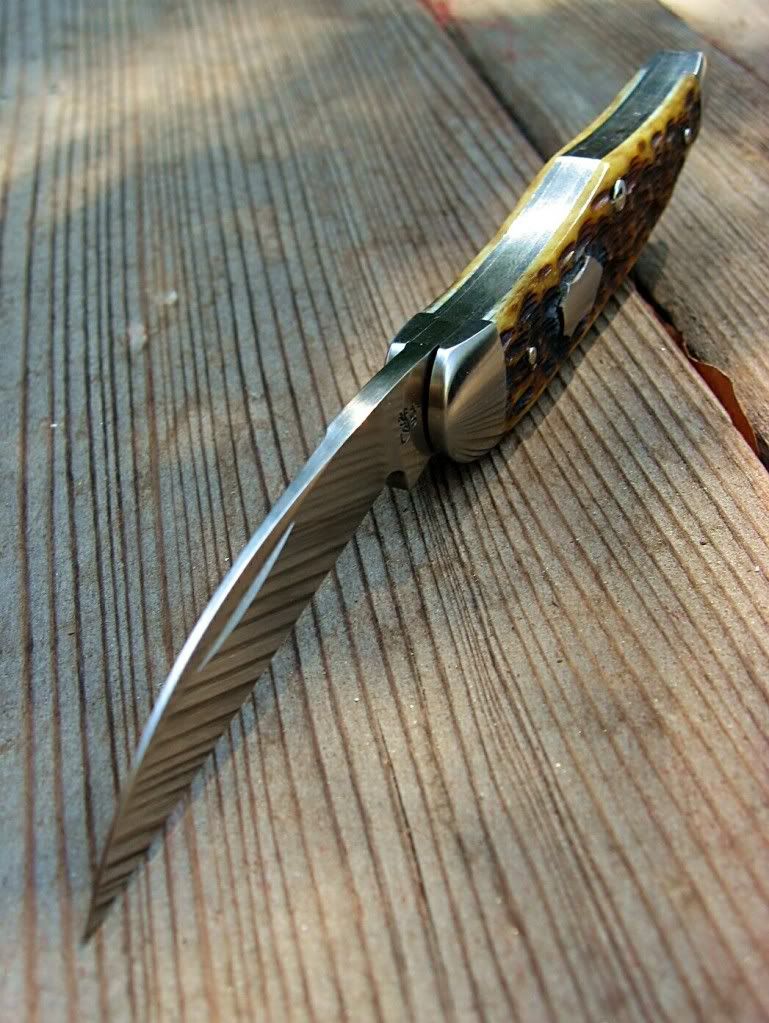

The various cut and drawn swedges are deep, flowing, uniform and crisp, yet they present the hand with no sharp edges when the blades are closed. The shield pin is a beefy thing that looks to be the same diameter as the main spring pin. IMO, this knife is well worth the asking price, and then some.
On with the show:
