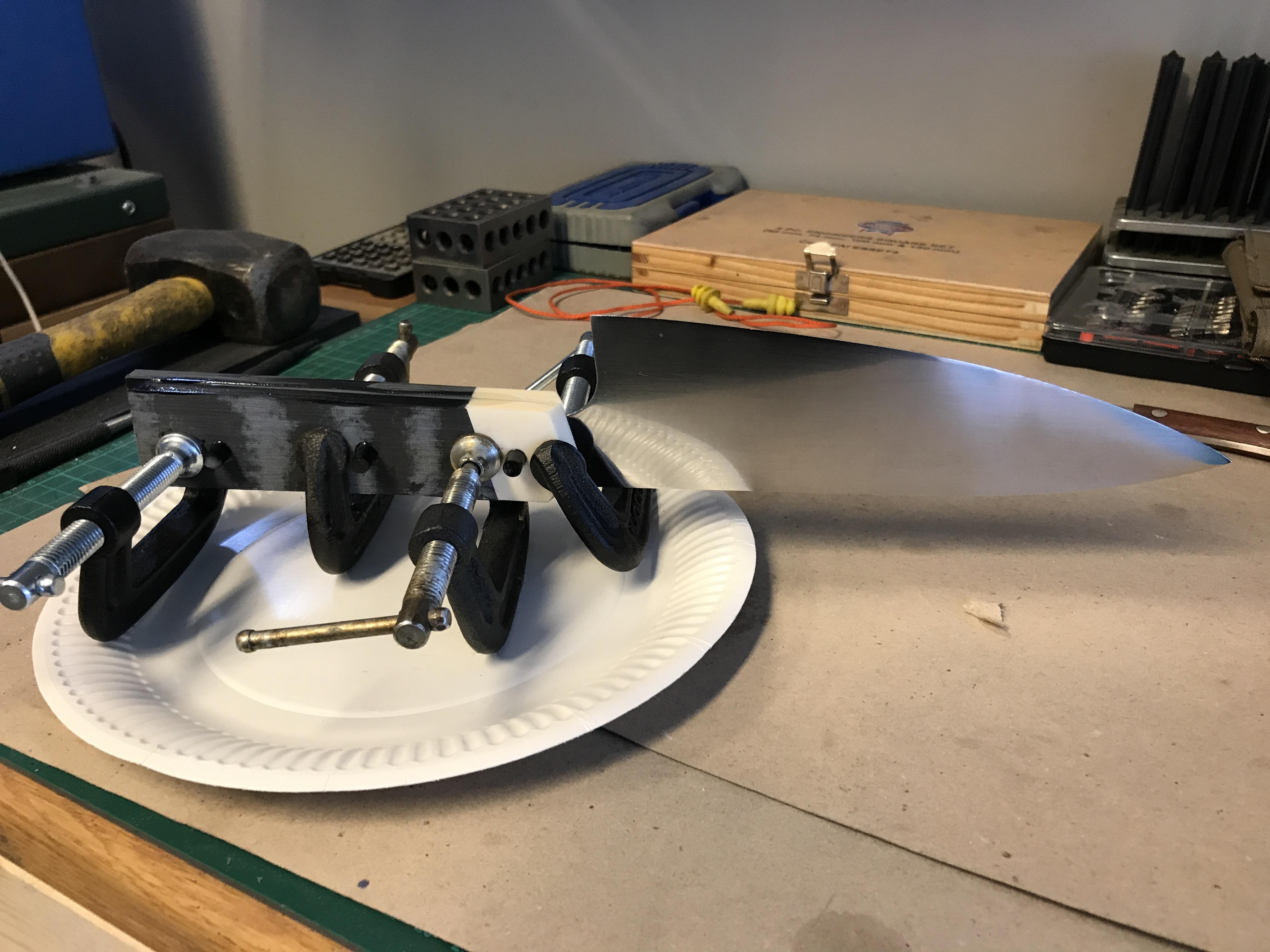

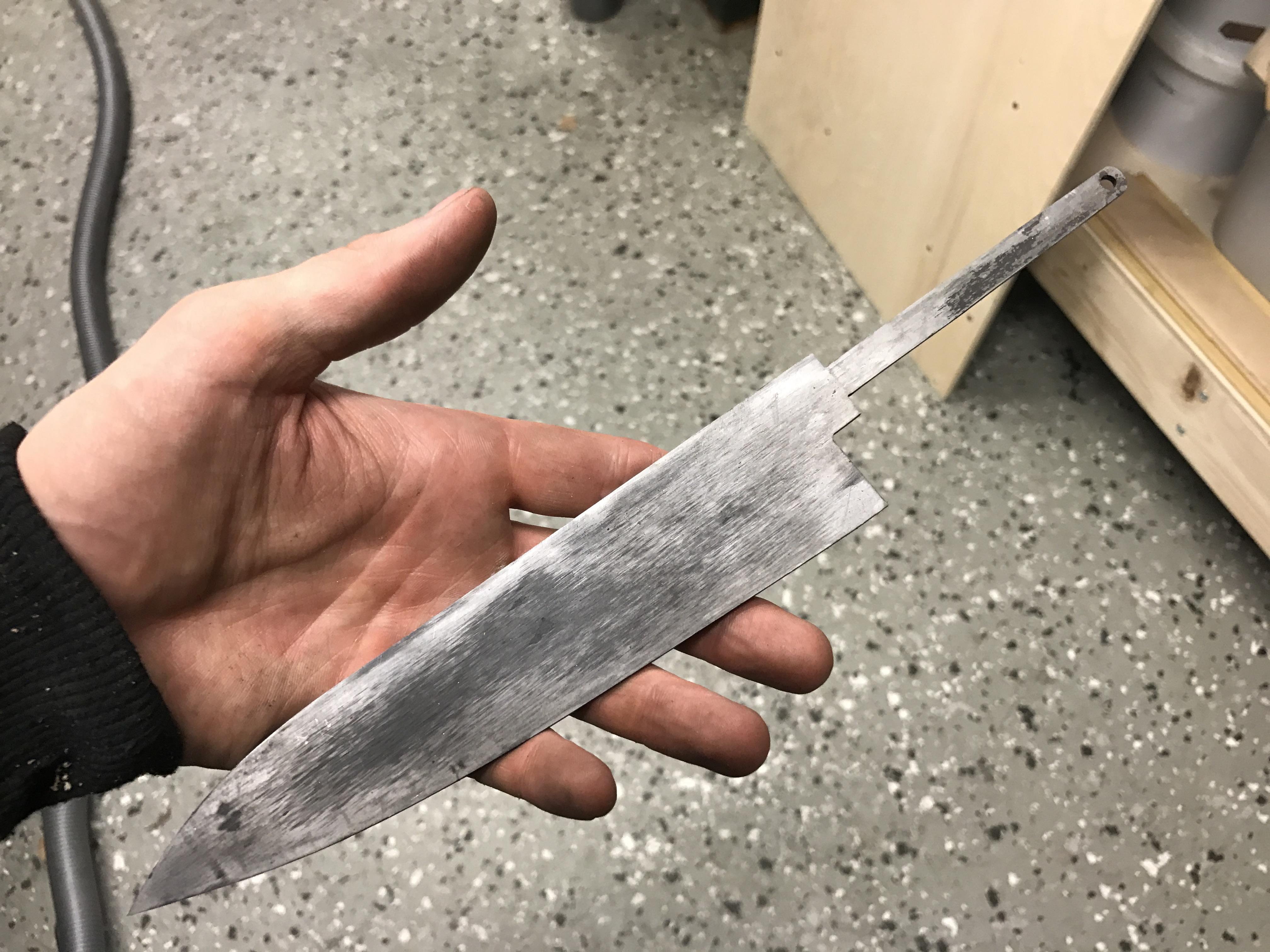

I checked out a bladesports international competition that Scott Gossman hosted a few weeks ago. Got me itching to make something for myself for a change. So this is 15" OAL, 10" blade, 1/4" thick O1. Ready for heat treat.
Sent from my ASUS_Z01BDC using Tapatalk
you probably know the blade wants to jump and slip out of your hand during the chopping.
just a reminder for when you make you handle :-)
with that aluminum surface no need for forced air.. any "normal" thickness will be hand cool by 50 seconds or so..

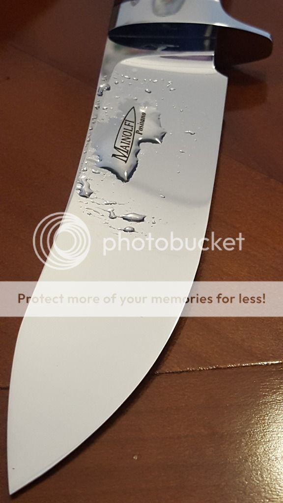

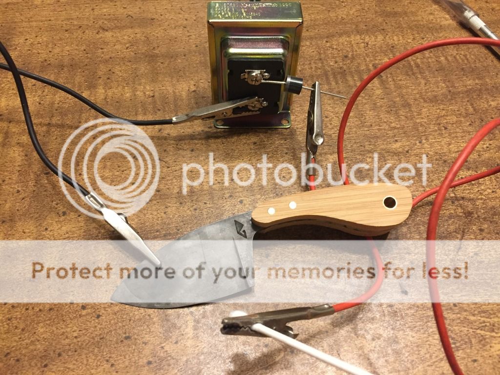

Etching with the simplest etcher/marker ever:
Hah! That's awesome, you even have the option of switching from ac to dc just by switching sides of the diode! Lol! Love it!
Please explain this set up...appreciated.
Sure, just grab a door bell transformer from a hardware store like this: https://www.lowes.com/pd/Utilitech-Utilitech-Wired-Door-Chime-Transformer/50237313
Then find an appropriately sized diode and attach it to the upper post with the silver stripe towards the transformer. A diode converts AC to DC, so with the red alligator clip on the side of the diode shown in the picture I'm getting DC current to my cuetip etcher. DC current removes metal. Then if I want to "mark" my etch, I move the alligator clip over the other side of the diode (or directly onto the upper post on the transformer).
I just use a simple vinyl cut template:

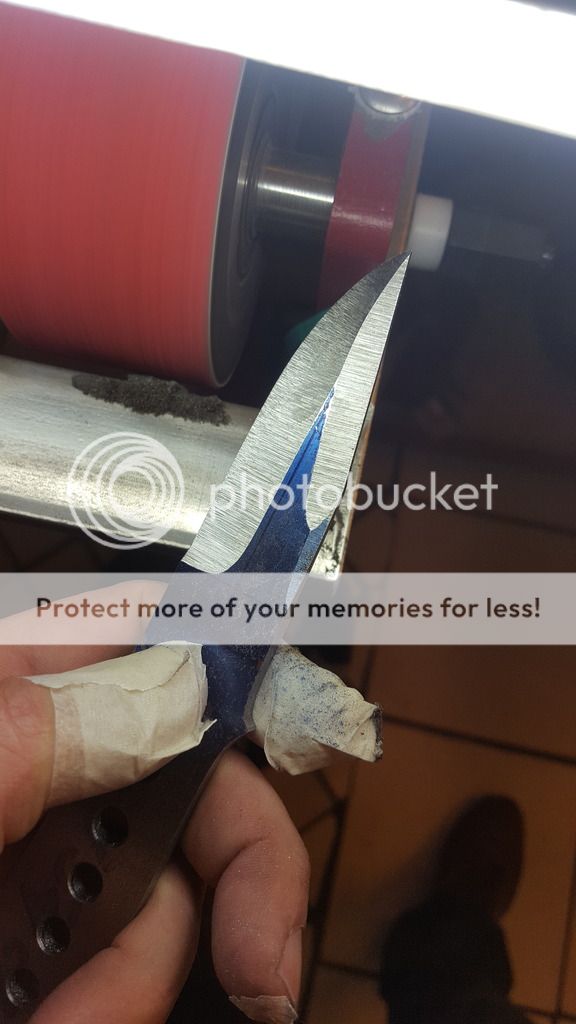

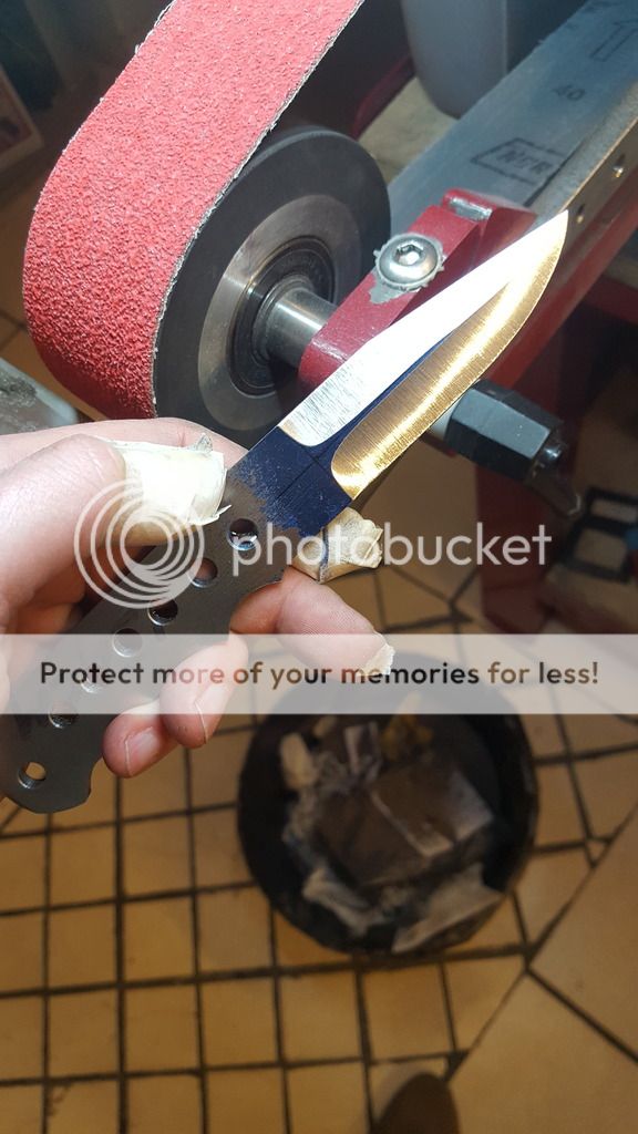

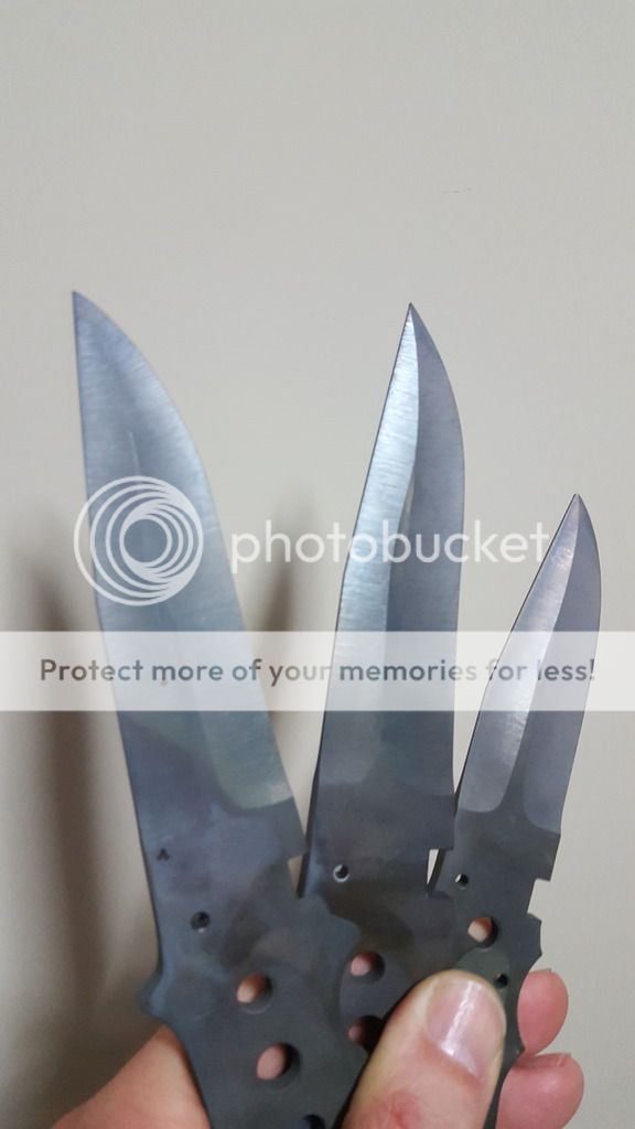

Getting a bunch of finish work done this week. Then on to profiling while I wait for another heat treat batch.
Sent from my SM-G920V using Tapatalk
