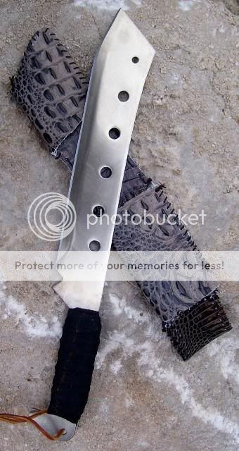

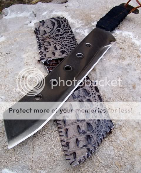

Measurements:Extra Large Knife: Length: Tot=18”, Blade=12”, Handle=6”, Width=2 1/2”, Thick=3/16”
Large Knife is 15 ½ “ long, Blade is 10” & Handle is 5 ½ “, Width is 2 “, Thick=3/16”
Shop Details:

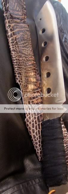

The steel I used on this knife is ½ ton Leaf Spring. Although this knife is influenced by the original “Golok” and the Rambo IV movie, I added my own characteristics to it. I designed the knife style on paper, then cut the shape out. I set up a forge, by stacking fire bricks together and leaving about a 3 inch by 3 inch by 12 inch hole inside of it, and I cut a hole out in the back for my fire to blow in. I used a propane torch with a turbo tip to shoot it inside the hole in the back. It took about 5 minutes for my blade to reach a bright orange (approx 1600 degrees Fahrenheit). I took a pen magnet and extended it out and reached inside and it was not magnetized. I let it go a little longer and then pulled it out and immediately dunked it in transmission fluid. I polished to a nice and durable satin finish.
I tempered it by cooking it in the oven at 400 degrees for 1 hour, letting it air cool, then putting it in 1 more hour at 400. It came out with a nice slight yellowish tent to it, that I like. I file tested the blade and it passed. Seems very hard.
Package & Price:

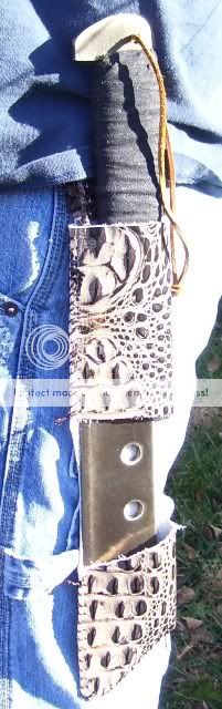

Available in Large & Extra Large, as well as Black or Silver blades. Asking $187 for XL & $142 for the Large. This includes shipping & sheath, if shipped in the US. You can send through Paypal to ScorpionBows@mchsi.com or mail M/O to our address (see web site for address). Pictures below are examples of our XL knife. The Large version has the same style as the XL, but is 2 1/2 “ shorter & ½ “ narrower. Hand stitched sheaths are included and are available in Dark Red or Deep Brown Gator Hide. The handle is cord wrapped with black grip tape.
