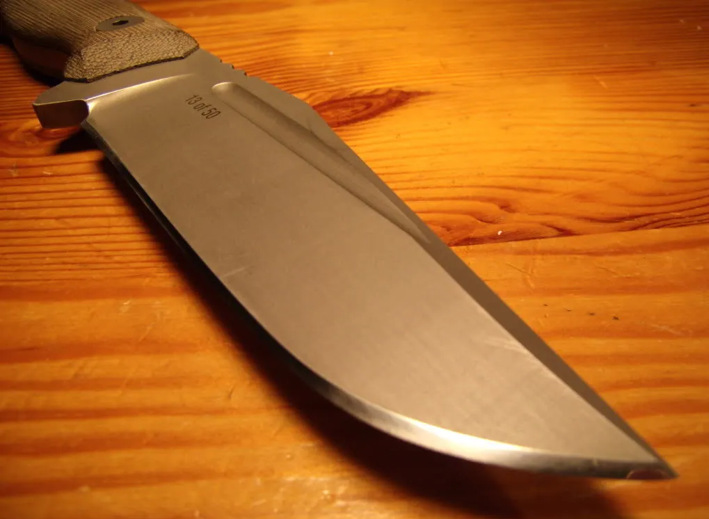

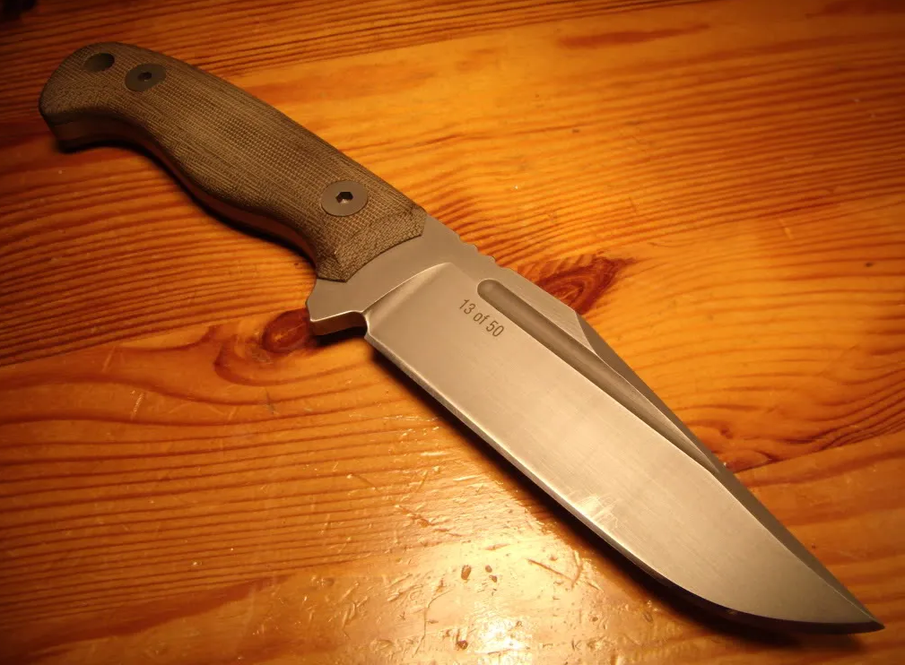

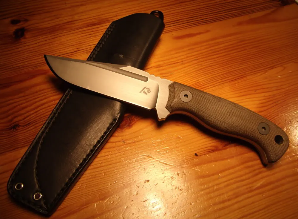

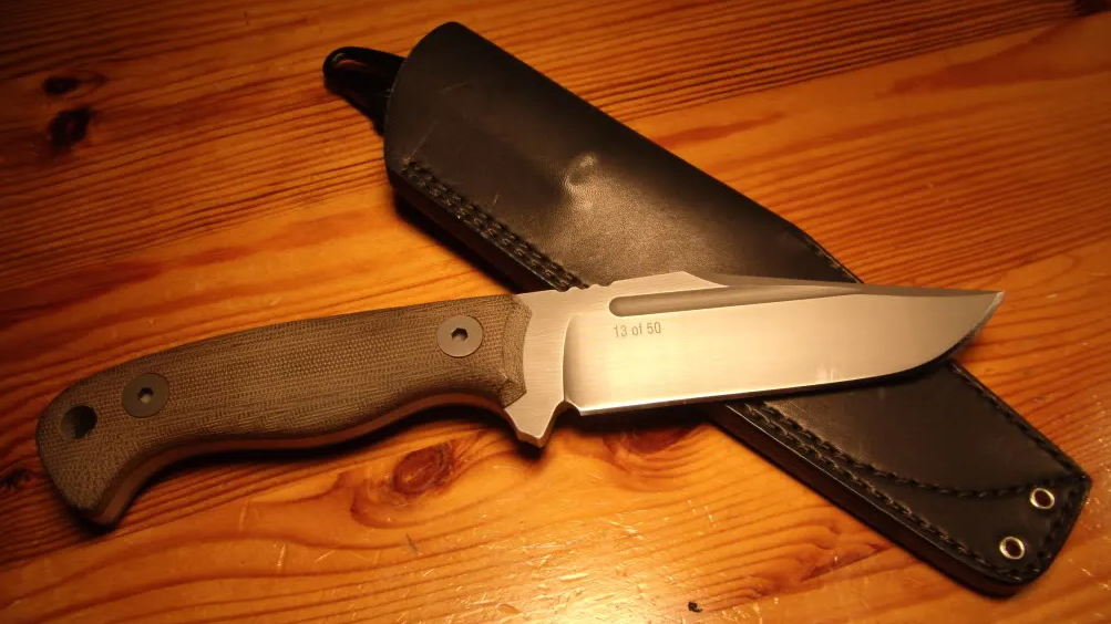

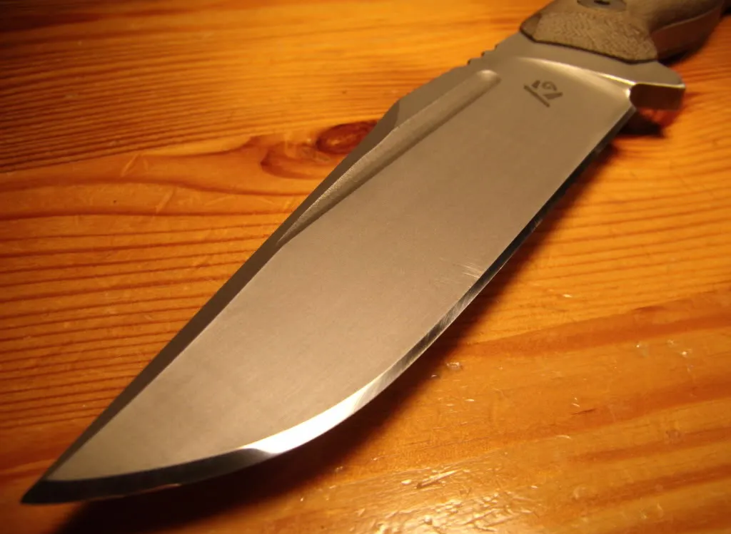

K9 Dingo from the first numbered series.
At the time these pics were taken (~2012) i had just started using it, after a bit of reprofiling on the Wicked Edge.
The CPM-3V steel sharpens easier than CPM-S30V and holds a razor edge noticeably longer.
For me it's a fantastic outdoor knife: neither too big or too small and built to withstand a thermonuclear war.
The only minor gripe i found in actual use is that the handle screws had a tendency to come loose with chopping, but some teflon tape on the threads made that a thing of the past.
Specs:
Overall length: 10.4 inch (26,5 cm)
Blade length: 5.35 inch (13,6 cm)
Blade thickness: ~6,5 mm
Steel: CPM-3V
Hardness: 60 HRC (Paul Bos heat treat)
Handle material: Green Canvas Micarta
Handle length: 5.2 inch (13,2 cm)
Weight: 319 grams
Sheath: Leather

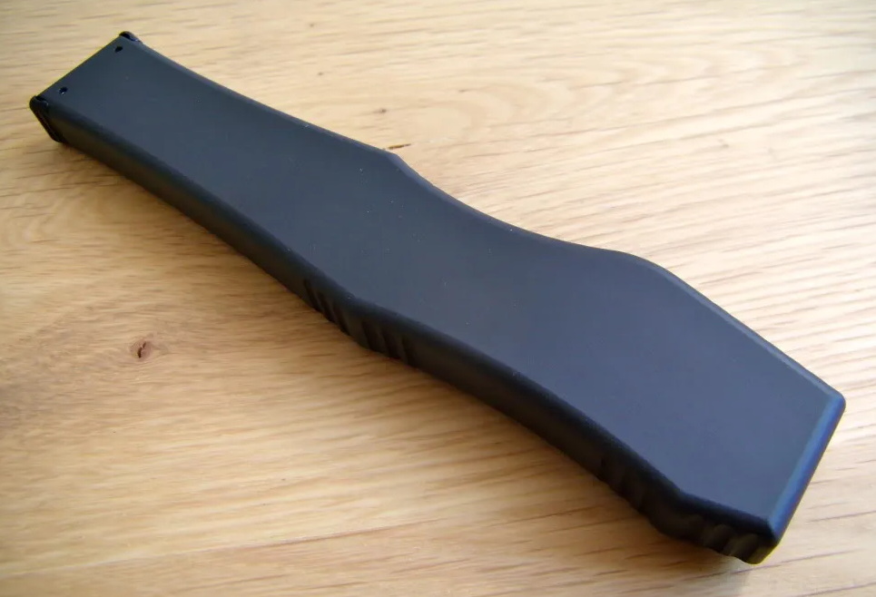

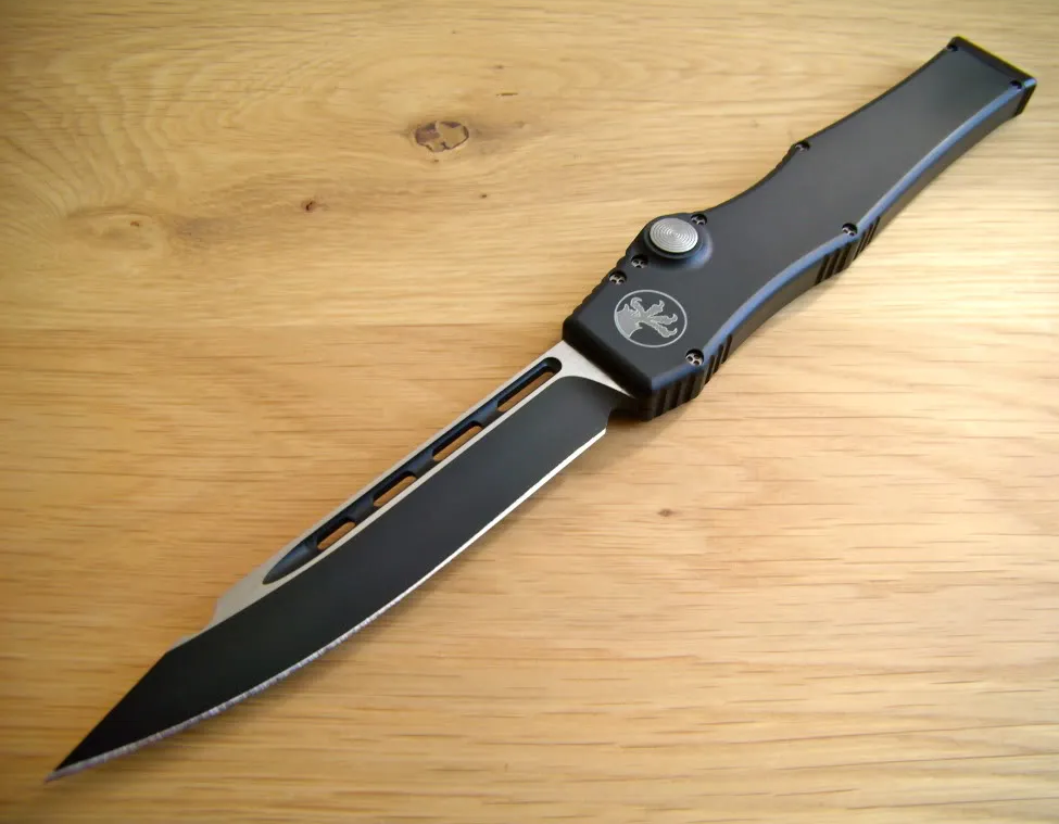

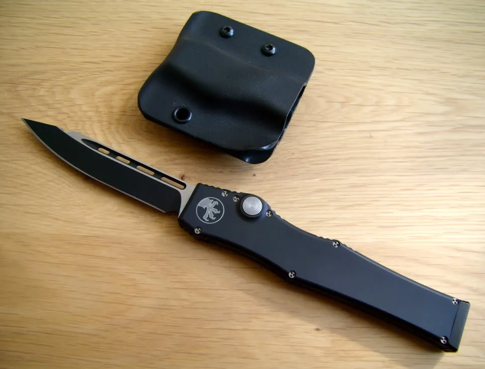

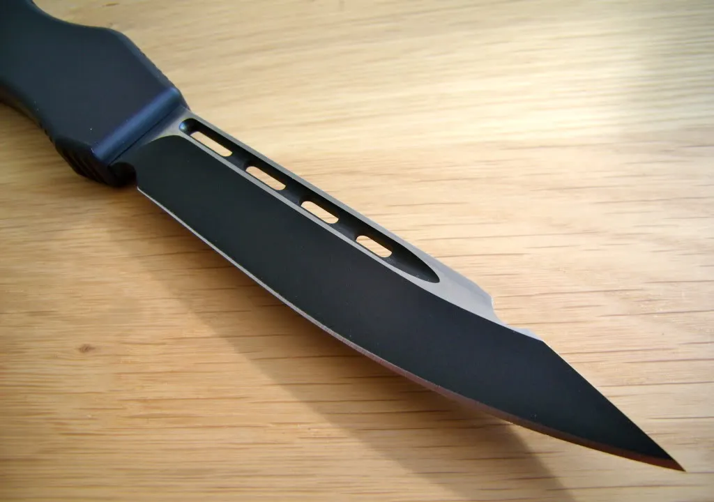

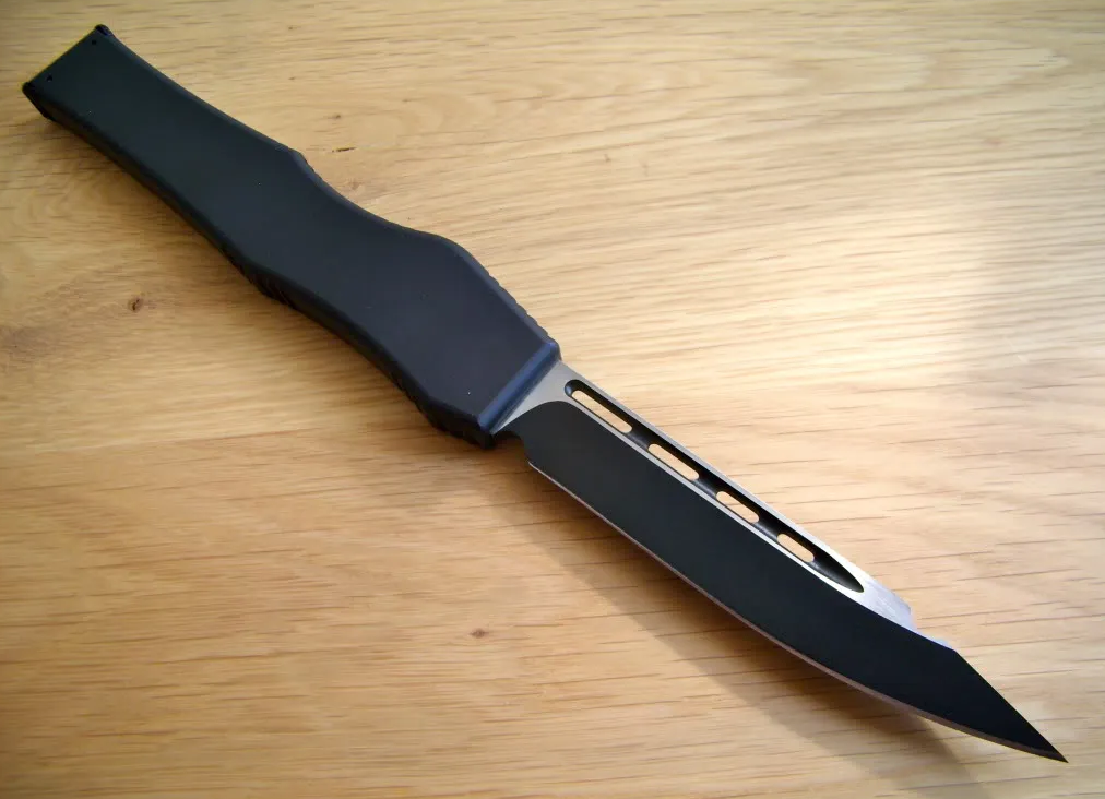

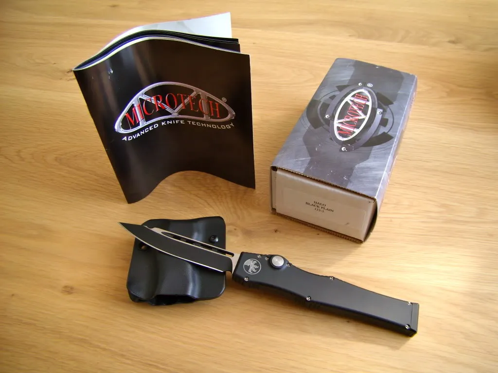

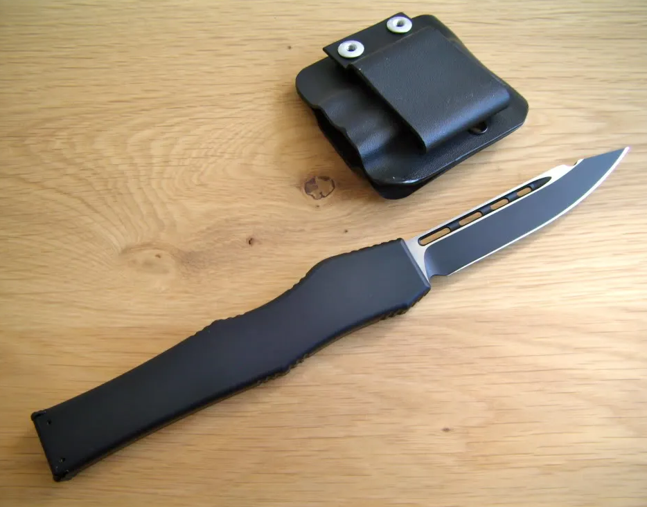

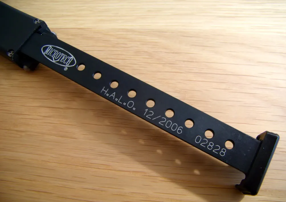

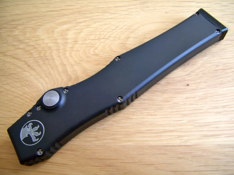

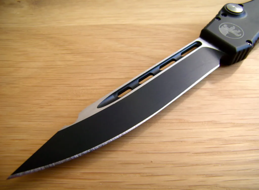

Microtech HALO 2.3 from December 2006
Hybrid single action out-the-front knife with blade from a HALO 2 & handle from a HALO 3.
Specs:
Single Action OTF
Action: Continuous propulsion compression spring
Steel: S30V stainless
Hardness: 58-59 HRC
Blade length: 4.0 inch (10,2 cm)
Blade thickness: 3,9 mm
Handle thickness: 11,0 mm
Handle width: max 1.0 inch (2,6 cm)
Handle material: Mil-Spec Type III hard anodized 6061-T6 aluminium
Length closed: 5.39 inch (13,7 cm)
Length open: 9.33 inch (23,7 cm)
Weight: 96,0 grams

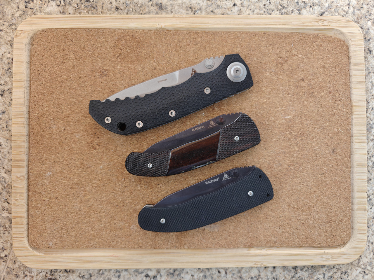

I love the Blackfoot. One of my all time favorites. Lone Wolf was an exceptional value at the time. I rehandled a few of mine. I've heard of the springs wearing out on the autos so the Eagle Talon doesn't get fired much, but it still kicks like a mule!
