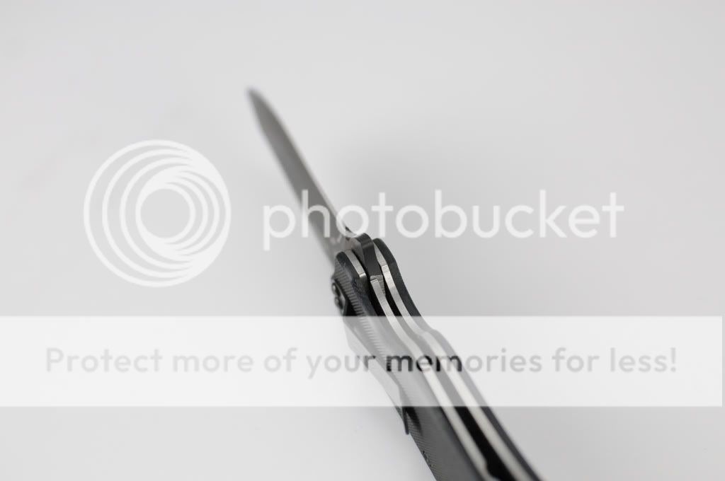

What is safe lockup for a 0350? Mine is about 90% of the lock is on the blade, which seems high to me.
Thanks! Now I feel stupid.Just so you know, most people don't measure lockup by how much of the tang is on the blade.... It's mostly measured by how much of the blade tang is covered by the lock bar. So, if the lock bar has moved half way across the blade tang, the lockup would be at 50%.![]()
That would = the lock bar all the way on the blade on a liner lock right?IMO 25% is perfect.I have passed on knives with more than that.

Here are 3 of mine with IMO near perfect lock engagement.The 0550 is really a touch more than in the pic.
View attachment 273388View attachment 273389View attachment 273390
It would also depend on the thickness of the lock bar.A Spyderco Military could have all the liner on the tang of the blade and still not be but about 20 to 25% across the blade tang.A ZT would only have part of the lock bar on the blade tang to be at 25%.
Each knife is going to be a little unique on where exactly the lock lines up because each ZT is done by hand. Here's a picture of a 0350 we had sitting around our office. This one lines up right about 50%, though I have seen many that are significantly more or less that are all stable and work great. You can see in the pics posted by u812 that there can be a bit of a variance.
As the knife gets used more and more, the liner will wear on the blade a little and you may see it change over time. If you ever feel like yours isn't locking up right, give us a call!
