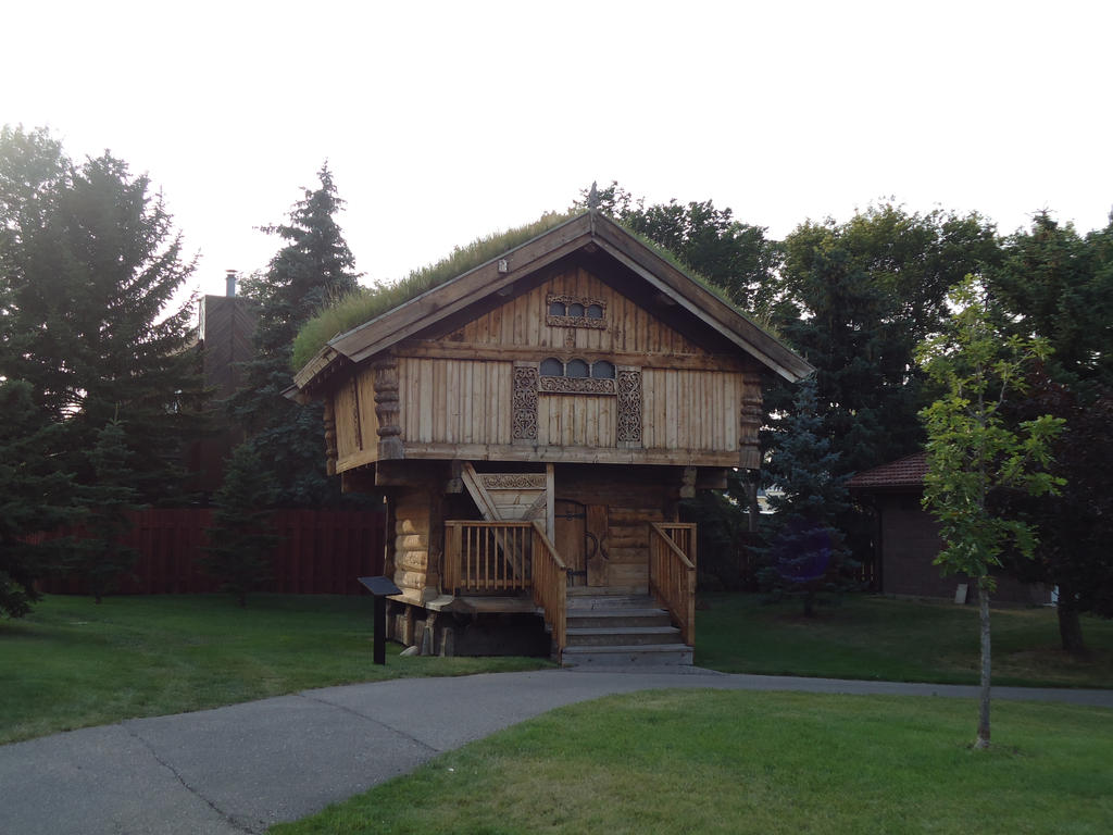

His cabin looked like this (no sidewalk)
with a roof like this
He cut a rafter dragon head inside with his chain saw. Gotta like those Viking cabins, but I don't know about mowing the roof . . .
Hah be my luck I'd fall off while mowing! but very artistic and serene looking, I like it, thanks for sharing!
