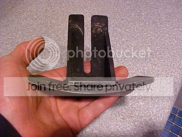

I been hunting high and low all over Thailand to find myself 10" and 12" wheel which i can convert into grinder wheel .
example i had look at heavy industry wheel . with P.U coating .
most of the problem i face is that the wheel is only 51mm and the surface is not flat . with both edge bevel . -
and also i am not sure if such wheel is round .
i am considering making my own wheel . in the 10- 12" range .
any suggestion on making your own wheel an how to do it so i can cut down cost or make a good wheel .
or any parts from cars or industry parts which can be use to convert .
i had been looking at diamond grinding wheel but their usally only 31.5mm across making it too small .
A cheap and easy fix is to make a curved platen like this one, it's the same as grinding on a 14" wheel.
Richard
here's a 24" (23.5" actual) wheel I made out of a half sheet of 1/2" hardwood plywood, cut into 4 - 24" squares. I glued and screwed the 4 square boards together, found center and drilled a pilot hole, used a 12" long string and struck the arc. Cut out the arc on a bandsaw, you can use an old truck axle for the bearing and hub to bolt the wheel to.source your bearings and motor and stand and you can have as big a wheel as you want. I use 2" shop roll abrasive held on with feathering disk adhesive and a taper pin you can see in the pic. Once running you use a wood lathe gouge to run it into true. I use a 3/4 hp 1725 rpm motor reduced 5:1 to produce 355 wheel rpm = roughly 2200 surface feet per minute

Using a curved metal platen is just the same as using a flat one, they both get a little warm when you are grinding.
