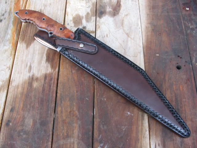

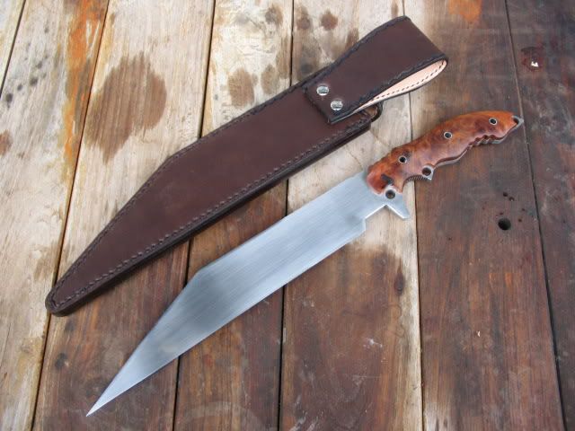

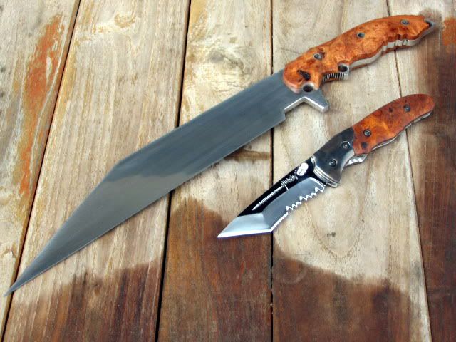

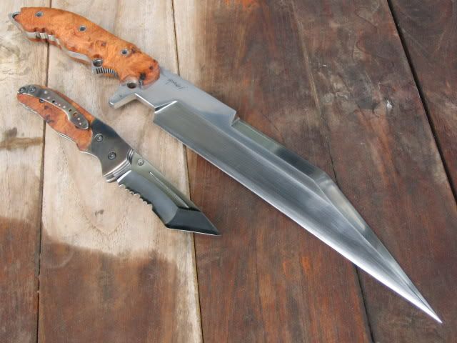

Hi all,
Thanks a lot for interest in Zombie.
Now It's finished . The spec is:
Blade steel - DC53 ( D2 modified ), hand rubbed satin finished
Blade length - 10.5", chisel grind , double edge and zero edge
OAL length - 16"
Wide - 1 3/4" widest
Thickness - 1/4"
Handle - Burl of Maka wood and ergonomic design
Heat treatment - Double temper and sub zero quench

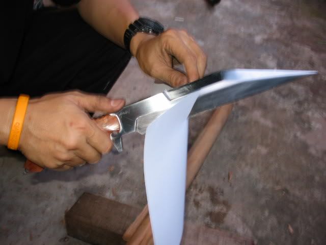

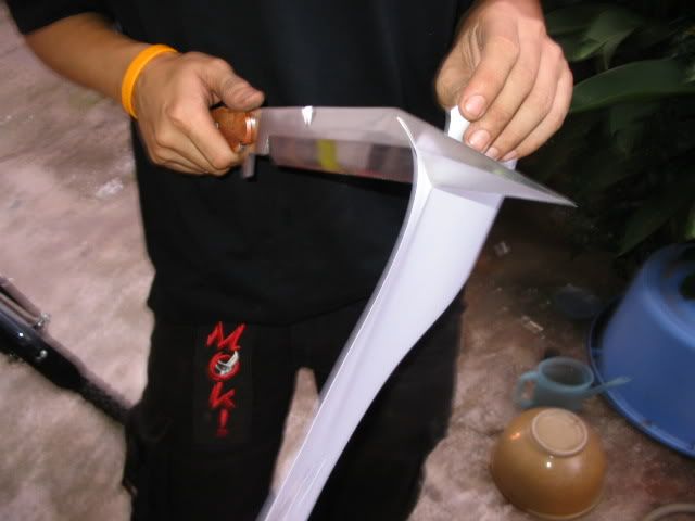

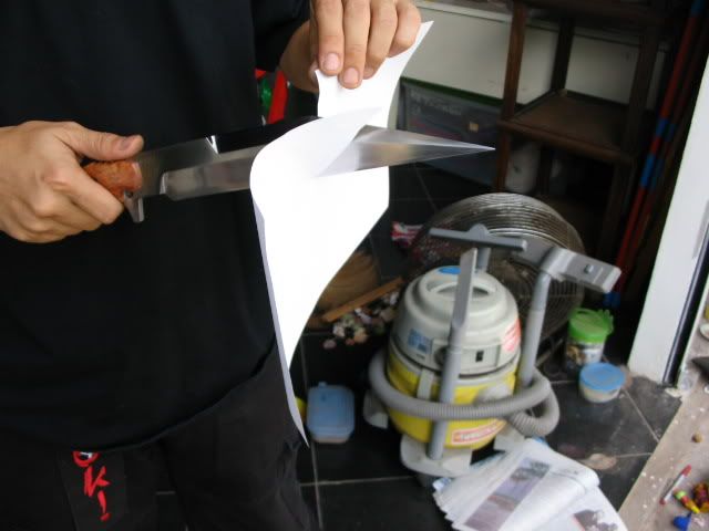

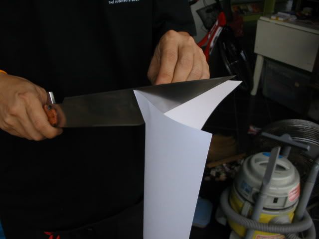

1. In Zombie I sharp the edge to scary sharp! I test the both sides edge by paper.

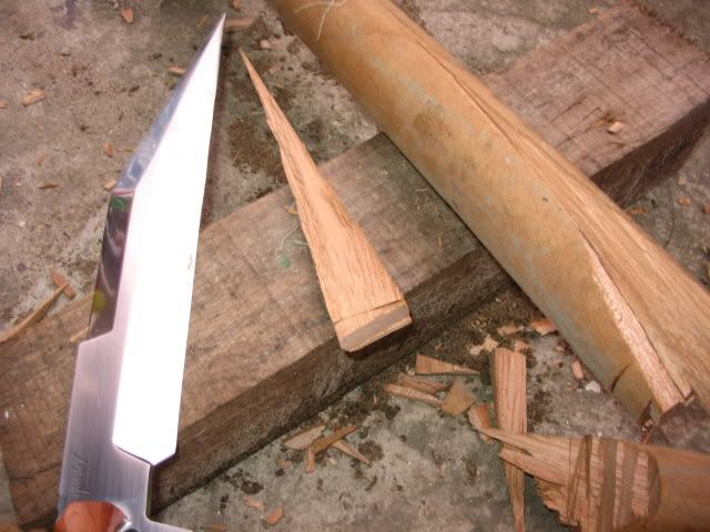

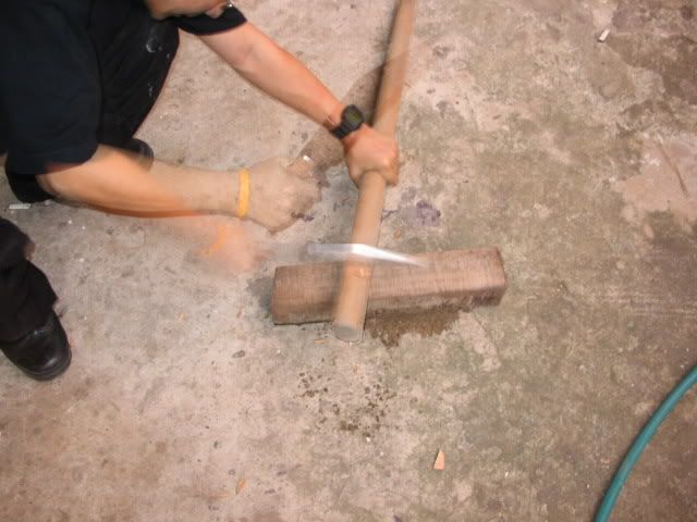

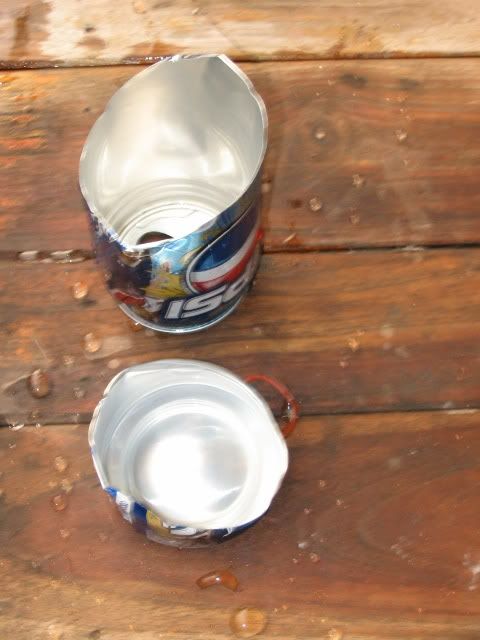

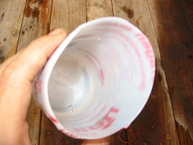

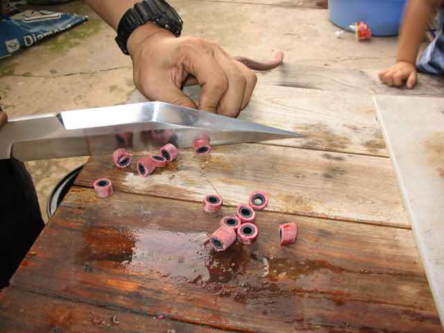

2. Can and Bottle cutting. It's very clean cutting.
