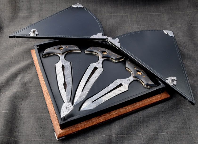

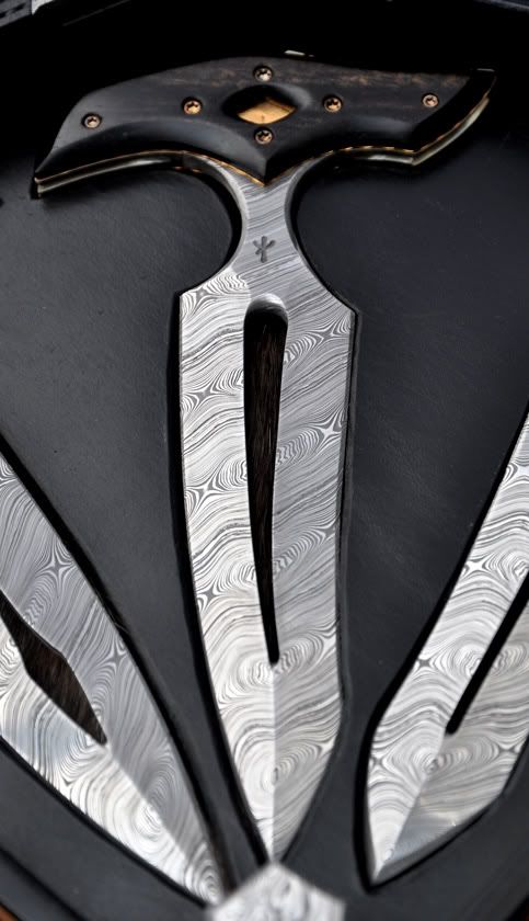

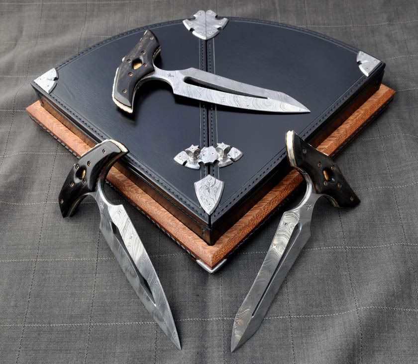

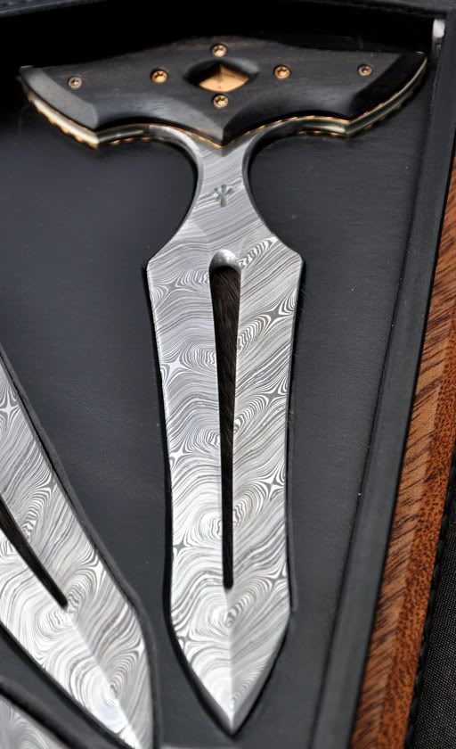

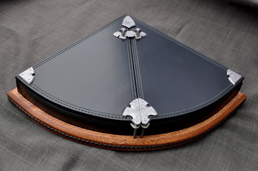

This set has been in progress for quite a while now, it has taken me more time than I planned...
But the daggers and the box is just about done, just some minor tweeks left, like aligning all parts on the lids of the box.

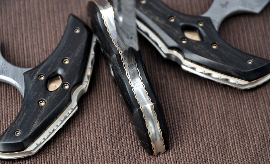

I am also considering heat-coloring the torx screws in a bronze hue.

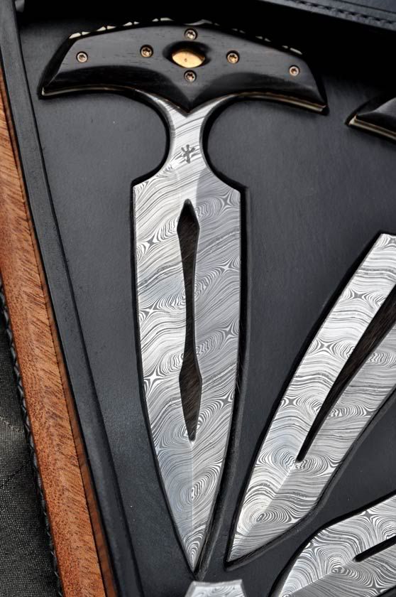

I still need to sharpen and polish the blades.
The blades are made from Damasteel. Handles have fileworked centerpieces of nickelsilver, fileworked bronze liners and striped ebony scales.
I went a little overboard on the box perhaps, but one of the daggers is my 100th knife so I thought it be nice to kind of celebrate that fact!

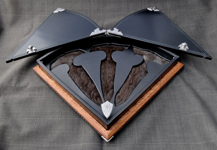

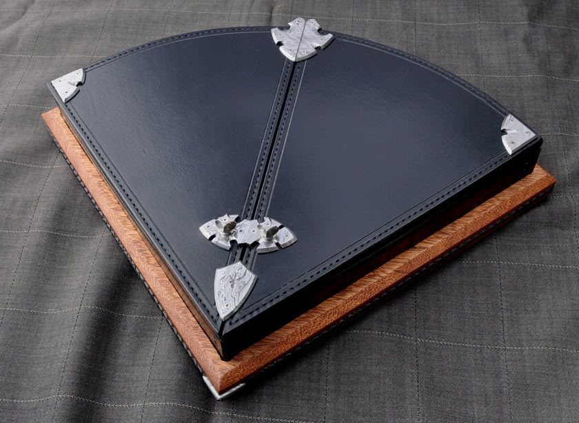

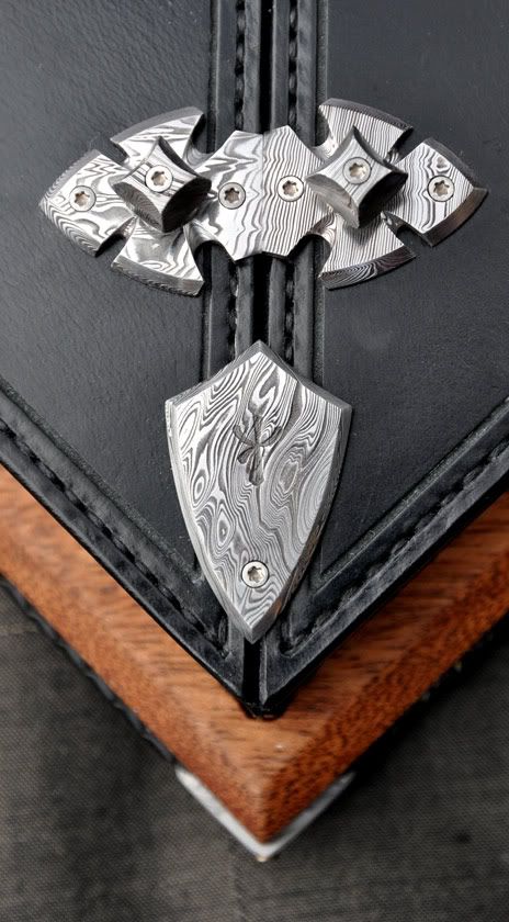

The base of the box is made with Teakwood (I think). I cut the grooves in the wood for the walls and the braided leather by hand with my dremel. All metal details are made from Damasteel except for the posts that hold the lids, they are carbon steel damascus.
The "knobs" used for opening the box are mounted on small rare-earth magnets that can be seen in the pictures. But there are two more (on each side) countersunk into the leather beneath the bases of the knobs to enhance the slight snap you get when closing the lids.
The lids and walls are lined with thin black leather and the daggers rest on harefur.
This box need to be seen as these (quick) pictures don`t do it justice.
What do you think?
Thanks for looking!
