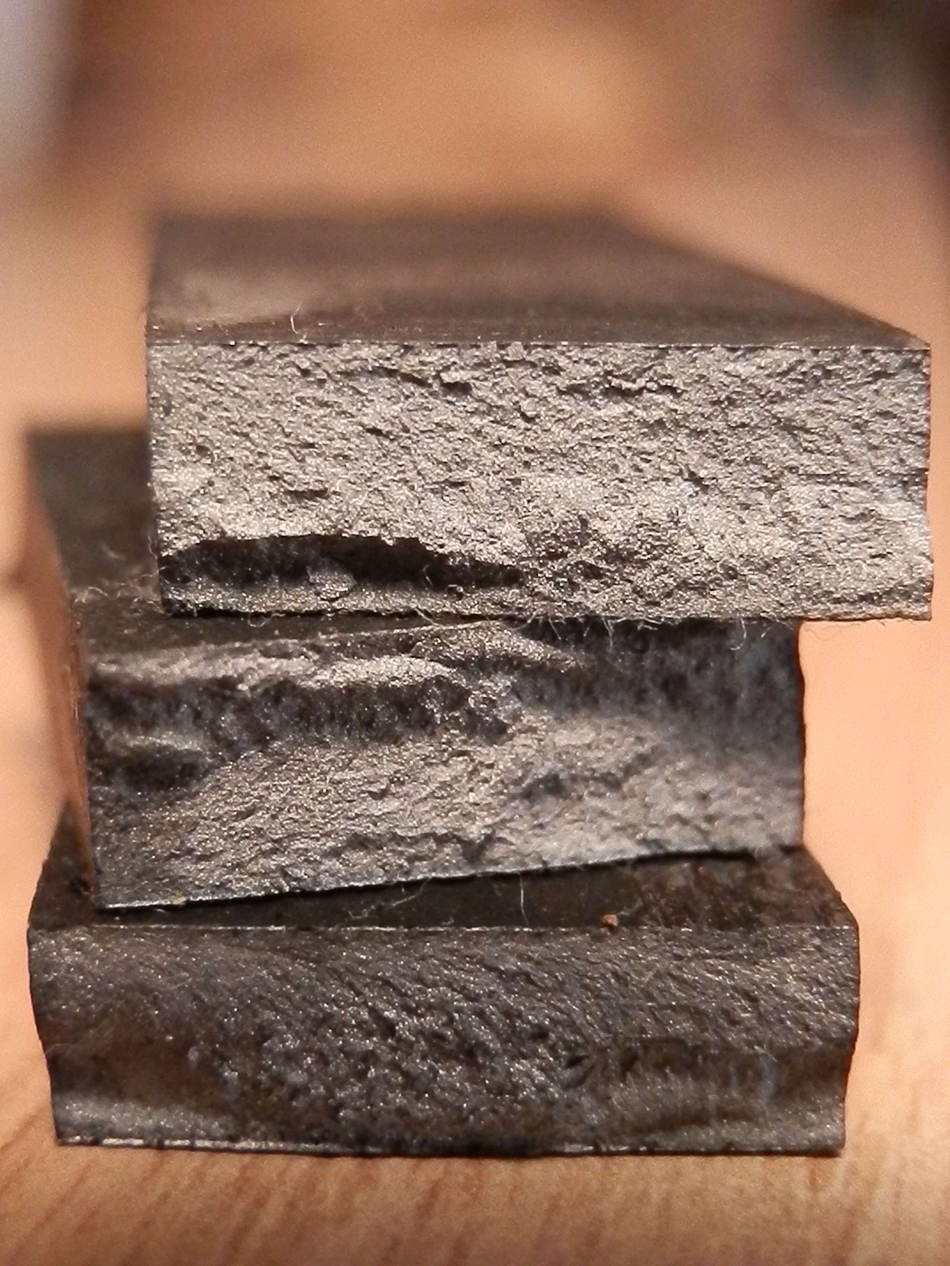

Hi guys. for a long time now i was trying to buy good quality 10xx steel in Poland (hard to get it:)) to try to make nice hamons. Finally i've managed to buy 1075 steel and even with quite high content of Mn i got some nice hardening lines on sample knives. The problem was the grain size. I do not know if the rules that i used for other steels (high alloy) are the same for 1075.... I've managed to reduce grain to pleasing size but i was using triple quenching process...
I would like to know if there is any other way to do that, maybe not involving quenching, as i would like to avoid unnecessary stresses. Or if using triple quenching how to optimize this process...
Please help. :) Maybe you know some good ways to reduce grain size in 1075 steel.
It would be very helpful:) I'm using electric furnace with automatically controlled temperature.

This are some test samples after only one quenching without normalization and before tempering.
What do You think about this grain size?
Samples are 6mm (1/4 inch) thick, made by one powerful hammer stroke. Slightly smaller grain size for normalized samples.
Regards
This grain size looks too large.
Try sampling grain size after the (1+3=4) descending normalization cycles, and an 815C austenize/quench.
Grain size should be significantly smaller.
John
John
Yes I thought so. I will try to do as you suggested. 4 normalization cycles and quench. Hope for better results. Thank you.

Hi. Still no good results with normalization. The grain is slightly smaller but still to big. Is it possible that the fracture view show something else than the grain size, that is somehow caused by for example way of breaking or something of that kind?
Or maybe the steel should be somehow HT before normalization process - maybe annealed somehow...
On one sample (normalization followed by double quench) i had big difficulty to break it, and i had to hit several times. Part of fracture there had really nice grain and other part just next to it (broken somehow in different direction) had much bigger grain... no transition, the boundary was the edge between cracks made in the different direction. What could be the reason of that?
Another strange thing is that it was definitely harder to break normalized and double quenched sample than normalized and quenched only once .

About your problem, what has created the coarse grain in the first place? What have you been doing to the knife prior to your heat treatments? I've never used 1075 from Poland, but I have investigated 1.2842 (O2) that I buy here in The Netherlands, my fist analysis tell me it has a really nice fine grain straight from the steel plant, ~ASTM grain size 10 but i'm not 100% confident about that jet.
Anyway, about your testing, I wouldn't do breaking tests on quenched (martensite) test samples. Untempered martensite will always break easily. I'd rather do tests on pearlite only, in other words in a normalized or soft annealed condition.

The samples on the picture above are made just form flat bar (no forging, grinding etc.)
I've seen your thread on BB and i was wondering if the fast temp. change due to forced air flow wont affect furnace materials.... don't you afraid that it can be damaged this way?
Also could you share some more info about normalization process that you used? Austenizing temperatures and soaking times for both high and low temperatures?
Your sample after normalizing looks like it have quite big grain as well, did you managed to reduce it size even more?
All the best
So far my oven materials don't show any weird reactions so I think it will be fine. The size of the broken sample is 10mmx2,5mm, so small stock and a magnified photo. I had to beat like crazy to break the normalized piece, and it bent more than 45 degrees before breaking. I did 4 normalizing cycles, so I could do more for finer grain, but the initial grain was extremely coarse. It was like sugar.
You can get your own times and temperatures from the 1075 CCT diagram. For O2 I do the following: preheat oven to 810 degrees C, soak 2 minutes (2,5mm stock, thicker might need a little longer), cool down to 550 in 2:30 minutes, faster is better but, the important factor is to not get below 500, forming bainite. At 550 I soak until pearlite transformation has completed, you can read it from the diagram, in my case I soak at 550 for 7 minutes. It's a bit longer than necessary but I like to be on the safe side. After transformation completion I ramp up again, as fast as my oven will allow to 810 and repeat the process.
