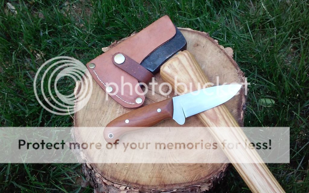

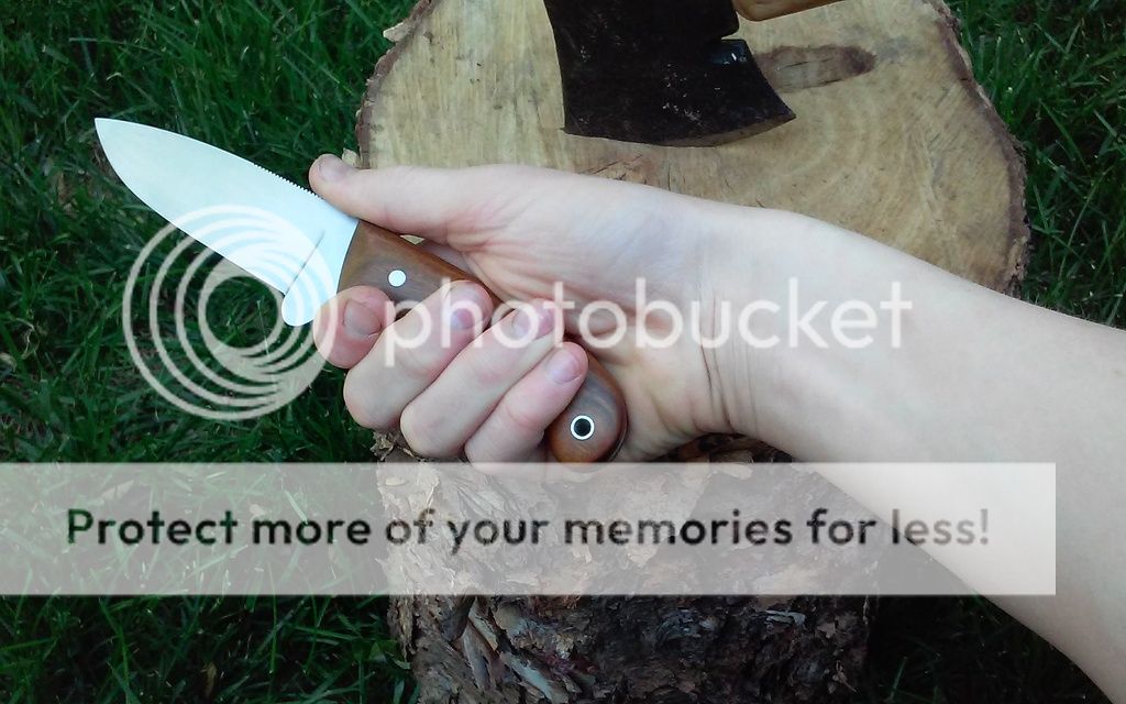

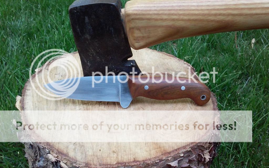

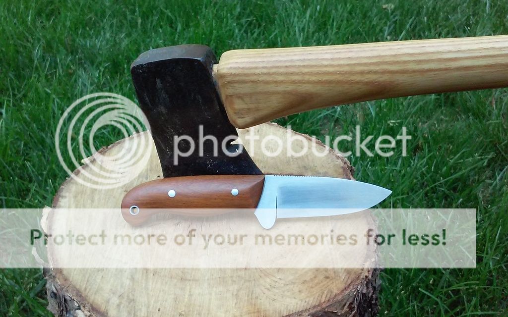

This is a drop point hunter for my Uncle that I just finished up Wednesday. It has taken me a while to finally finish it but here it is in all its glory ;)
Specs:
-1080 High Carbon Steel
-Heat treated in my shop to around 56-57 RC
-high flat grind
-400 grit Satin Finish
-20 TPI jiimping
-Lignum Vitae handles taken to 1000 grit and finished with a coat of Boiled Linseed Oil
-3/16" pins and 1/4" lanyard tube
-Nice "CC" contouring as shown in the pictures-very comfortable IMHO
-Will come with a chocolate brown leather sheath with brass hardware.
*Note, knife is not yet sharpened for safety reasons-getting cut making a sheath was not fun...not gonna make that mistake again*
15 year old hands make this knife look big huh ;)
Thank you for looking, I appreciate and feedback and advice!
