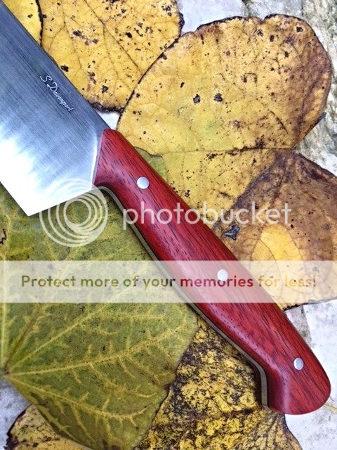

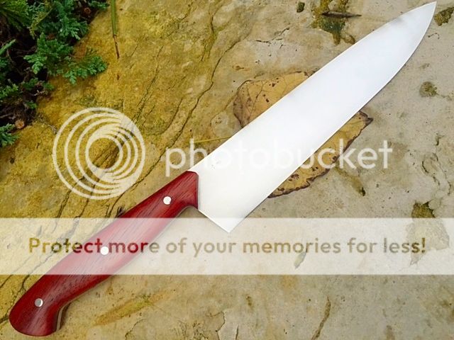

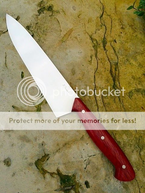

A very good friend of the family in Del Rio asked me to make them an 8" chef's knife. Being an extremely competent woodworker, metal worker, flint napper, and engineer, he wanted to supply me with some wood he had. What a gift. He gave me a box of Padauk, Purple Heart, and Mesquite, with instructions to use the Padauk scales that he had cut for me. I've never worked with the Padauk, but fell in love with it as well. Love the color, wish it wouldn't get any darker, but from what I gather, it is inevitable. Anyway, hope you enjoy! 1084 from Aldo, stuff with the "V" for "Vine" grain! Ground thin at the edge, of course! My name on the left side, and "1084" on the right...in case you were wondering what that was.

Matt, I did use oil. But the Padauk didn't want it. Seems like it took maybe two thin coats of Danish, then when I tried TruOil/Min spirits cut 50/50, it took 5 days to dry, and was still slightly tacky. I put a few layers of wax on it, called it good. Before, took it to 800 grit, then polished it with simple metal polish and it took a cool shine. Polished again after the oil even, then the wax. I think it will hold up OK, especially knowing who it's going to.

1-3 coats of danish oil wet sanded into the wood is all it usually takes. If you over oil it, it will weep for months.
