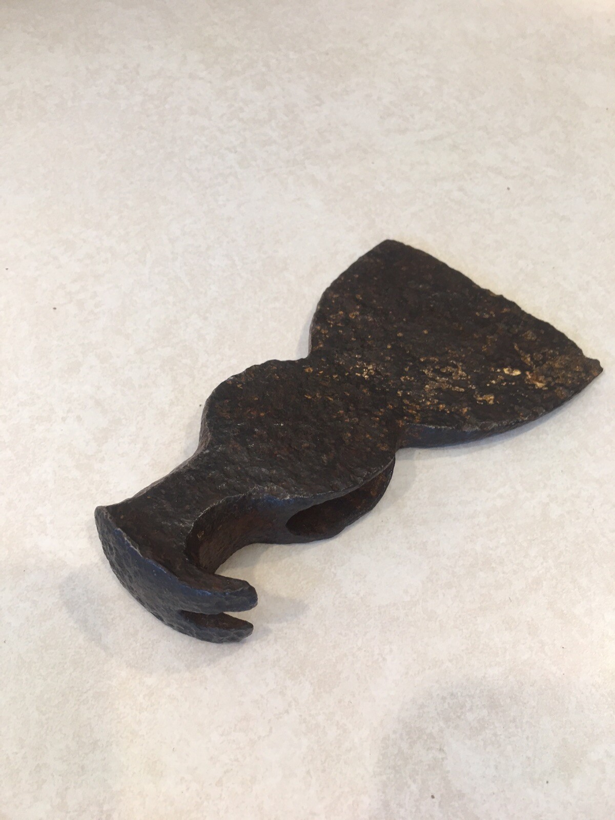

Maybe a claw hatchet (like the one shown below)?
