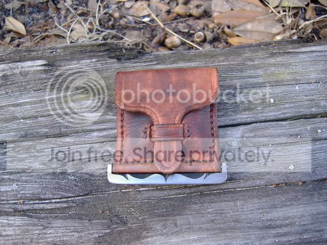

How much, if any, would a temper of 300°, or 325°, affect the hardness of 1095 that was water quenched from 1500°? Would a low temper heat as that make it at least slightly less brittle? This piece is 1/4" x 3/8" x 3"
The only thing I noticed making strikers with 1095 is that you get many more sparks if you leave the steel as hard as possible....untempered. You could try putting one in the oven for an hour and see how it still sparks from there though.
Yeah, that's been my experience also, but I broke one today that had nice decorative file work on it, and was curious about a very slight temper to possibly help a little without sacrificing spark. I was making a larger version of this.
