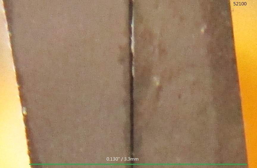

here is awesome grain size:D
which I noted after this camilus/kabar/becker broke. 1095 crovan
here is a buck hoodlum fail. Look at that grain 5160. Goes to show you can screw any steel up.
Here is small grain (tempered) but plate martensite, hence non-jagged broken face. It looks fuzzy because it's very smooth/silk in real life. * note * - as quenched martensite shows grain & grain group/cluster broken interface much clearer.
problem is there is no way for an individual to know without breaking the knife. I have seen this large grain in many high volume production blades I have broken over the years.
If you want to see fine grain, break a HSS mill or drill bit. It makes that stuff above look like gravel.
