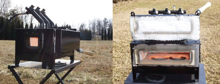

Hi so I am making my own kitchen knife out of 1095 steel, and have a couple questions regarding heat treatment.
This is my first time heat treating myself, but I do have access to this forge http://www.piehtoolco.com/contents/media/nclb-oelowboy75e.gif . I practiced on it earlier with some 1095 scrap pieces. I was suprised at how fast the metal got hot, but I took it too non-magnetic, then tried to hold it at that temperature but I think I took it past. The tip got the hottest, and started to flake/lose scale. Is that bad? Finally, I quenched it in vegetable oil, and noticed the part that was losing scale had spots, whereas further in (where it got less hot) was all black.

If you can't at least measure the temperature in your forge I think 1095 is the wrong steel to be using. Can you add a thermocouple so you know what's going on in there?
There is a thermocoupler on it, but it's for the igniter. How would it measure the temperature? And is it possible to slow down the gas supply so the forge won't get hot super fast?

1095 is a bad choice for a beginner with limited equipment to HT themselves
1095 is "Hypereutectioid" and needs precise temperature control and proper fast quench oil Like Parks 50 or Houghton K
