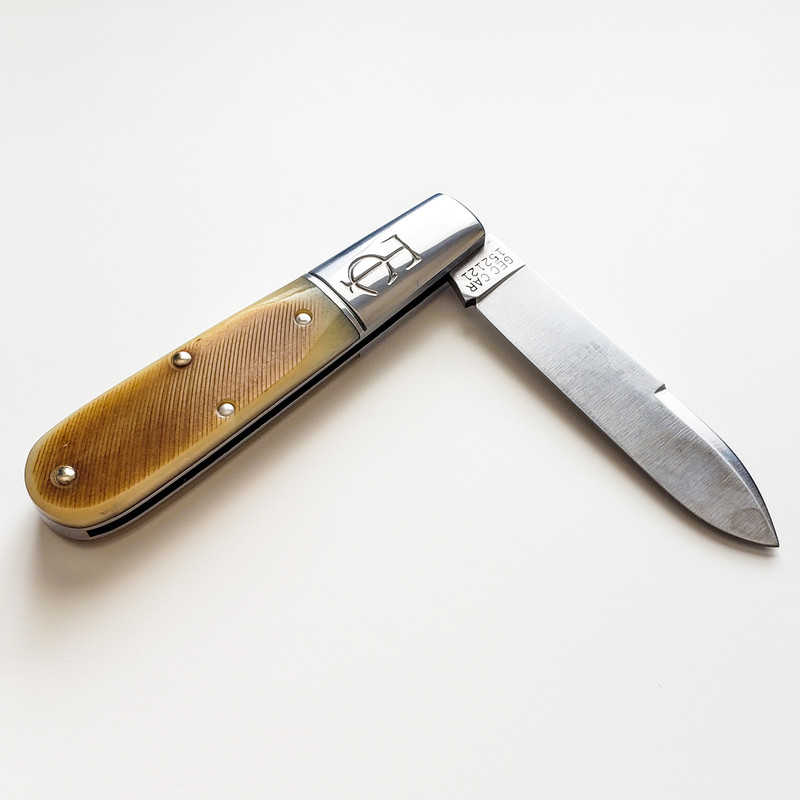

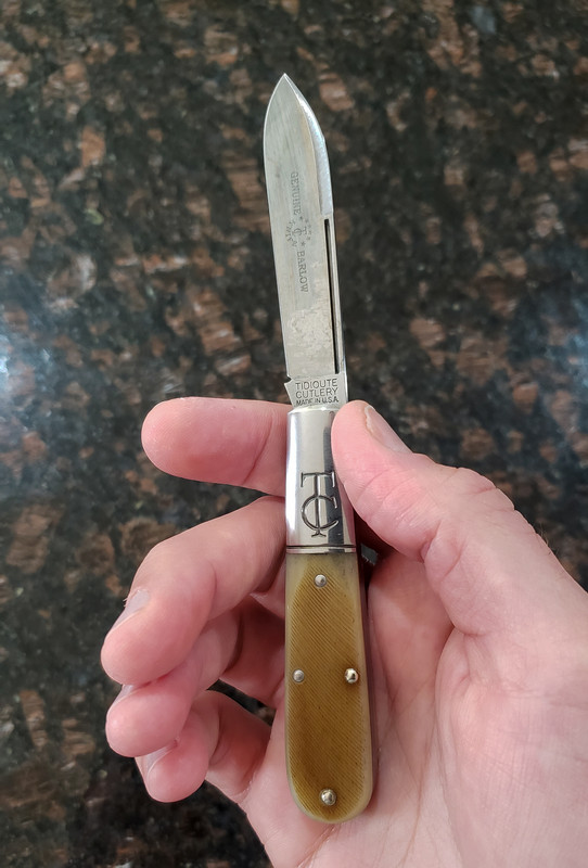

I broke in my TC Barlow today by cutting up an orange and it started a nice brown colored patina. I've seen pics on here where people have multi-colored patinas that are blue, purple, and black. So I was curious if you all know what types of foods or other things create certain colored patinas.
Also please post any 1095 patina pics you have here!

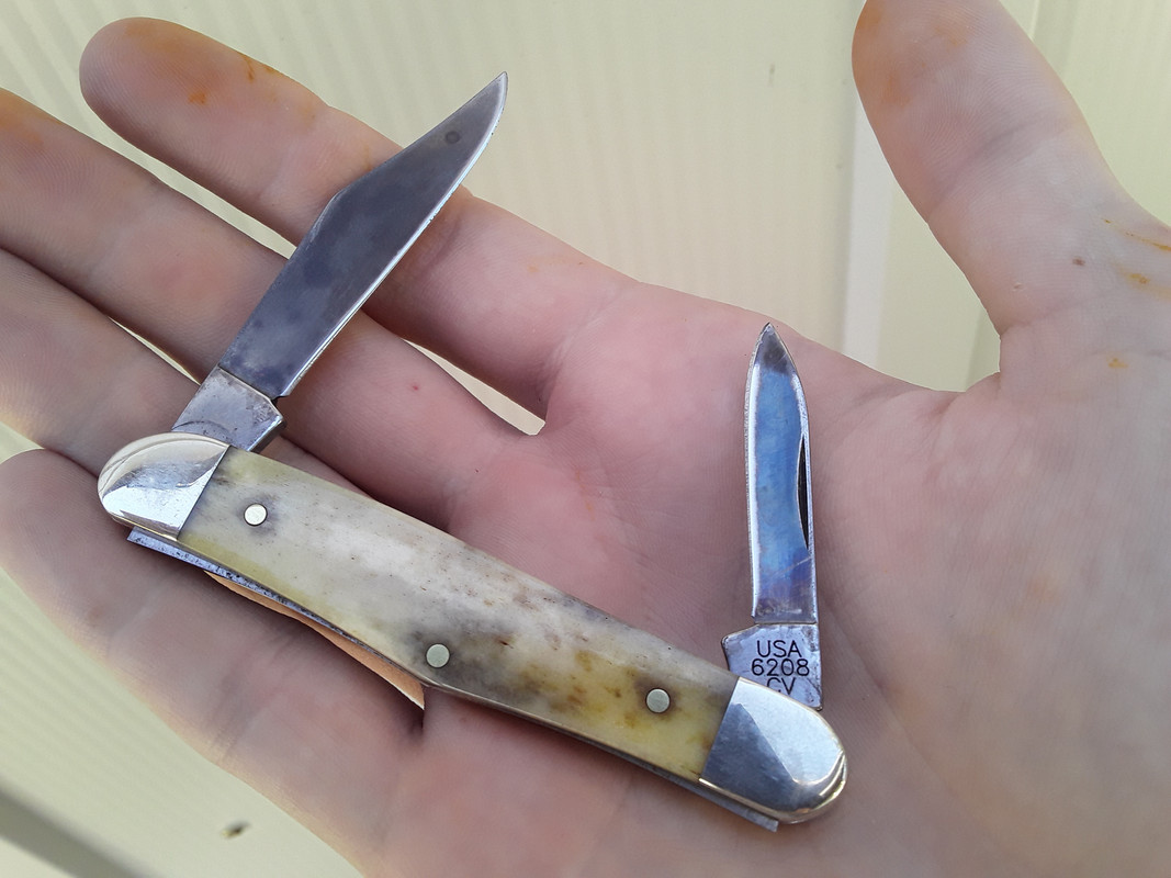

In my experience, the color of the patina is related to how deep the oxidization goes and how old it is. Doesn't matter what I cut - meat, fruit, whatever. The fresh patina will be that rainbow smattering, and over time the more patina I add (the more layers of oxidization that accrue), the darker it gets until it turns that grey/"black". Might also be related to other minerals in the meat or fruit juice.
A metallurgist would have to comment on this, but most metals are crystalline solids, and so we could be talking about different angles of the surface being oxidized on a very small scale, which would impact the color of light we see reflected on the blade. I further suspect something like this, because the *seen* color of the patina will change by applying some oil to the oxidized blade, or vis versa cleaning it off.
Acid soaks and ferric chloride can produce dark grey/"black" patina quickly, but those tend to be much stronger in concentration and oxidize more quickly/deeply.
Also, polished blades seem to take on a more brilliant rainbow at first than satin blades do.
I believe I had cut something spicy with this knife to get those darker splats on the top layer (spicy = acidic)

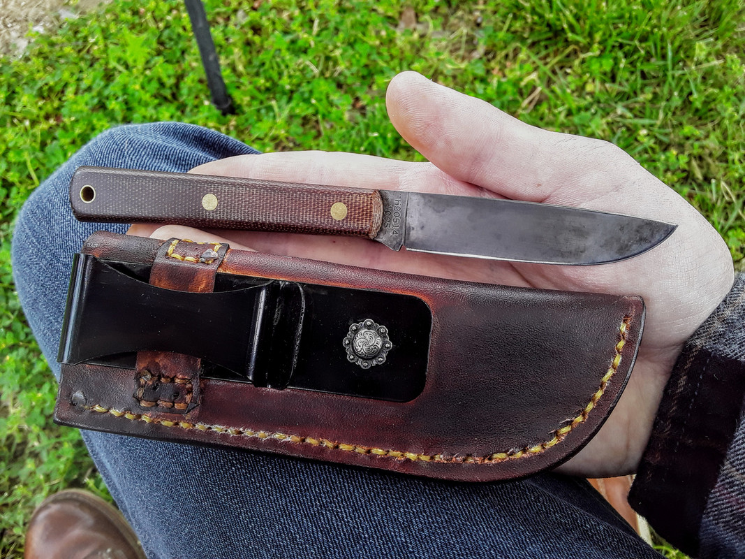

I like an even gray patina. That’s just me. At least that is how I like carbon to start out. I usually wipe the blade with rubbing alcohol then get my tap water scalding hot and hold the blade under it for a minute or two. Then I rub a cut lime or lemon (I have lots from yard trees...) on the blade and voila. Here is my latest in 1084 (close to 1095 sorry) to share1C23FCF5-4DF0-4FFF-81F0-F3A35EF28015.jpeg

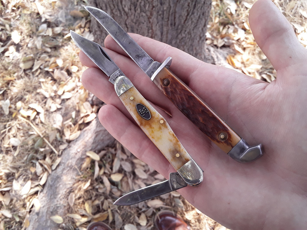

The blotch near the tip in the image below was from a little drop of orange juice being on the knife for a few minutes.
