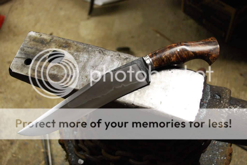

I've been forging some larger, chopper blades lately and thought I would share one with you guys. Ive been forging for about 2 1/2 years, and I haven't posted much here.
This one has a 9 inch blade of Aldo's 3/8" 1095, stab. spalted maple handle--a little over 5", stainless hardware.

OMG - That is a freakin' nice one! I like everything about it. The wood finish looks awesome :eek:
(nice anvil - a Peter Wright? Had it resurfaced?)
Thanks, Yeah it's a 103# P.W. that a guy gave me. I knocked a little off the top with a surface grinder--it had a lot of small dings and knicks.

Tad, that is the She-it! I like the finger guard configuration. I love that knife! What finish did you use on the maple?

It is stabilized, so I sanded to 800 grit, and lightly buffed with white compound.

Whoa, now that's what I'd call a chopper. Very nice work ! I really like it.
one of the best handle shapes on this type of knife I've ever seen. A little too polished for a working knife, but that's ok:)
Did you use a ferrule, or is that a bolster type thing? 3/4 tang by the looks of it? Balance just in front of your mark or so? Any idea on its weight?
I like everything about this one. I can feel it in my hand, even though it's not.

It is basically a stainless spacer, not a true ferrule. The tang pretty substantial--thickness and height--at the spacer. Hidden tang construction with good tang length. I am not sure of the weight or exact balance point(I'm not at home), but it is .372" at the spine with a very gradual distal taper, so it's very blade heavy.

Yes, it's a hamon line from clay quenching.
