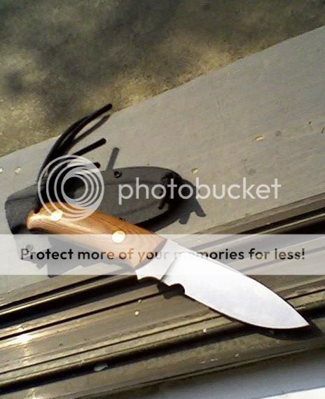

Gotta chime in here. I make most of my blades from D-2 and the facts are that comparing D-2 and 1095 is apples and oranges. D-2 is far superior if HEAT TREATED PROPERLY. As for the cracking during winter time use that's ridiculous considering that most makers use a cryogenic temper where the blade is brought down to -100 degrees.If that don't crack it then skinning deer in the North American winter sure as hell won't. I make everything from patch knives to a 8" blade chute knife that will hack through 2x4's all day and the edge won't roll chip or crack. It's all about heat treat and proper edge angle for the job. And next to Robert W. Loveless, Bob Dozier is the man.
