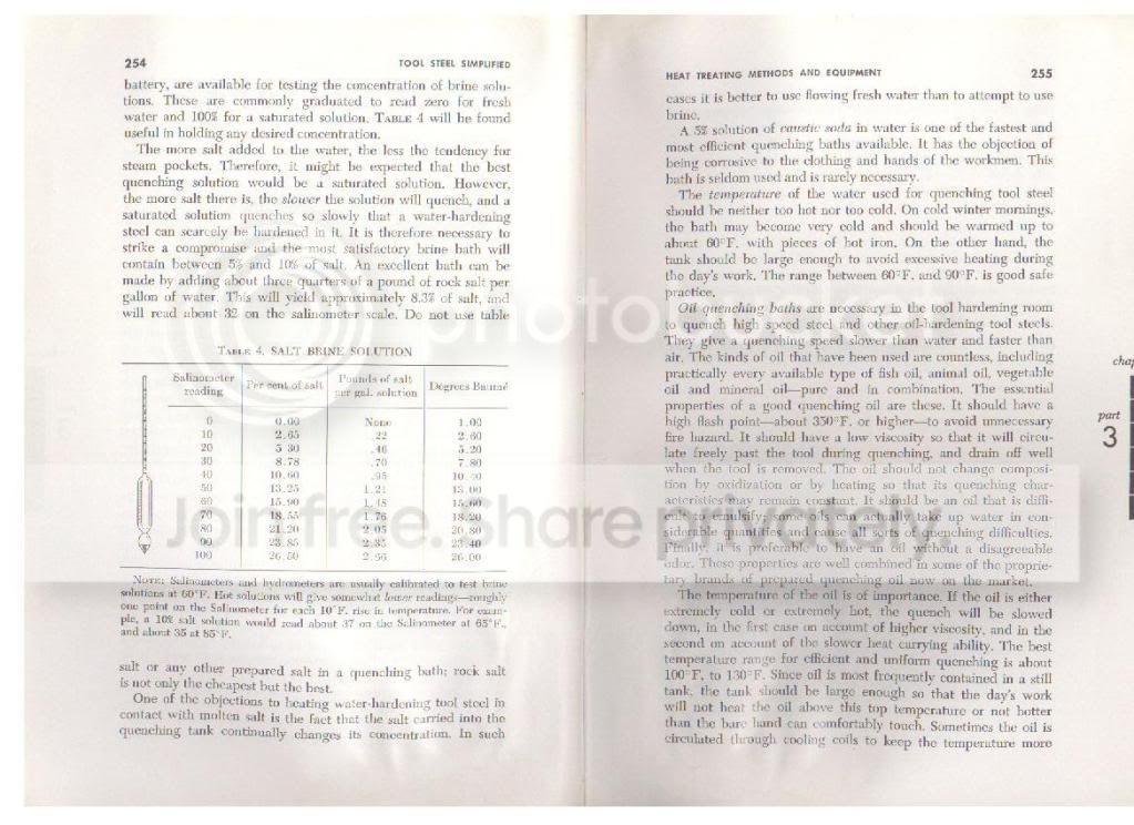

Here's something to add to the confusion :D. The title of this book is "Tool Steel Simplified" , by Frank R. Palmer and George V. Luerssen, published by the Carpenter Steel Co. This printing is July 1968. I hope the attachments are readable.
Why does that add confusion ? The only thing missing in that is a discussion of agitation which you makers should ALWAYS do !!
But mete you would be astonished at the number of makers who do not. Another old bladesmithing myth that refuses to die is that agitation causes distortion (yes, improper agitation does), this is another one of those points that will often get us techno-jerks the standard answer "why over think things, I've been doing it this way for years and it works fine":rolleyes:(I wished I had the head bang emoticon here). Not everybody can set up water jets or J-tubes, but anybody can keep the blade moving in the quench. Water based quenchants may not matter as much since I am not sure if we can move the blade enough to evenly kill that vapor jacket, but oil is not only a breeze it is vital.
It did warp but only a small amount. The file skated over the edge along the whole cutting edge so that part was good. The weird thing is that the spine and about 80% of the blade behind the edge was soft. You can literally scribe most of the blade with a carbide point right up to about the last 1/4" from the edge. You can almost even see a hamon line which was totally unplanned.
That is exactly what happened the first time I quenched 1095 but I was using a sodium hydroxide solution and just dipped it in and pulled it out as fast as I could. I should have left it as it was because I ended up cracking it and the next two blades.
I need to correct something from earlier. The reading on the salinometer was 70....not 70%. According to Keith's post of the book, that is about 28%. I guess the two variables that I would imagine would've caused it to not harden the most would be the salt content and the brine temp. I guess I can be edgeikated aphter all. Thanks for the replies all.
