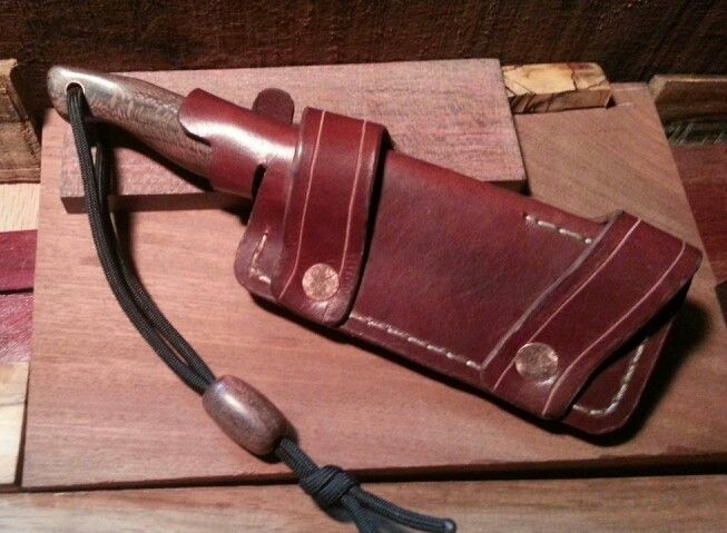

This project meant a couple of firsts for me, one being copper plating with copper sulfate solution to make the snaps I had match the copper rivets on the sheath. It seemed all the copper snaps I could find elsewhere were antiqued or had some sort of pattern on them. And second was the copper rivets themselves. They like to bend and move while being peened, so they did crawl a little in the leather, but not enough to cause any issues.

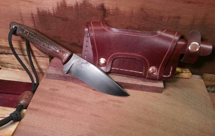

The steel is 3/16" thick 1095, flat ground, with a bit of a unique HT. It left a nice hamon diagonally across the upper blade and ricasso down to the choil. See below for my curiosities about the HT... The blade is flat ground. Measurements came in at 8" overall, 3.5" blade with a 4" cutting surface. Blade is about 1.25" wide, and handle a scant 1" wide. The scales are dyed and stabilized fleck sycamore. They resemble brook trout skin to me, but I fly fish so... The pins and lanyard tube are 1/8" and 1/4" copper respectively.

Here is the blade right out of the quench. You can see the coloration running back through the blade. The edge easily passes a brass rod test, however the body of the blade still has some nice flex to it. Anyone of the HT artists here can feel free to confirm or discount what happened during the HT of the blade. My hope and belief is that the heat held in the body of the blade ran back toward the blade edge tempering it as it went. It was an interrupted quench in hot water. This blade takes and holds one of the best edges I have achieved, and the thin blade profile makes it a real slicer.

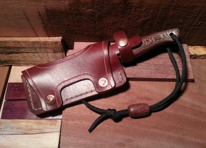

Finished knife and sheath.
Knife and matching lanyard bead.
Other side.
In the sheath.
Other side. You can see how the copper crawls while being peened... The holes were centered well however the bases tended to move... Need more practice with those.
