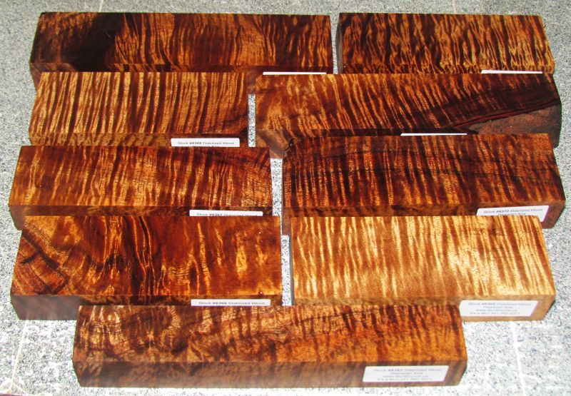

I just added a new batch of stabilized Curly Hawaiian Koa blocks to our web store.

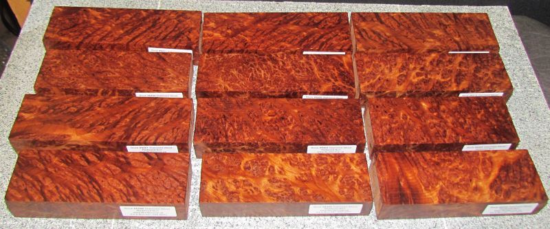

Now I will start adding a couple dozen new blocks of Stabilized Redwood Burl.
Just click on the photo to see what is available.
This is the rest of the new Stabilized Redwood Burl Blocks.

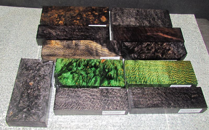

Now I will be getting some dyed & stabilized blocks ready.

Wow Mark, you weren't kidding on that Koa. I don't like to throw around terms like "Exhibition grade", but there are a few pieces in there...
It's almost too nice for me, I'd be afraid to put it on anything but a top shelf knife. If there is still some left after I get paid for my last two finished knives, I'm definitely picking up a block (along with some more silky oak)
I went ahead and picked up a piece of the old growth redwood though. I kicked myself for not grabbing a block last time, and a customer just commissioned a 2pc paring/chef set in "the nicest redwood burl I could find", so I couldn't pass this up.

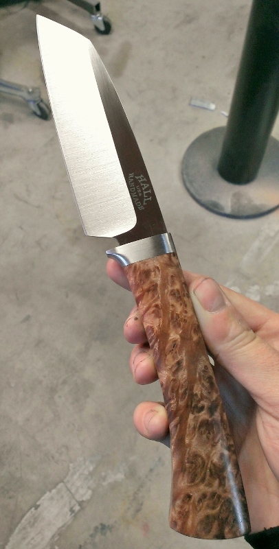

That last piece I got from you came out quite nicely:

Thank you for posting the photo. The knife turned out great.
Some of the guys have difficulty finishing redwood burl but you did great.
Any tips for the other guys?

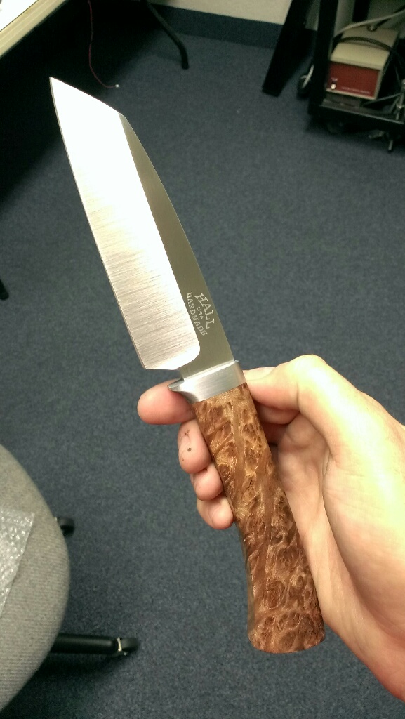

This pic was the closest I could find to really show off how nice that Redwood is.
Edit: It's really hard to describe the grain on this old growth Redwood that Mark has. It's almost like rivers of shimmering liquid redwood flowing between the burls, like you expect it to pour off the knife.
If I had the money I'd buy every single piece, just to have (well not every single piece like a total jerk, but probably quite a few).
I definitely don't mind sharing my finishing technique, it seems to work pretty well for me. Sometimes I have to throw in other grits, depends on material workability.
I usually start with torn strips of 220 from my 6x48. It has stiffer backing and more open grit than the same belt in 2x72, so I find that it cuts like 100 grit but finishes finer. The stiff backing seems to help with forming accurate curves.
Then I move to torn strips from the center of a used 320 belt, then move up to 400 for satin, and 600 for semi gloss.
Once I'm done with sanding, I use a clean buff to lightly burnish and remove and bits of dust from pores/small voids. I stay away from compounds because they leave deposits.
After that I finish with a couple of hand buffed coats of finishing wax, which the Redwood seems to absolutely love.
