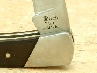

Shecky, what is a galled tang or galled backspring? I simply want to make my 110 glass smooth all the way through. It is smooth for most of the travel but then it seems like the blade catches some friction somewhere along the way.
I have cleaned it and cleaned it wd40ed it then cleaned it again but it's still not as smooth as other 110's I have.

Galling is the kind of wear that's induced when the surfaces are rubbing together too vigorously, or the surfaces are roughly finished, or too soft. Or any combination. The result is excessive, accelerated wear, and often a "gritty" feeling. I've had it occur when things like the backspring is roughly finished, or where the tang is rounded off in profile, such that it makes contact with the backspring with a smaller section of the tang. It seems to happen more often with half stops, possibly because of the small tang contact with the backspring.
Polished tang/backsprings seem to suffer less from this condition, as does harder steels and lightly tensioned backsprings.
Shecky, thanks for that...it sounds like that is my problem as the knife is clean as can be. "Gritty" is the best word to describe it. How does the graphite idea sound? Can graphite be used as lubricant?

Your 110 might not have the extensive wear that is galling. It may simply be a manufacturing anomaly. And it may not even originate on the tang/backspring/lockbar mating surfaces. Is it still gritty if you hold the lockbar open while swinging the blade? Really, the best solution may be learning to live with it.
If you can't, and want it to be as smooth as possible, and you are unwilling/unable to disassemble the knife to smooth out those surfaces manually, you might try what I tried on a couple knives that developed this problem. But be warned, this method can be potentially destructive. I lapped the joints against each other with a mixture of mineral oil and powdered abrasive - some volcano dust. No kidding. Stuff that a friend gave me when Mt St. Helens erupted. If there are no local volcanoes in your neighborhood, an alternative such as scouring powder may suffice. Ideally a real metal lapping compound might be best. I mixed the abrasive and oil, put a tiny drop on the tang, and worked the blade open and closed few dozen times. This actually seemed to work, wearing down the rough surfaces into smoothness. Clean out the joint VERY WELL! You don't want any foreign matter left behind. Then clean it again. All the oil and abrasive needs to be removed. Use solvent. Then use soap and water. Over and over. A warning again: when you're lapping the blade against the backspring, the abrasive mixture will not stay on the tang, but will seep between the blade and liner and into the pivot. Thus it is very important to make sure it's cleaned out very well. If not, the abrasive will continue to wear on the blade joint, pivot and liners every time you use it, possibly causing shorter lifespan of the knife. USE THIS METHOD AT YOUR OWN RISK!
