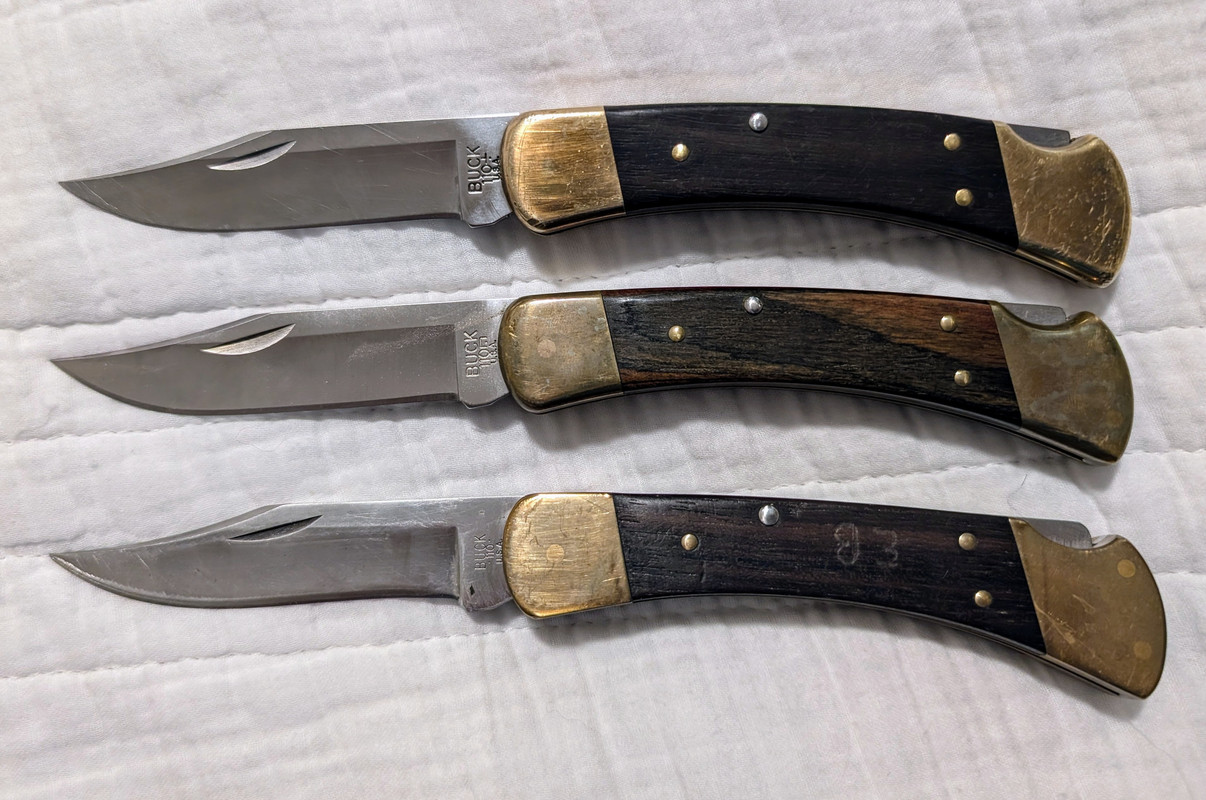

Old thread but I have been sharpening my three buck 110's (1978,2016,2021) using 30 for years since jhubbard recommended it with great success.
