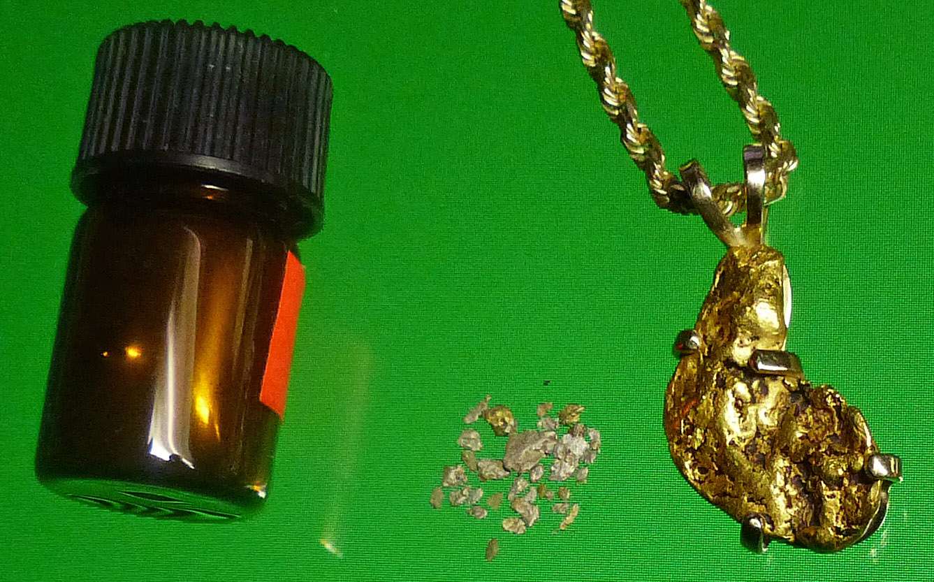

Vial of mercury, gold nugget on necklace and mercury covered gold flakes (gold from Illinois River Valley in Southern Oregon, sold most of it when price hit around $2k/oz, wife wore necklass while in Post Falls so some of you saw it, kept mercury gold because gold buyer wouldn't recognize it as gold):
Gold looks pretty on a green background. I've seen it thru clear clean cold water as it lay upon smooth green serpentine bedrock, just waiting to be picked up by me, with the Summer sunlight filtering thru the trees lining the banks of the swiftly moving remote stream. Very pretty.

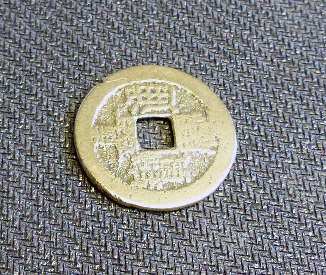

Thank you sit. The hawkbill is in a place of honor on display. You find stuff while mining. Often it is old mining gear, pick heads, metal pans and such. Here is a Chinese coin found by another fellow from the mining group but not me but I cleaned it up for the photos (thought that I had lost it years ago):
