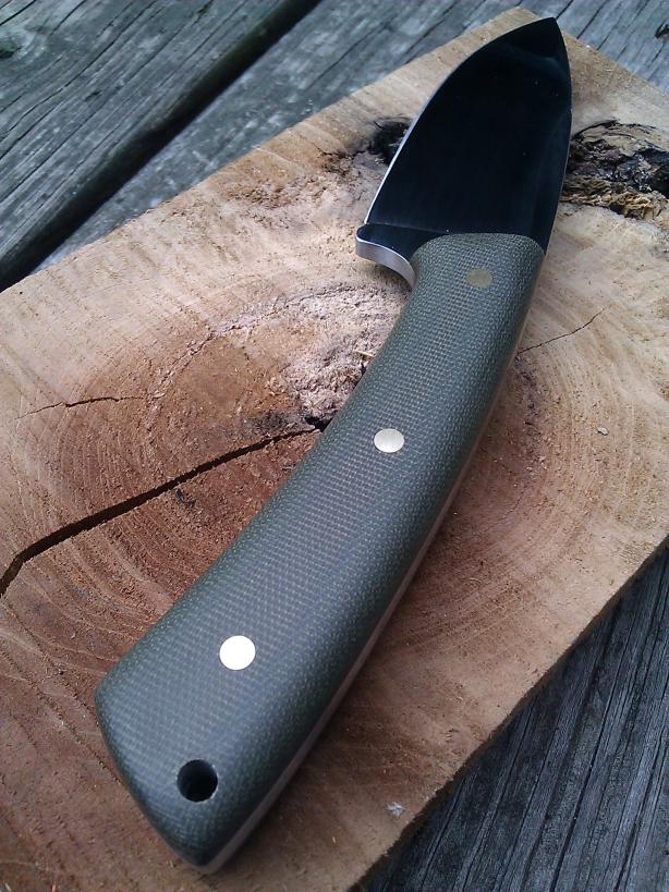

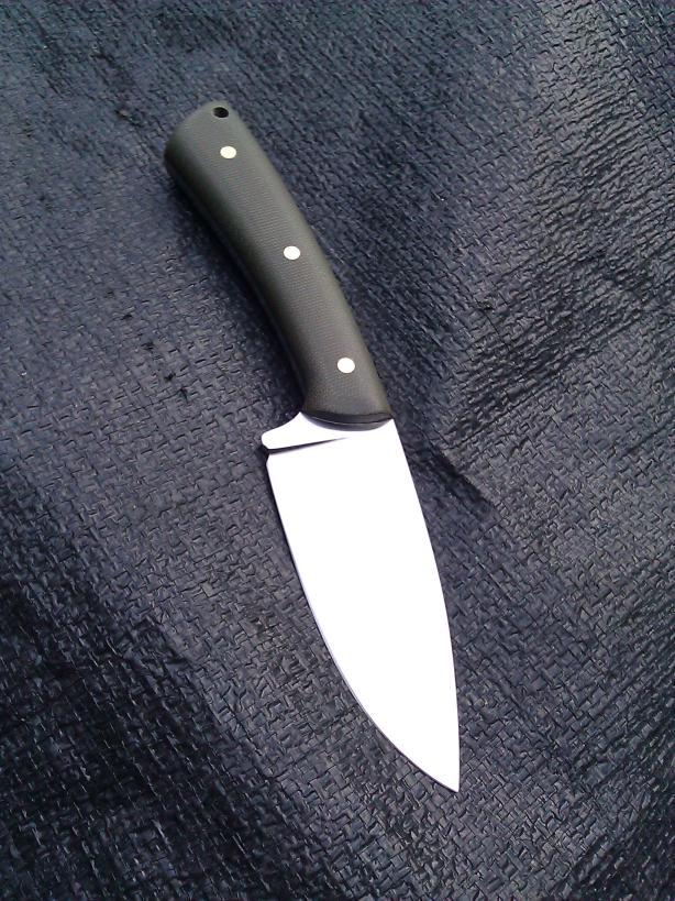

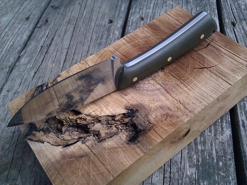

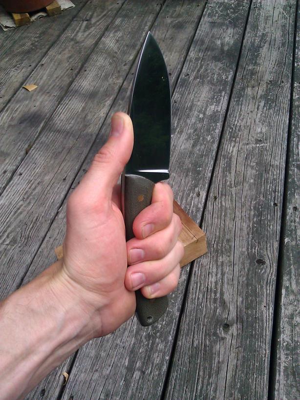

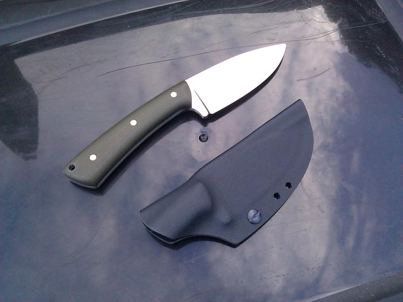

This is the third full-size Mountain Knife in the series.
blade: 3/16" O1, nominal 4" (3.9" actual) length @1000 grit
OD green micarta scales with 3/16" brass pins at 360grit
Oven foil & oil heat treat, triple tempered

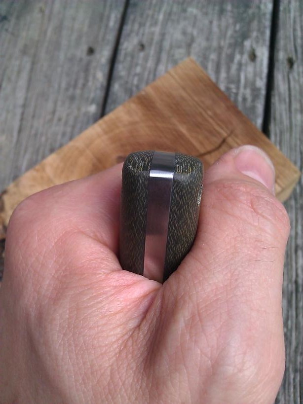

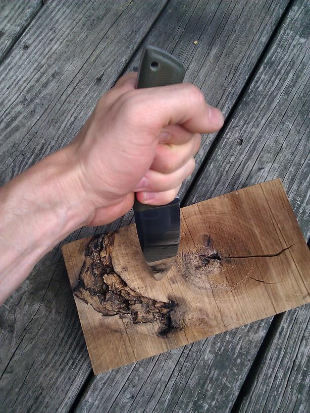

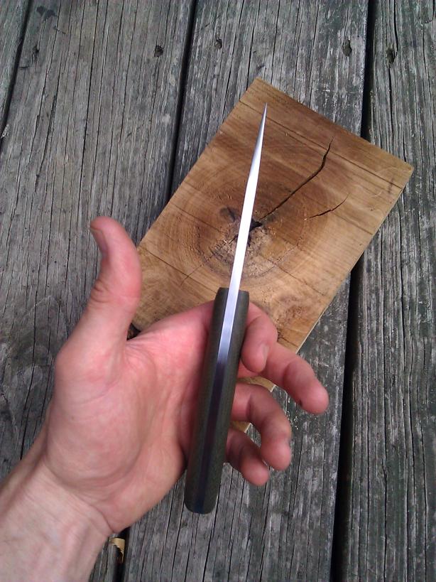

The pommel is ever so slightly crowned in case a little whacking or chiseling (on/with wood, please) needs to be done.

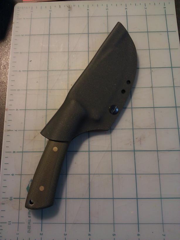

Sheath is 0.09" kydex with large and small tek-lok compatible holes.
My grail version of this knife would have a tapered tang, but that looks like such a headache to jig up for scales...
Thanks for looking.
-Daizee

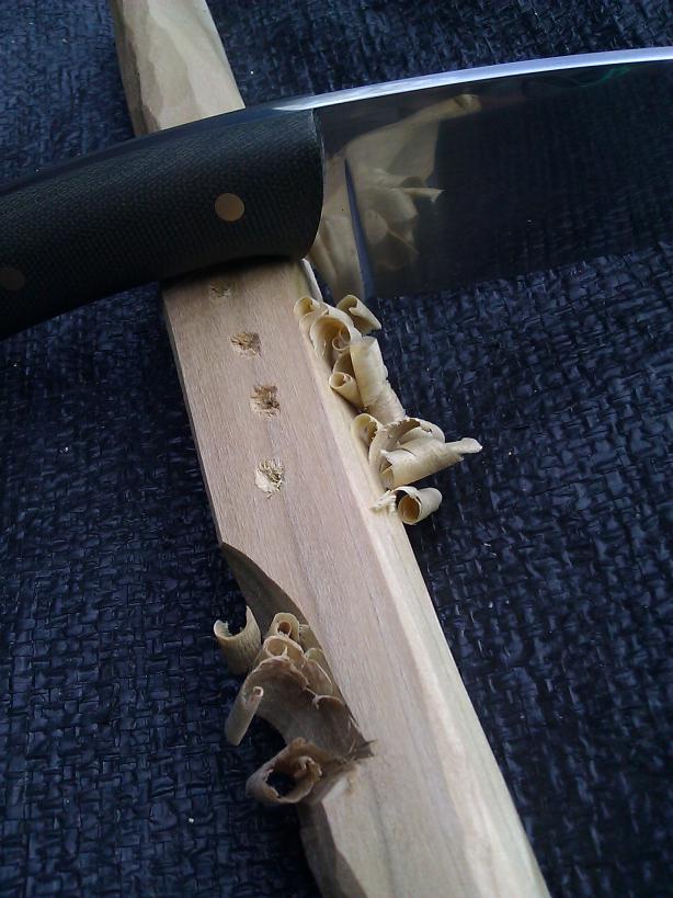

Thanks, fellas, glad you like it. I've been wanting to make these blades since the start.
Hopefully it will live up to its promise... I'll know soon enough.
-Daizee
Really nice. Looks like it can take it and dish it out, perfect size for small and bigger chores.
