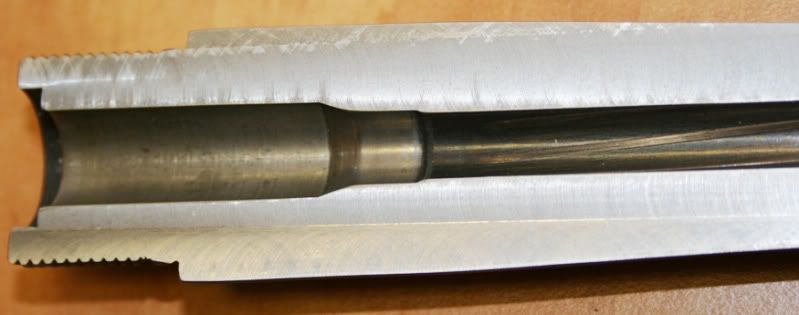

Some cool info from Canadian Precision rifle builder
We got this barrel in a few days ago as part of a rebarreling job and thought it might make a good example of what exactly happens to a barrel when it is past its useful service life.
Note the rifling is completely eaten away for about a quarter inch ahead of the neck and the steel is blackened and crispy. :eek:
This was an OEM factory barrel. Note the rough chamber and visible tooling marks from what was obviously a dull reamer. Also note how rounded the corners are on the shoulder transition from body to shoulder and shoulder to neck.
Here we see a closeup of the same chamber as above (top) compared to a custom, hand polished match chamber (bottom) cut with a new, sharp reamer. The chamber walls are bright and shiny with no tooling marks and the transitions from body to shoulder and shoulder to neck are sharp, not rounded.
