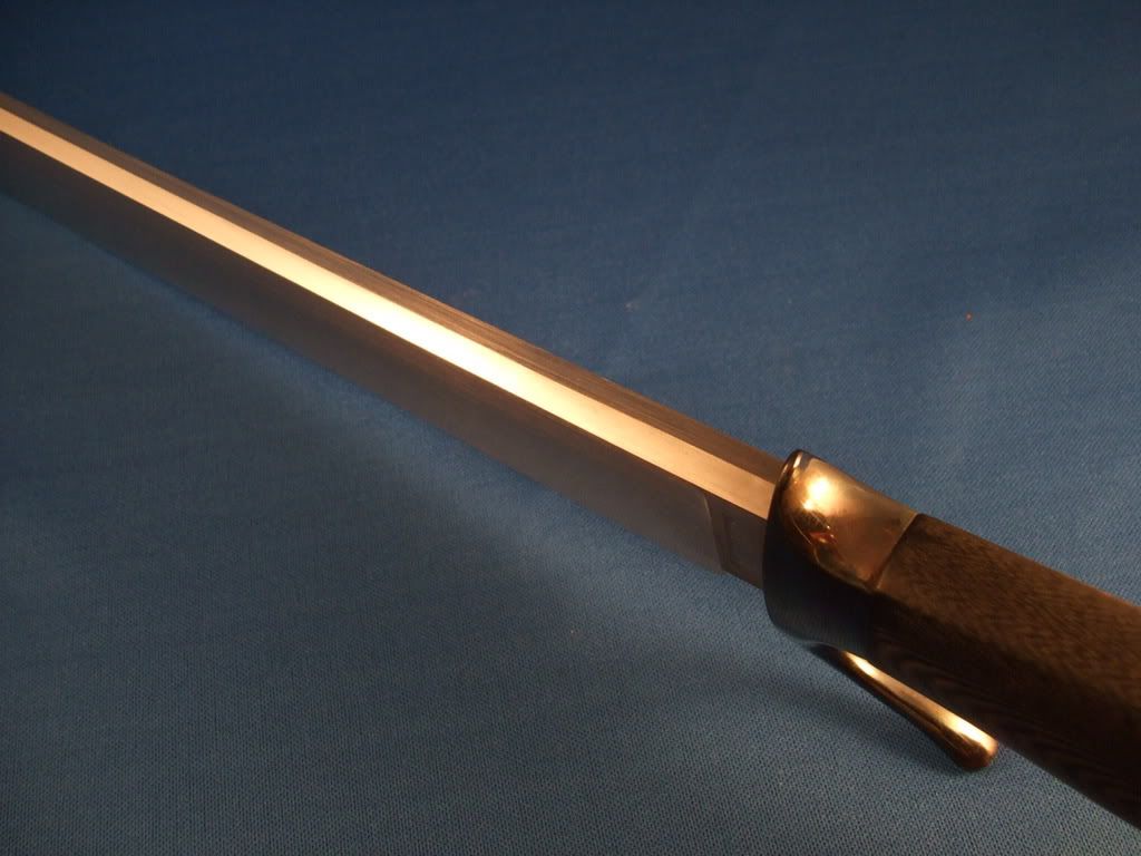

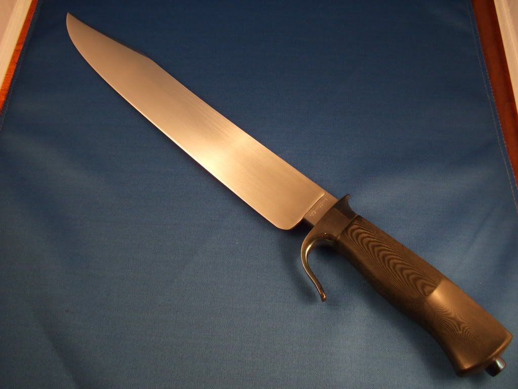

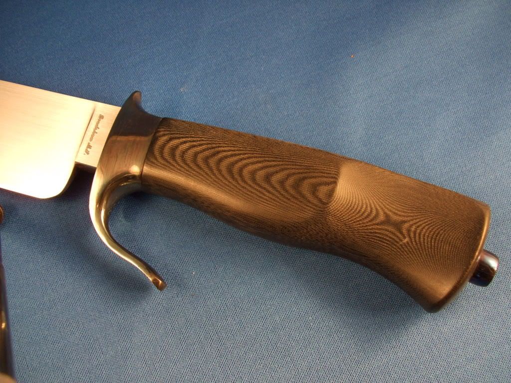

This is a big ol bowie. 12" forged cpm3v blade, hand rubbed to 320 grit .340" thick at spine. Hardness is Rc 59-60. The spine of the blade is ground with a ridge.
The guard and finial are mild steel, carbona blued. If a nick or scratch gets on the guard, simply pop it in the oven at 800 and it will recolor.
The handle is black canvas micarta. It is a take down constructed knife.
This one is a serious user. It cuts like a laser and due to it's length and weight, it does so with little effort. Since it is intended to be a user, the blade finish and blueing ont he fittings is easy to maintain and refresh if needed. CPM3V makes one hell of a tough knife too.
