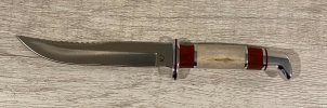

I had a 1997 model that measured in at 0.08". Buck discontinued the 121 in the catalog after 2000. I believe that Buck then offered the 121 as a custom between 2001 and 2005. I think Buck thickened the blade to 0.12" when they offered it as a custom and in the 2012 and 2013 Boone and Crockett models.Not sure where I got these measurements from...
4 spacer, tip down, measured at the tang stamp - .0583"
4 spacer, tip up, measured at the tang stamp - .0770"
3 spacer, 3 line, measured at the tang stamp - .0776"
2005 121, measured at the tang stamp - .121"
Feel free to measure and correct any and or all of the above.
